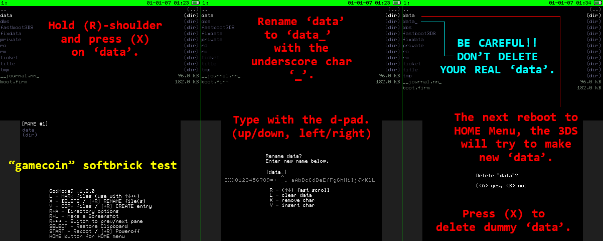

The use of Decrypt9WIP's CTRTransfer is destructive (ie, loss of HWCAL0.DAt, HWCAL1.DAt, erased user profile's data folder, several console unique *.db files).
If the built-in GodMode9's CTRTransfer doesn't resolve your issue, try CTRTransfer (Type D9).
:!: There is one CTRNAND softbrick that neither GodMode9 and Type D9 varieties will fix. Dubbed "gamecoin" brick, this requires manual debugging.

Got these 4 files you asked me to rename deleted for no reason, and I can't boot my 3ds even with another CTRTransfer
When you unbricked your o3DSXL, did you first used Decrypt9WIP CTRTransfer and followed by using GodMode9 second?
Do you recalled GodMode9 asking you to backup the essential.exefs?
If you used Decrypt9WIP CTRTransfer before GodMode9, you may have inadvertently/permanently erased those o3DSXL's original NAND files as GodMode9 would have backed up dummy copies found in the CTRTransfer donor image.
What do those files look like in essential.exefs?
Do any of them look like bunch of zeros (00 00 00)?
Do you still have access to GodMode9?
  • Good copies of the HWCAL0.DAt and HWCAL1.DAt are supposed to have "CCAL" as the header magic.
  • The SecureInfo_A or _B should have your o3DSXL's serial number (XX########).
  • LocalFriendCodeSeed_B should match the copy found in SecureInfo_A|B movable.sed as seen in the diagram.
Try clearing the RAM with the battery trick if your o3DSXL automatically boots with an ARM9 or ARM11 error.

If the o3DSXL still crashes, you'll need to test for softbrick caused by a "gamecoin"-type bug. Do this by temporarily renaming the folder,
  • [1:] SYSNAND CTRNAND/data[1:] SYSNAND CTRNAND/data_
If this bug is in the real data_ folder, the o3DSXL should successfully boot and try to create a new user profile on the dummy data like this.

o3DS XL still crashes after renaming data folder in SYSNAND CTRNAND
movable.sed: unique, no problem
Not borrowed from the o3DS, right?
Okay, that means you don't have "gamecoin" brick.
Did you already try the Fix CMACs for drive?
