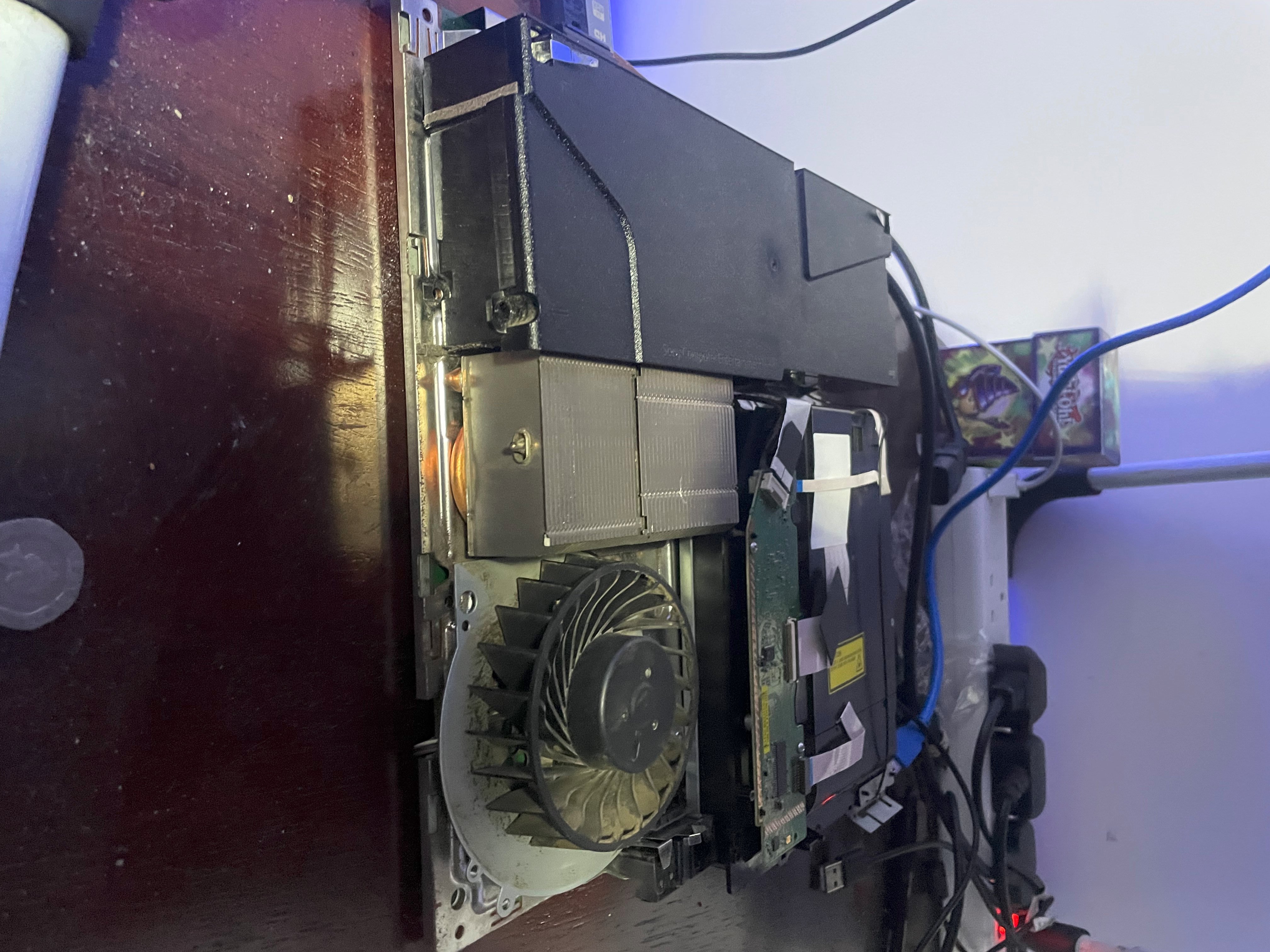

UPDATE: I have fully tore down the PS4, cleaned the motherboard of dust, along with the other components.
I have made a basic mounting plate by using the two metal plates that were inside the PS4 casing, I have mounted the PSU to it and reconnected the disc drive and fan, though the disc drive and fan mounted originally to the middle plastic tray so I'm working on a way of mounting it, currently I am thinking of using long screws with nuts to hold the parts in place and to add slight clearance between the mounting plate and the case i will eventually place it in.
I have tested and it currently boots with no issues apart from the original fan not spinning up but i believe the metal connector has slightly bent so hopefully a quick fix.
Attached is a photo of how it currently looks as of now.
(EDIT: The issue with the fan was a mistake on my part, it seems i did not connect the fan to the port on the board properly so it came back out, I have tested it and it can run Cyberpunk 2077 and Overwatch from the hard drive, I'm in the process of finding a case so if anyone has any recommendations on a case Im happy to hear them)
