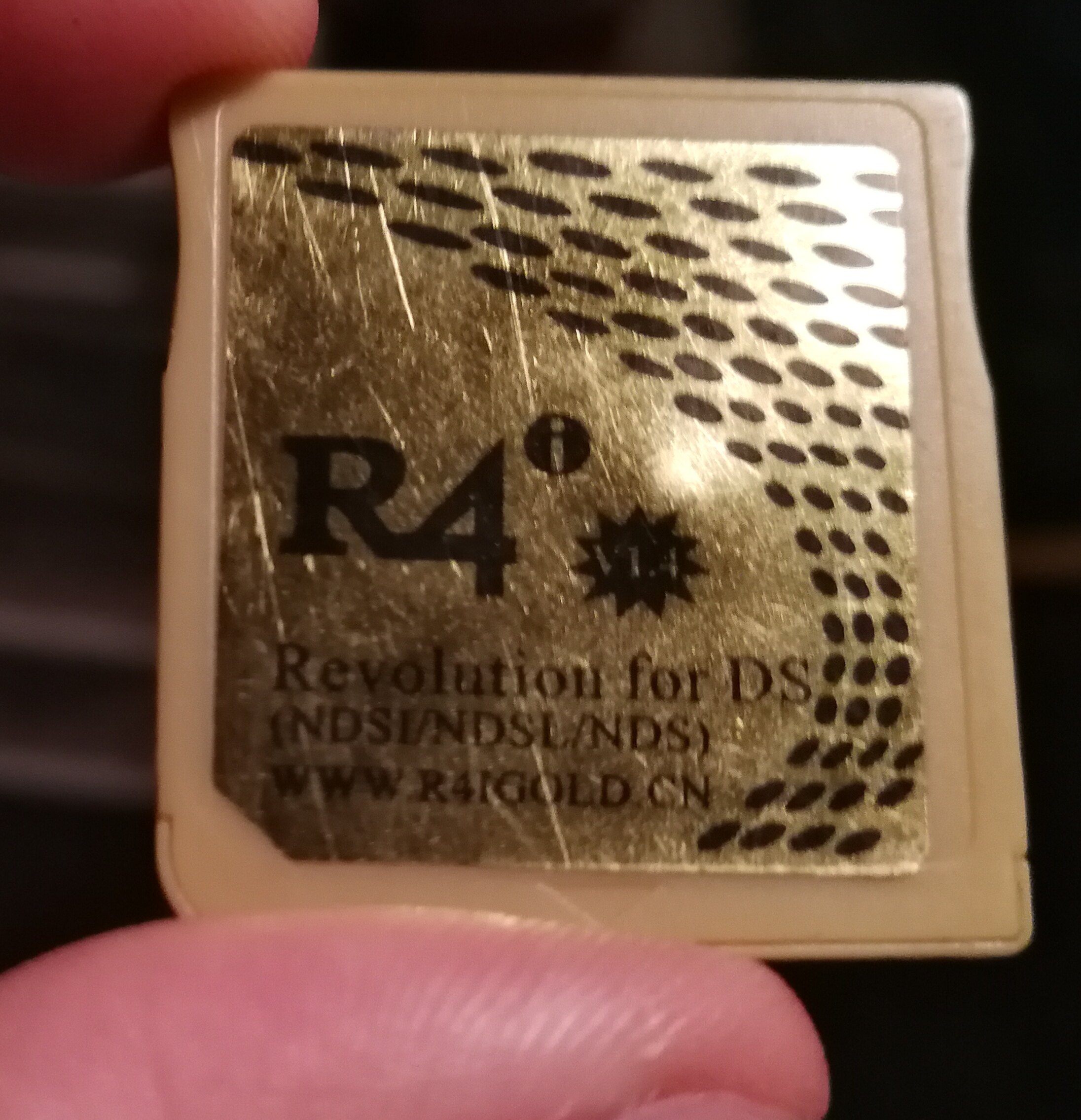

I have R4i SDHC should i wait for compatibility or order r4i gold and if so where could i order it i heard nds-card but its from china and delivery will take ages
