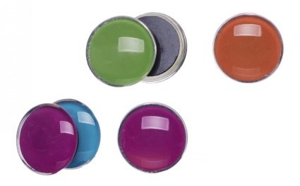

I seem to be facing a problem with trying to get NTRboot to trigger on my New 3DS XL which is bricked due to updating while on 2.1. I flashed my Acekard 2i to ntrboothax by using my DS Lite and I've put all the correct files needed on my 3DS's SD. However when I place the magnet on my 3DS and press "Power", "Start", "Select" and "X" I get nothing, I also have the Black Screen of Death so I can't properly tell where to position my magnet to trigger sleep mode. I hope I explained my problem well enough for you guys to understand and any help would be great! Thanks.
These are the magnets I'm using as well

Yeah, definitely need a stronger magnet then. I tried a load of fridge magents and none of them worked, they are too weak. You could try putting a speaker next to it, but be careful you don't want to be wiping flash chips etc. A video I saw had a guy putting a really big magnet next to his 3DS, but it wasn't on or above the diamond buttons, it was like sat next to the 3DS on the desk, maybe a couple of inches away

yeah, you definitely don't want to get a magnet that's to strong, but you don't want to get one that's to weak:rofl2:
