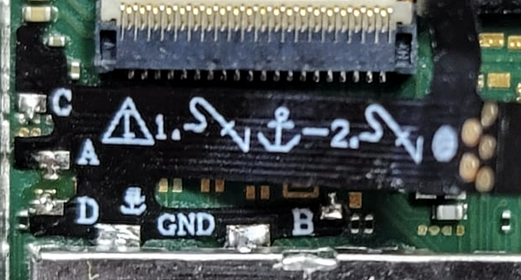

On the lite if you don't install the nand ribbon cable correctly it can short to display which it's the hardest one to do outside of oled installs.
Basically the nand solder points are very close to other points in the board underneath the ribbon you don't want to cross connect.
The v1 switch is extremely easy to install so that's a weird issue.
Sounds like this is your first time installing both of these and I wouldn't recommend anyone doing a lite without micro soldering experience and a good soldering iron with temperature control
But yes pictures would help
here are multiple examples on how the soldering job should look in advance
if your short here to here
your gonna have afun time

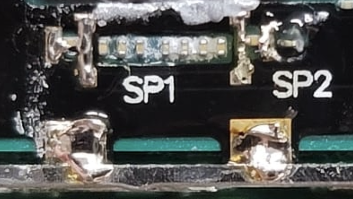

You show me some of the jankiest soldering I have see in a while
Then say you sell pre mods
You said the first few were fine that's just luck you have been timebombing the entire time from those pictures
Cmon bro
What the fuck is this shit I'm guessing you don't show people your soldering beforehand
This is the kind of shit I got sent to repair back when I could still do installs before Nintendo cease and desisted me
Like seriously what are you using to solder some generic £5 eBay special or a butter knife and a lighter.
Doesn't matter if you have ESD tools most things are esd and your not directly touching any components anyhow
The only thing that's touching such things is your soldering iron which should have appropriate tip sizes and temperature control that is set correctly.
Usually in the 320-340c range with a small tip and good quality solder.
No including the fact it clearly looks like you have not used flux a single time here
When you do installs you do them properly regardless of who it is and extra attention if it's a favour because your the go-to guy now if it ever has issues down the line.
You desolder both the v1 and the lite , if the display works you can try again if you better be paying out switches

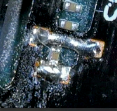

Before you wanna be a dick, I'm using Flux and a Weller soldering station OR a pinecil depending. If you aren't gonna be helpful, fuck off. Not my fault you're Butthurt over your c&d.
Says "janky" but then has this posted like all the solder is better and not even fused to the shield.

I agree with @izy on this one, your soldering suck @P4RI4H .
Soldering isn't the issue or else my failure rate would be higher than 2 out of ~40. The soldering is fine and unless youre s-tier, i dont want to hear that when its not the problem. And that's VERY constructive and conducive to the question at hand. What a great atmosphere we have here where someone asks for help and they get shit on and told "git gud".
Seriously terrible soldering, you can't solder, looks like you used no flux.

Lmao solid but looks like a chicken nugget couldn't even flow that shit properly
Solid enough your killing 2 displays and ask for help without trying to fully desolder then to see if problems persist beforehand
and i would know because i've repaired this kinda shit
never had to use so much flux in my life
also all your bank account agrees to is people to your scuffed installs who knows how long they last down the line.
I bet your rates are expensive aswell
also 40 installs is a cute amount in 2 and half years since the modchips came out,
thats about as much as i had in 1 month done during my escapades but like i digress nintendos cease and desisted 3 months later.

are those pics low qually or is that dirt on the board....
no thats how much solder was used on the nand flex i repaired literal ic's full submerged
and the brown gunk was the flux which i assume was for plumbing considering how hard to was to remove
heres some more images of it, they part of my cursed installs folder
also for the record this switch fully booted once it was all removed, and even accepted the chip after replaing the flex cables he destroyed
also keep bridging them sp1s
