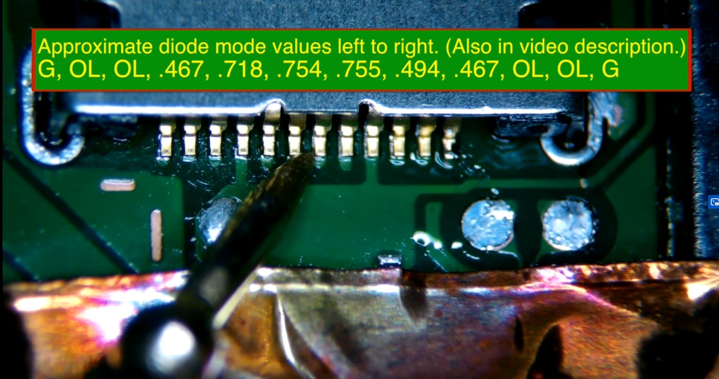

check continuity for the pin of the p13usb and check your usb-c connector because its usually the cause of a failing p13usb chip aside from 3rd party docks
USB-C connector looks fine visually. Not sure exactly how to do the pin continuity check as I would mostly be just checking to see if a trace was blown after the pads. The PI3USB is getting 3.3V btw.
you should find those values checking the pins with a tester on continuity mode.flip the board and also test the 2nd row
