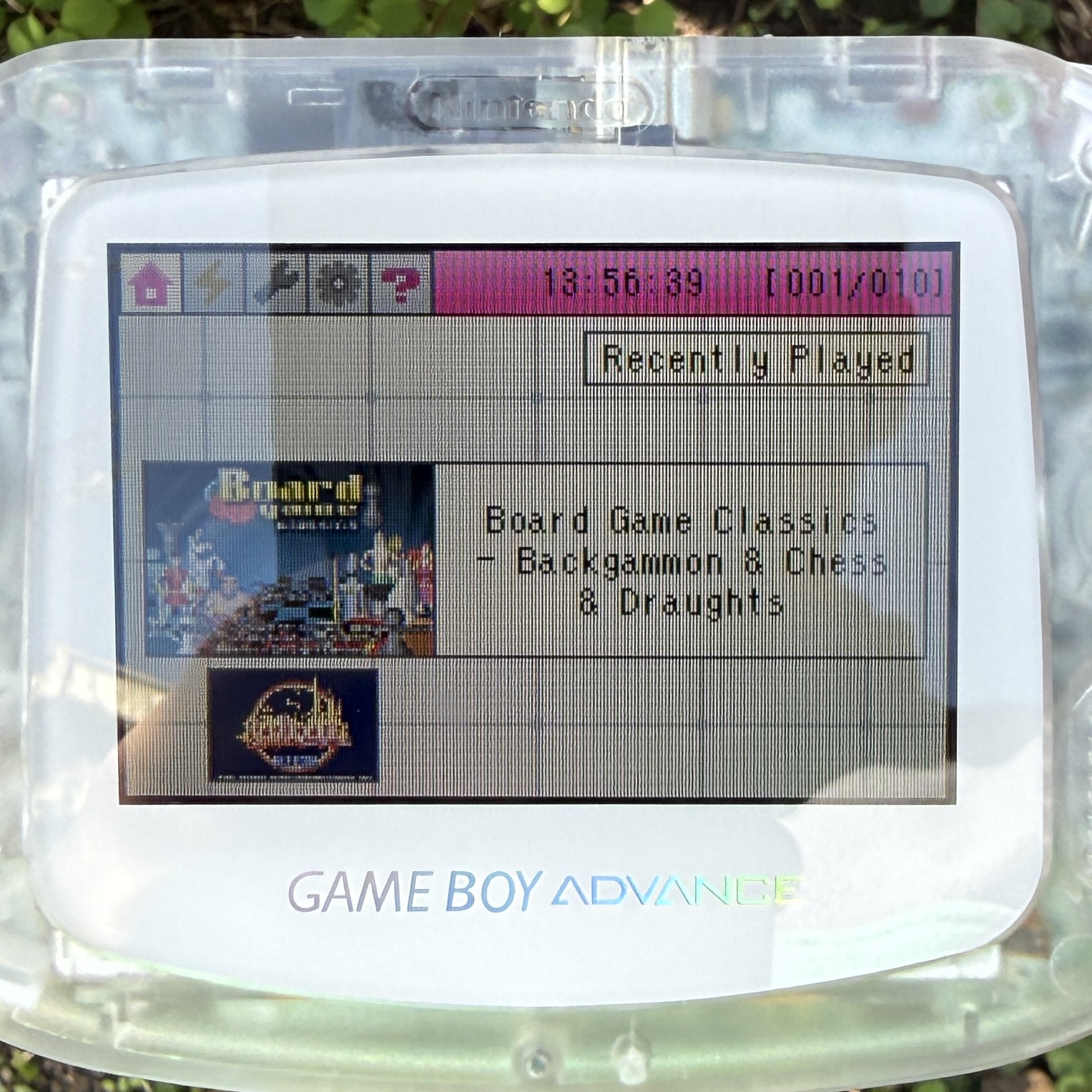

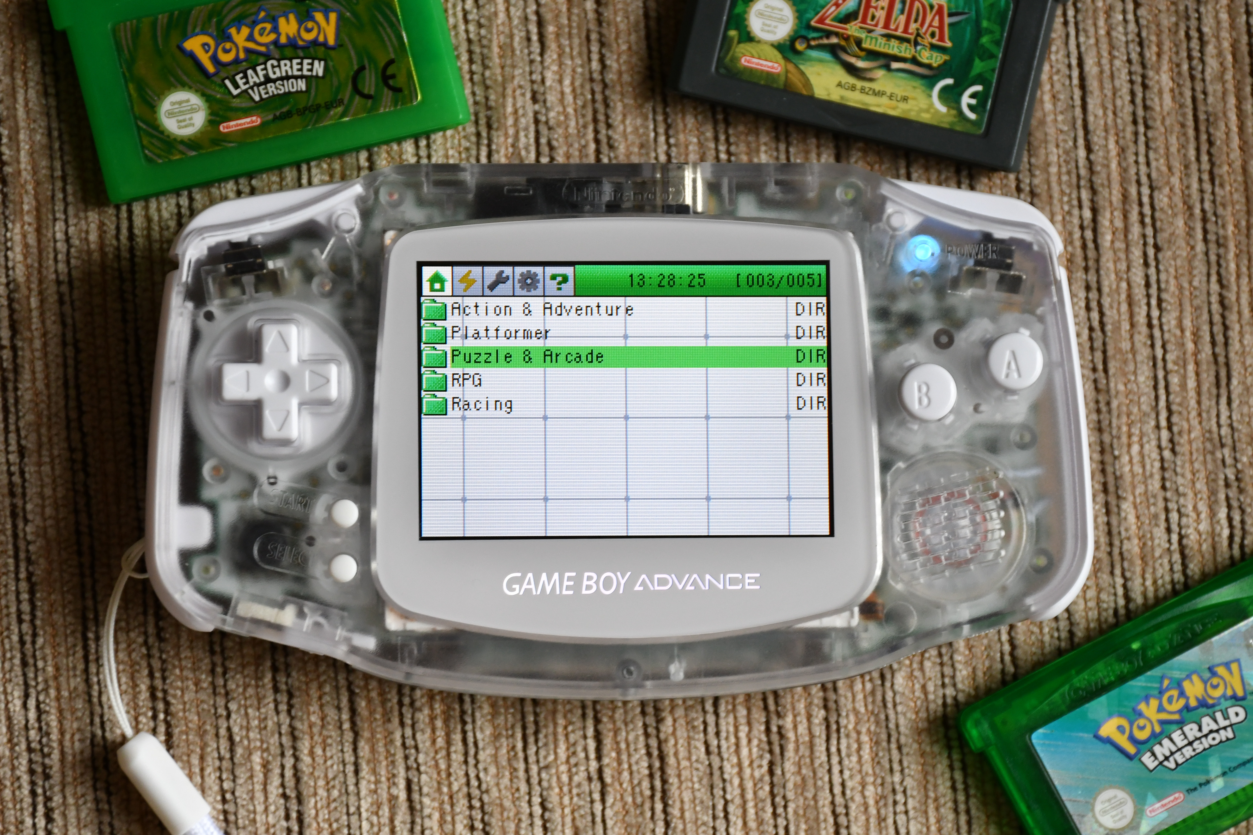

Hi Sterophonick, thank you for all the hard work making this theme.
I used it as a base for my own DS style theme
There's 7 colour options (+ a bonus Yoshi theme), including a dark mode.
Here's a preview:

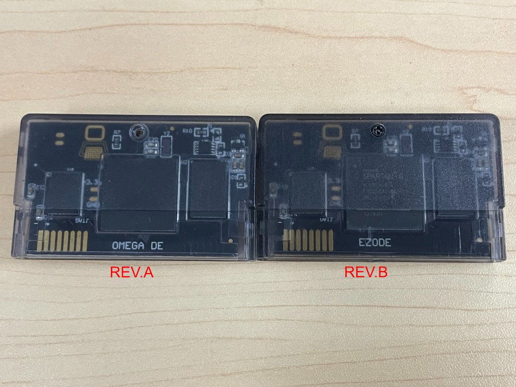

There's a thread here about a brand new model that has B in the title, I don't think anyone has their hands on it yet so nobody knows about the compatibility besides @ezflash2
Latest update on the official site is about a Rev.B, but is from '22. I guess that must be the revision @Trip_Away had?. That thread might be a misunderstanding. edit: looks like it's indeed a new model? I stand corrected. Terrible naming, though.
Reactions: hippy dave
I had a revision B and works perfect.
(I adjunt a image to difference Rev.A from Rev.B)
You're somewhat mistaken on what is meant by "Revision B." They have a new version of the Omega Definitive with 960mbit of NOR and improved NOR management logic. 960 / 8 = 120 MiB of NOR flash, so you can fit a 64MiB movie ROM, an entire copy of Mother 3, and still have 24 MiB left over for whatever else. The improved NOR management logic means you don't have to select the lowest ROM in the list to be able to delete one that's above it, you can delete arbitrary ROMs from your NOR, like any modern filesystem.
