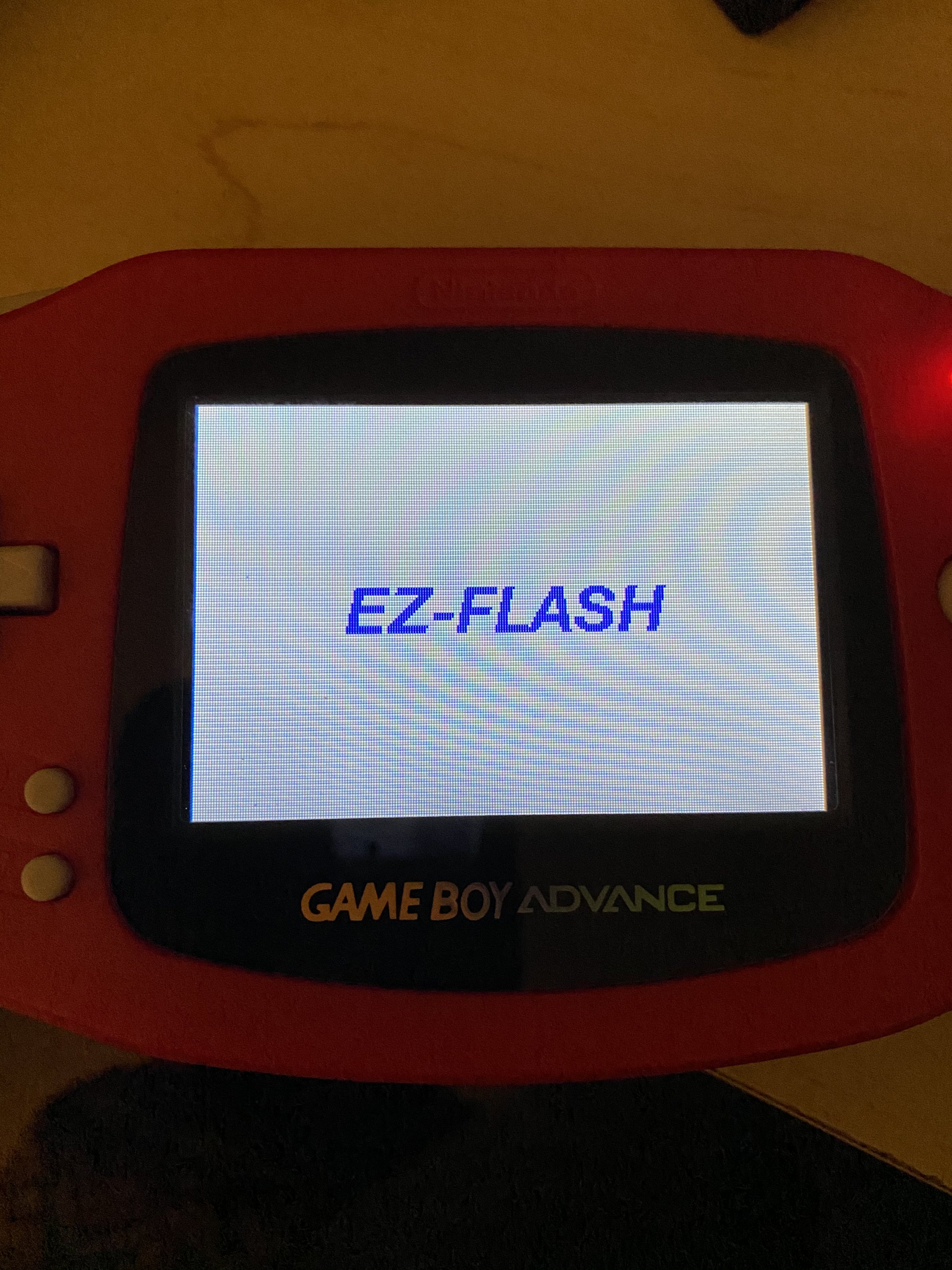

That shouldn't be happening. Could you perhaps send a video or something?
This flashes every 2 seconds. I can turn it off?
i have the "simpleDE.zip" version :)
