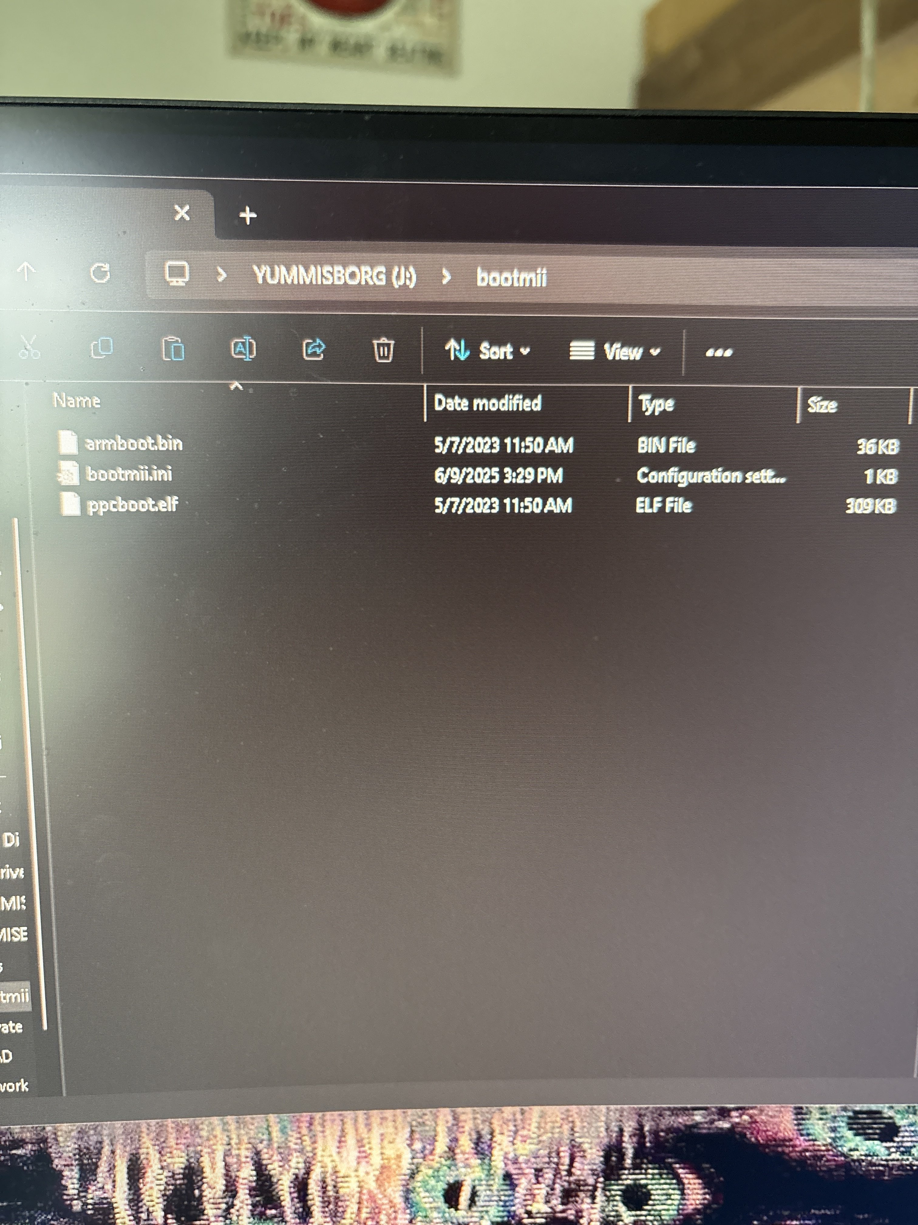

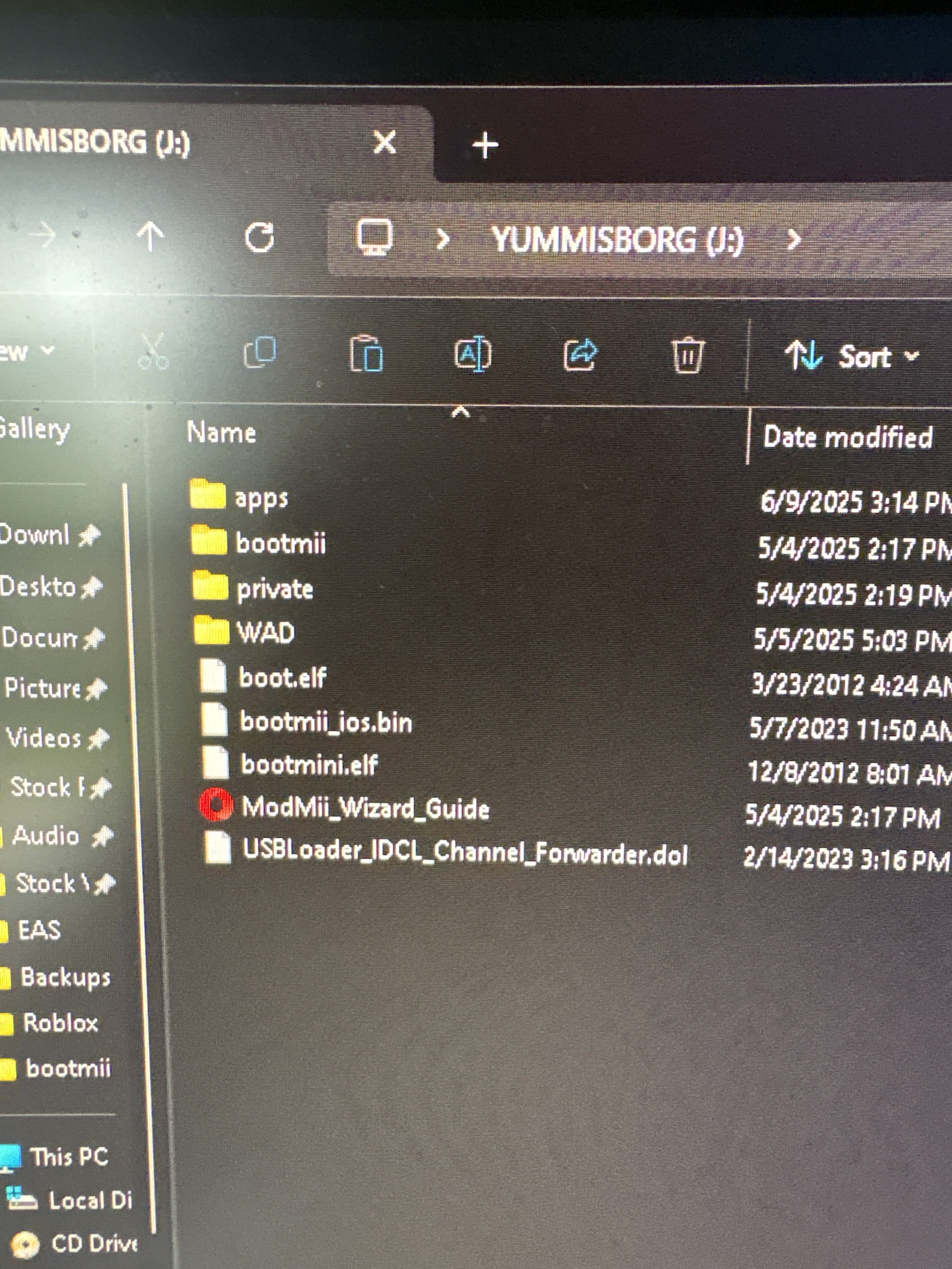

I have put in the files for the sd card using the bat file you mentioned, but bootmii will not boot when I turn on the wii. Do I have the right files?

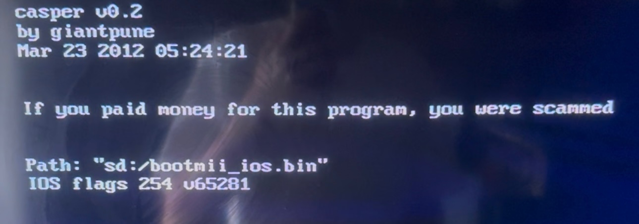

I was able to run Casper through Letterbomb but I got this screen and a few seconds later it resets and nothing changes, which I theorize to be from the ini file used to run Casper.

ANOTHER Update: I actually managed to get into BootMii by retrying multiple times, and it for some reason has like a 20% chance to load at times. When I do manage to get into BootMii, if I use the power/reset buttons or a gamecube controller and go and try to backup my NAND, the Wii resets and I have to try and get into BootMii again. It also resets whenever I click RESET/A on anything.

Do you get an kind of error message or new log saved to sd when you try and backup your nand using bootmii?
If I had to guess, bootmii doesn't like your sd card, so maybe try a dif one, or double check its formatted as fat32 and MBR
