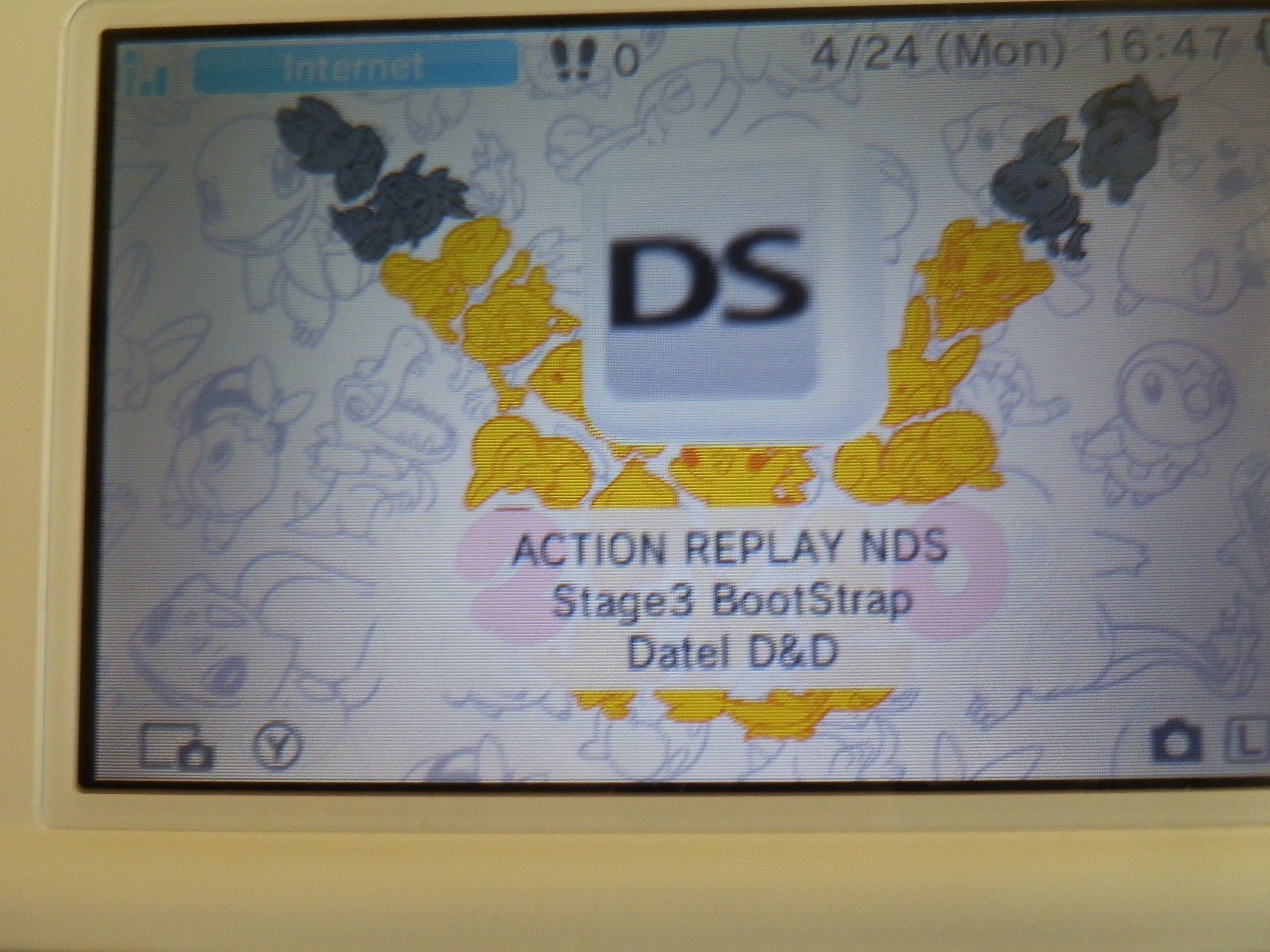

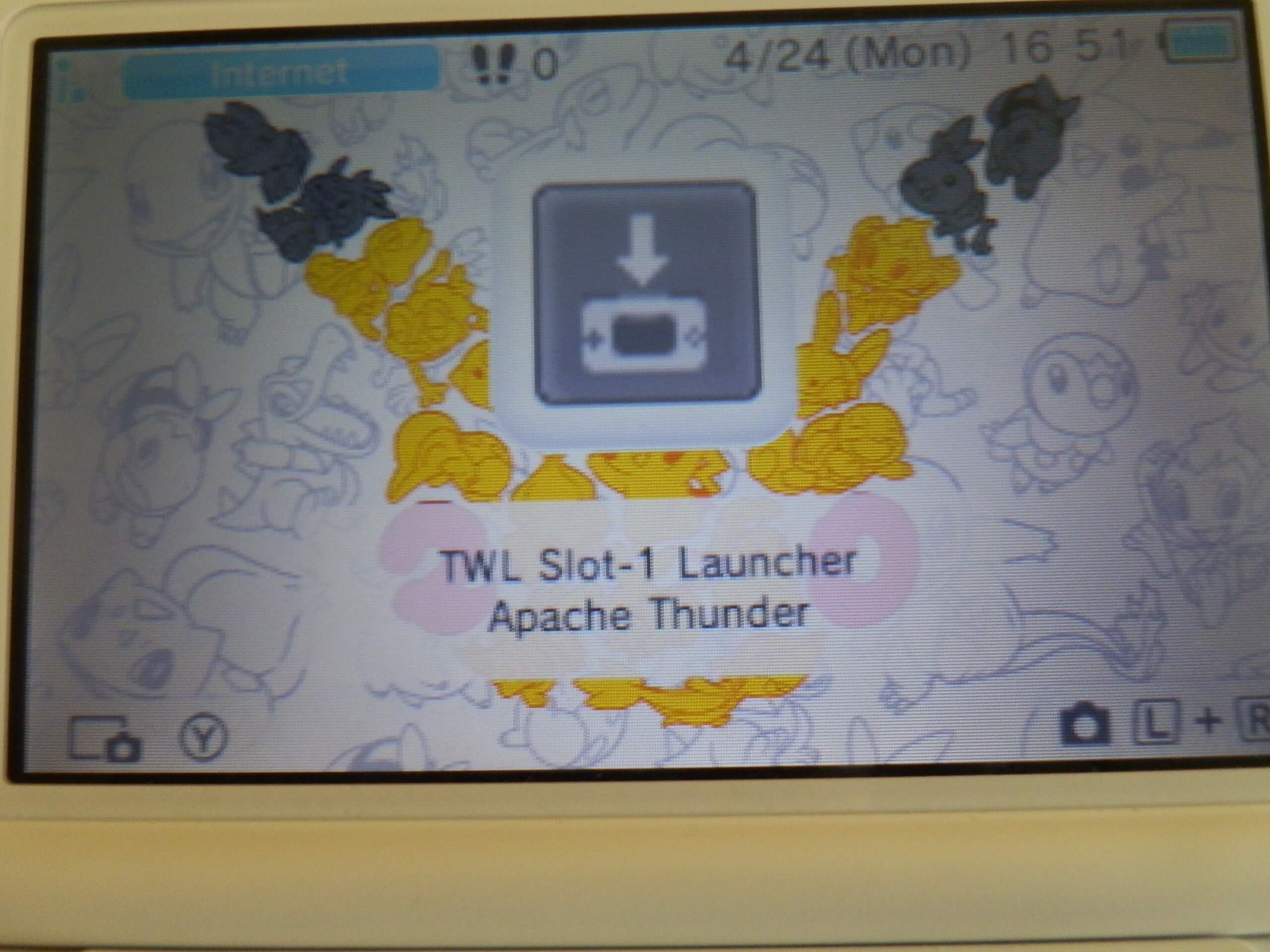

  9. b1uens0w
    b1uens0w Newbie
    Apr 24, 2017
    Here are the pictures that I took in case any one might need to see them.
    shown are all the launchers i've tried using and they all didnt work. I think I might need to patch my TWL_firm? I have no idea how to do that though, I've read it before.

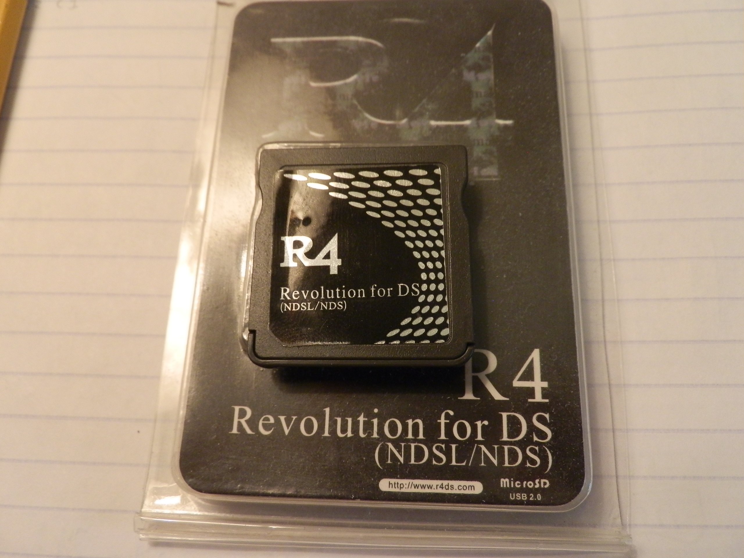

  10. slaphappygamer
    slaphappygamer Frizzle Fry
    4
    Nov 30, 2008
    California
    Oh man, you are trying it all. Have you tried forwarders?
  11. SomecallmeBerto
    SomecallmeBerto The Anti-Hero
    5
    Dec 17, 2014
    USA
    Wow that cart is old. Have you considered upgrading? You could get a new one for less than 20. Sorry if it's not much help as I haven't seen one of these in YEARS.

  15. penchostella
    penchostella Newbie
    Dec 9, 2016
    Argentina
    i'm using that same flashcart with that same app (wood r4)
    i was having the same problem but when i put the flashcart with some cardboard like this video worked just fine
    [​IMG]
    ^^make sure the 3ds recognizes the cartridge like this before run apache thunder's wood r4 app
