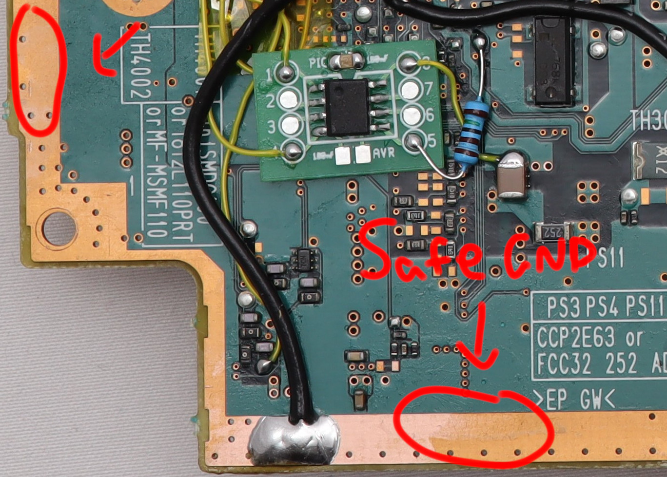

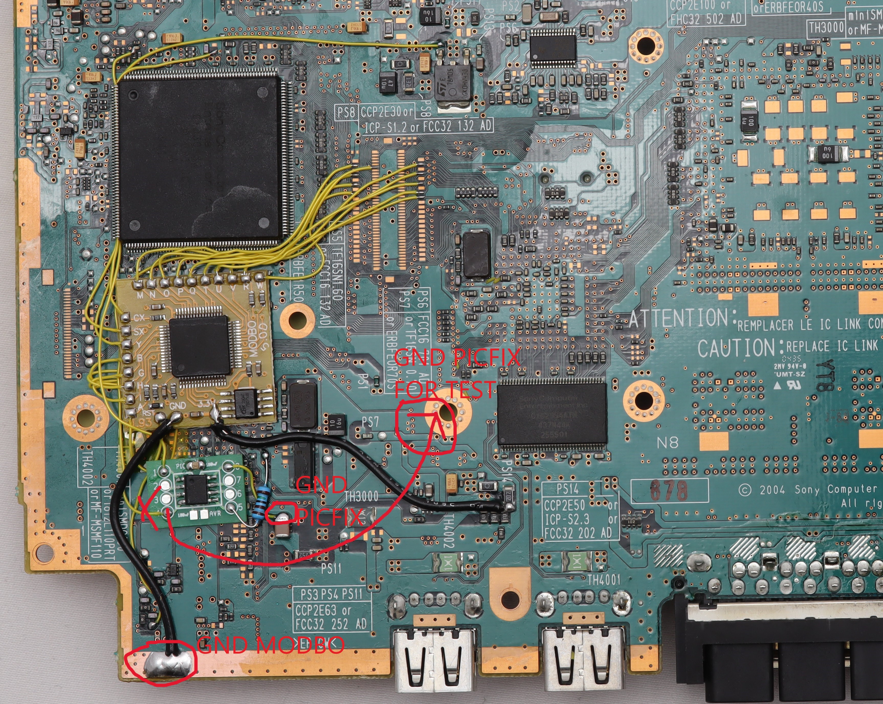

Hello guys im new in the domain, i have documented myself quite a bit about the installation of the modchip but i have a doubt about one thing.. i have read that to test the picfix you need to had to connect the cable of the pin 4 to GND but my question is you need to connect the pin 4 (so the "K" of the picfix PCB) on the GND on the motherboard, or you need to connect the pin 4 to the GND of the picfix PCB ? in a nutshell this is like same the first image or the 2nd ? I thank you by advance for your reply

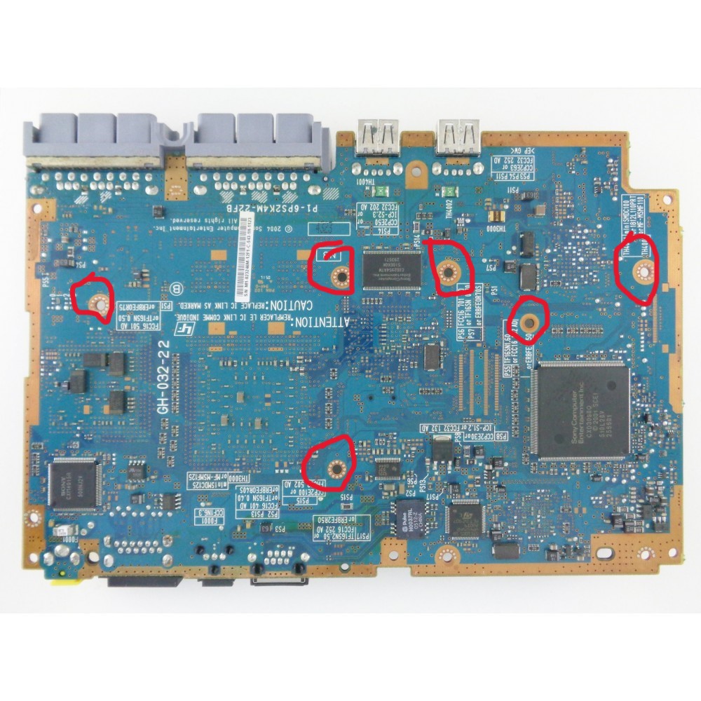

Any safe GND point will do. It is not generally advisable to solder next to the ground mounting holes, as the case would not fit otherwise.

And for the first image if i connect a cable between the point K at GND of the Picfix PCB and the GND of the Picfix to the GND of the motherboard this is also correct too ? (like this)

I did mention these, I wouldn't solder to them because they can block the holes and make the case not fit on. The ground copper zones around the outside are recommended.

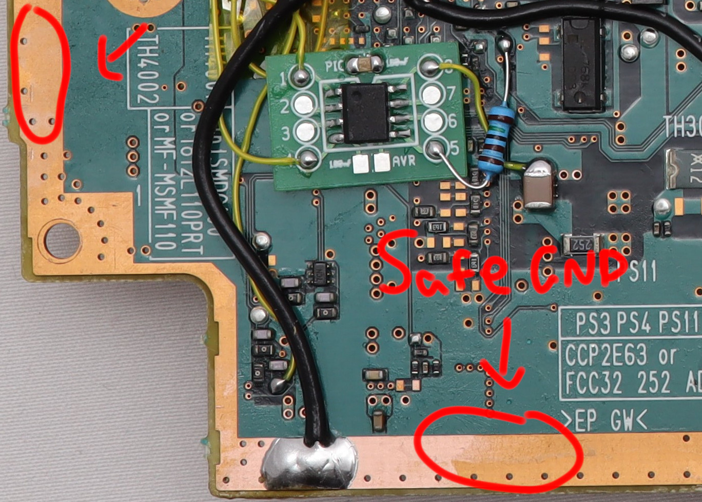

These as highlighed, make sure you don't take away the solder mask as you're soldering to those parts.
Ok i see thank you for this ! but if i solder this two part and i connect 2 cable (for exemple : at the right i solder the cable for the GND of the picfix, and at the bottom i solder the cable for the GND of the Modbo) is there any risk ?

Nope, since you're soldering to ground, there shouldn't be any conflict.

ok that was a question I was asking myself this is for that, so this is not possible that there has a shorted or that there has other issue with two GND connected on the same copper (very sorry if this question is stupid i begining in the domain so i want no take any risk)
