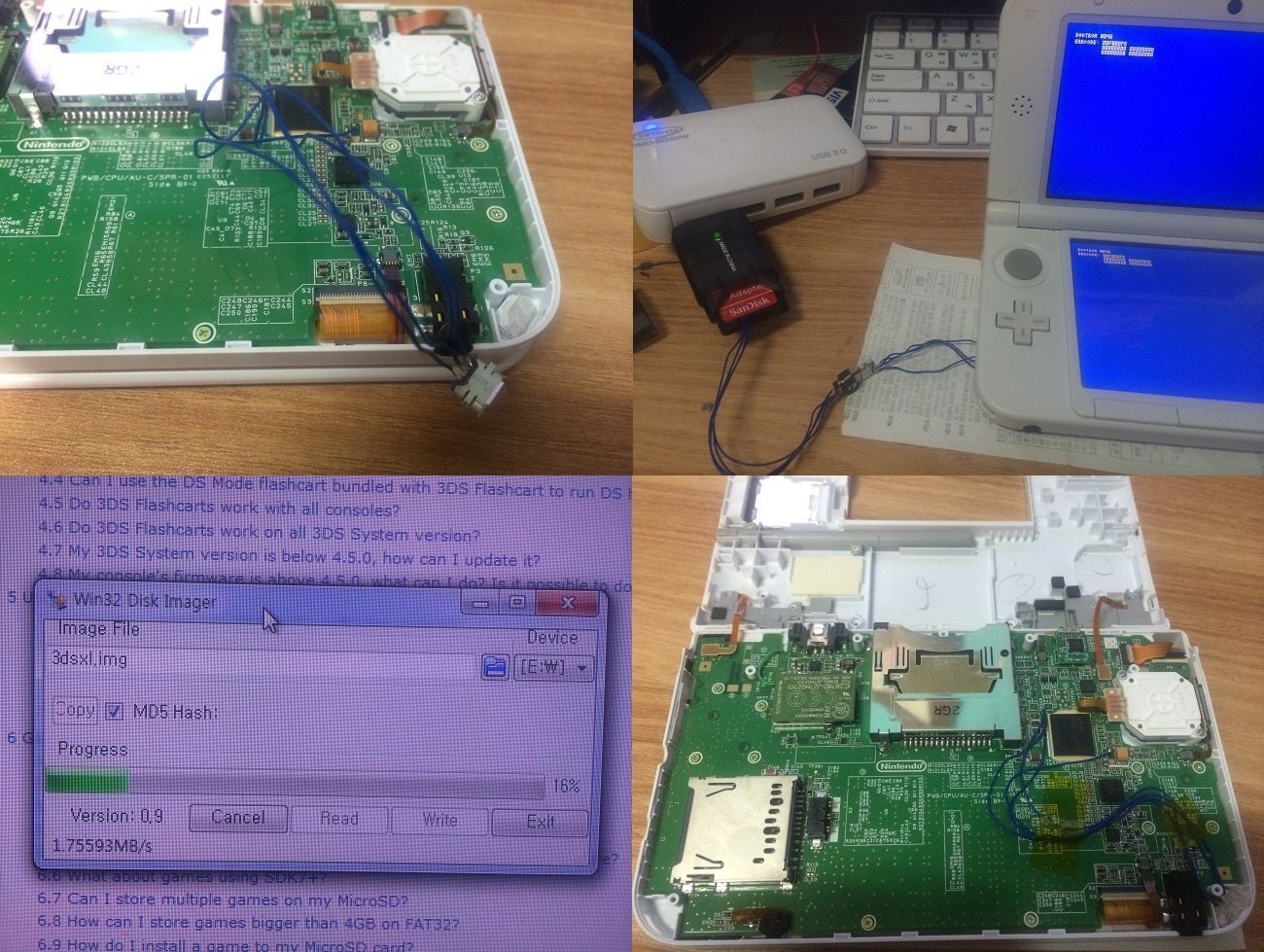

heeeeeelpl
where is exactly the cmd pin in a classic nintendo 3ds?
gw3ds kills my console and I am trying to restore the nand

I did several of this mod so far using the 4 wires micro USB connector and my avg read/write speed are around 5mb/s using only DAT0.
Is it possible to boost read/write speeds by using the other DAT lines?
Thx.
yeah from what i have read it gives around 15-20Mbs iirc with the extra /dat points connected
