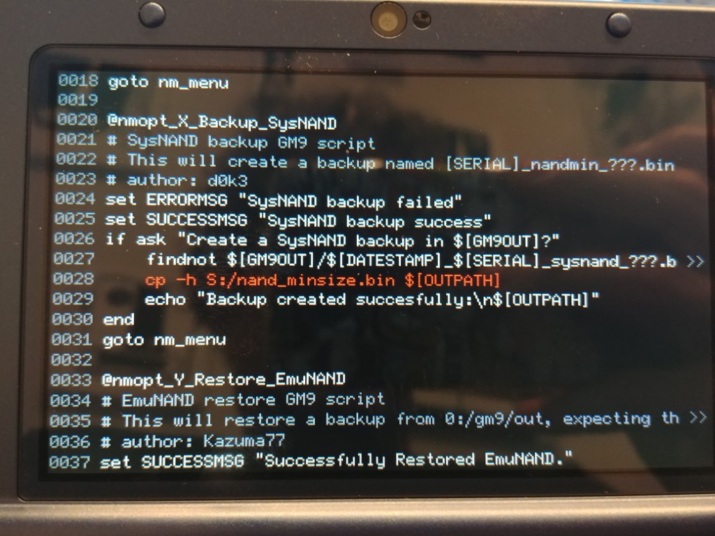

THe problem occured when I tryed to redo a new nand backup
when i launched GOdMode9 it doesn't ask to backup essential files and neither fix RTC date and time.
When I run the backup nadn script it freeze at 0% and I have to brute switch off the console .
If I try to run the nandbacku out of the script I receive the error in the attached photo.
The 3ds can write on the sd card and I have plenty of space for the backup
In the out folder there are 2 backup files with correct name but 0 byte
any idea?

Thats not the error in the photo, thats the script. Whats on the bottom screen?
