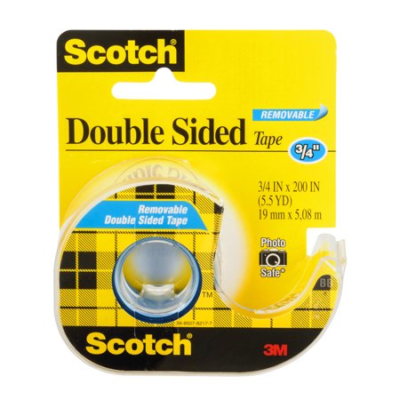

if they arent latching on correctly would there be a fix for that?
There's two ways to fix this. Either replace the cover piece or use a thin strip of double sided tape. The tape method is temporary where you have to do upkeep in replacing the strips.
Edit #2 - You could also try mounting pad/foam as a column in between the areas where the SD card and game cart. Also temporary.
