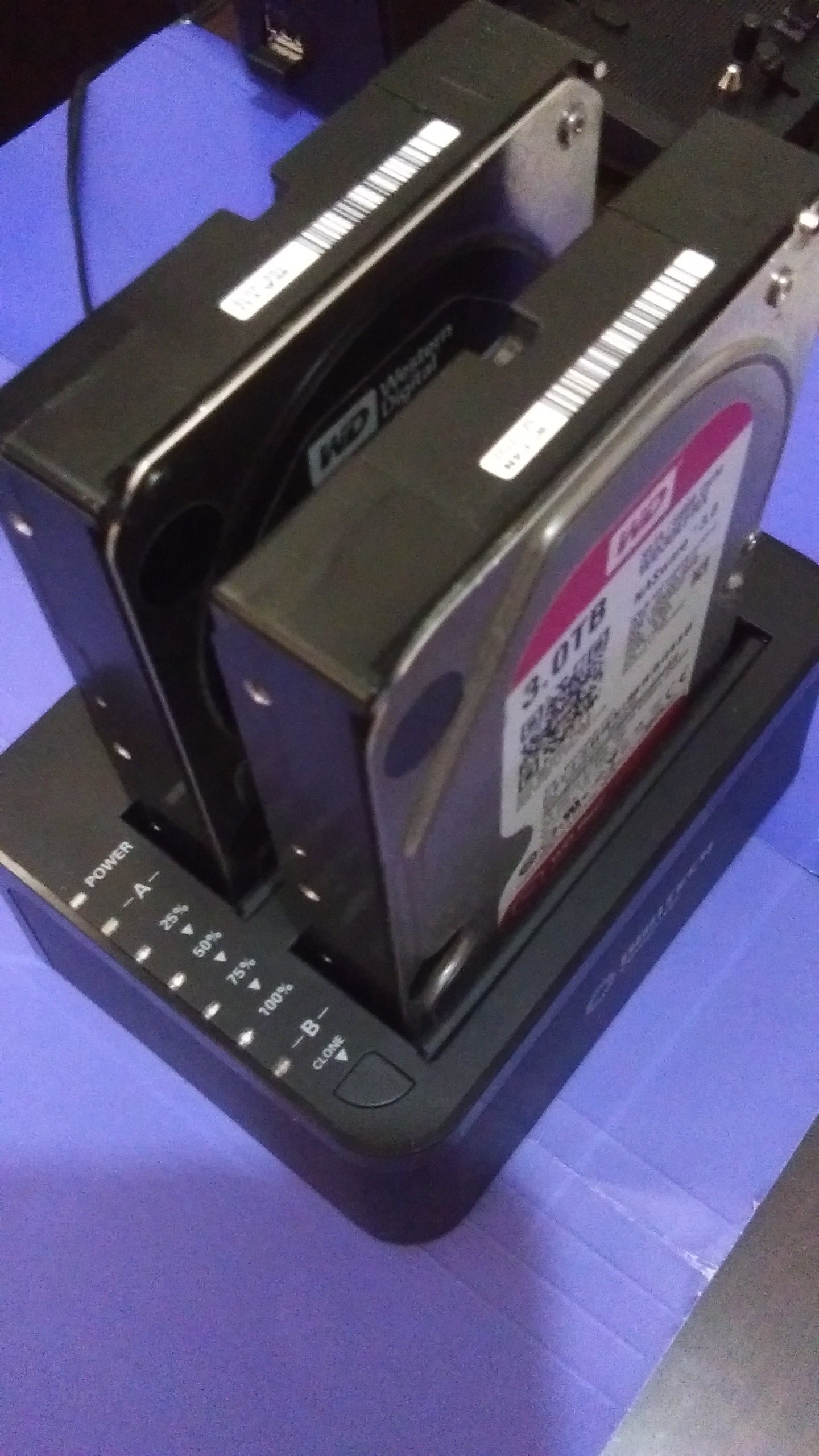

Can I make a FULL copy on a PC of my Wii U HDD?
To my knowledge - no. Possibly with Linux. I have successfully cloned weird custom-format drives using twin-slot USB drive docks with an off-line clone feature. This enables drive cloning through the dock with only power connected, no PC required. The off-line clone process is a bit quirky in that the target drive MUST be bigger than the source drive to make it work eg 1.5TB source > 2TB destination regardless of how much information is on the drive!
Reactions: TonyNESgri
To my knowledge - no. Possibly with Linux. I have successfully cloned weird custom-format drives using twin-slot USB drive docks with an off-line clone feature. This enables drive cloning through the dock with only power connected, no PC required. The off-line clone process is a bit quirky in that the target drive MUST be bigger than the source drive to make it work eg 1.5TB source > 2TB destination regardless of how much information is on the drive!View attachment 160382
Well, I guess is possible! :D
