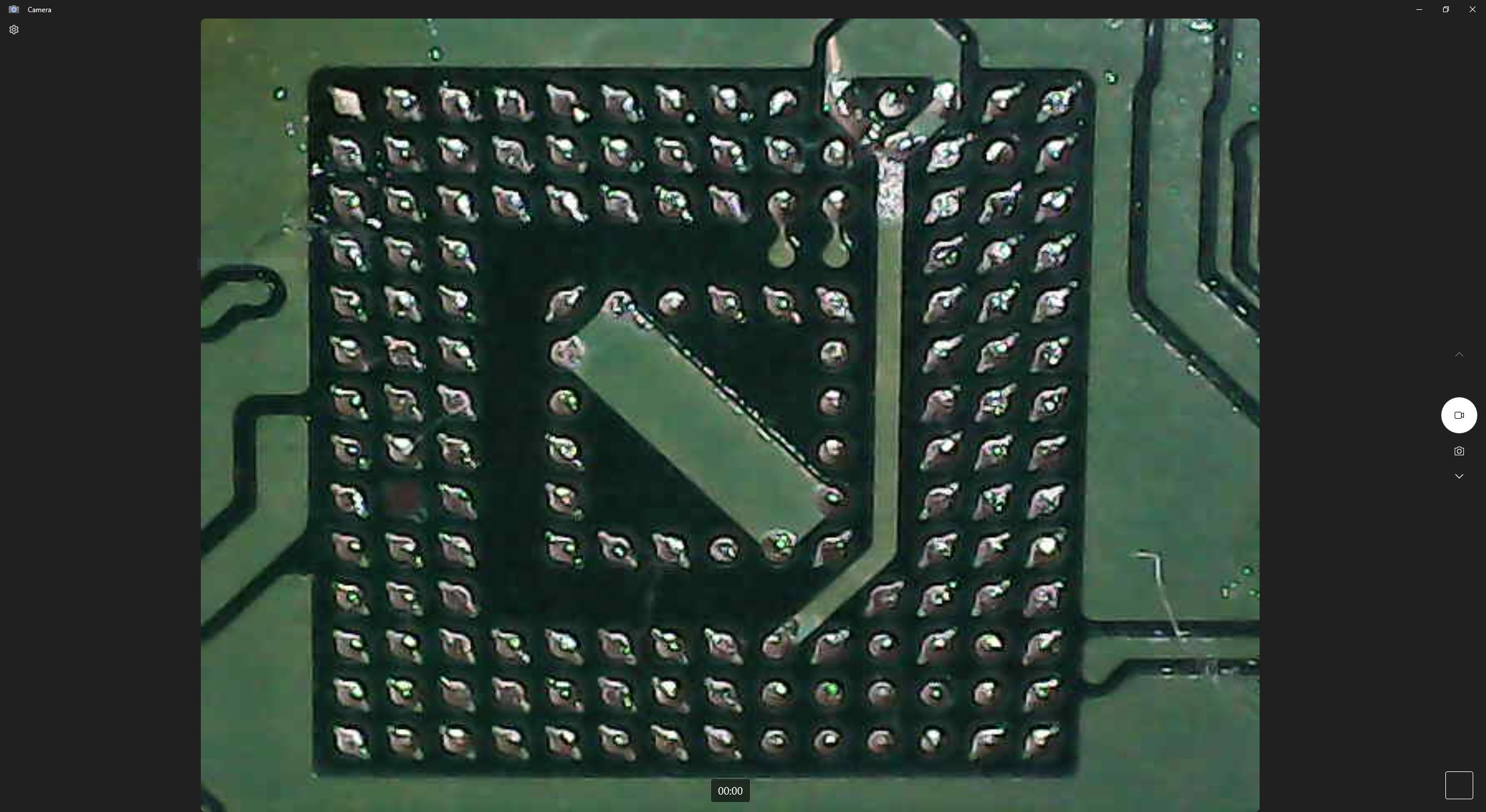

Hi all, newbie here.

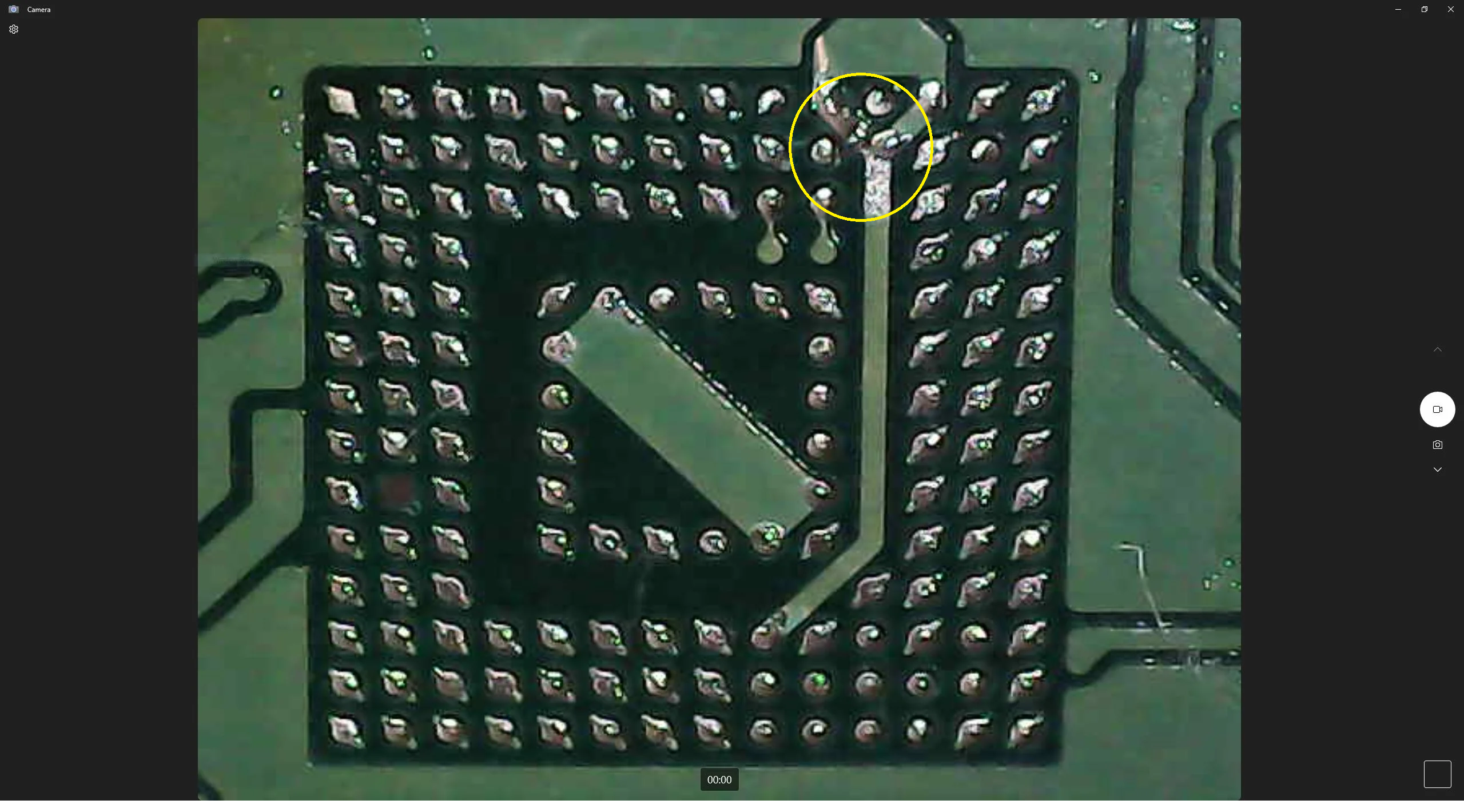

I have done several mods on V1, V2 but this was my 1st time doing OLED. After installing PicoFly I was happy to see "Insert SD card" and Raspberry logo, I inserted the microSD turned on the console, booted into Hekate and then after fully assembling the Switch, it only booted into OFW, with Raspberry pico LED blinking reporting DAT0 is not present, also OFW would occasionally stop working and had to unplug and replug the battery. Later on, it stopped booting completely. I was correct to suspect a cracked joint under the eMMC, but was not expecting a missing pad on the PCB :unsure:
My question is, if I happen to somehow reball the eMMC chip and put it back, would it still boot? I tried looking for the datasheet but can't seem to find any that shows if this is just another GND point, or is it something of importance on that tiny pad.
Thanks, everybody! I appreciate your insights.
What did you do on dat0 initially to get "insert SD CARD'. adapter or what?
missing pad is NC= not connected, so just ignore it but your VSSQ area looks messy might need some solder mask to cover up exposed spot.
FYI what data0 resistor value do you have on the picofly you installed?

Easy way to tell if balls are connected is to look at the shape if its fully rounded. NC balls are irregular.

Thanks for the advice.
Initially, I used the Ali Express DAT0 adapter, but I believe I applied too much pressure on it while inserting, causing the balls to crack. Anyways, that's my theory.
I will clean up the VSSQ area, and reball as soon as I get the stencil for reball.
DAT0 resistor is 47 Ohms, and measures at exactly 47 with my Fluke DVM.

Since you already desoldered the emmc chip, you might as well solder an enamelled magnet wire directly to dat0 pad before you put back the emmc chip. No need to mess with emmc adapters.
Good point! Those were my thoughts as soon as I took it off, to be honest, getting that tiny wire soldered to that pad took me like 20 minutes, and gave me a back pain. Still managed to pull off a nice joint, and immediately went in and put some solder mask and Kapton tape to hold it in place.
