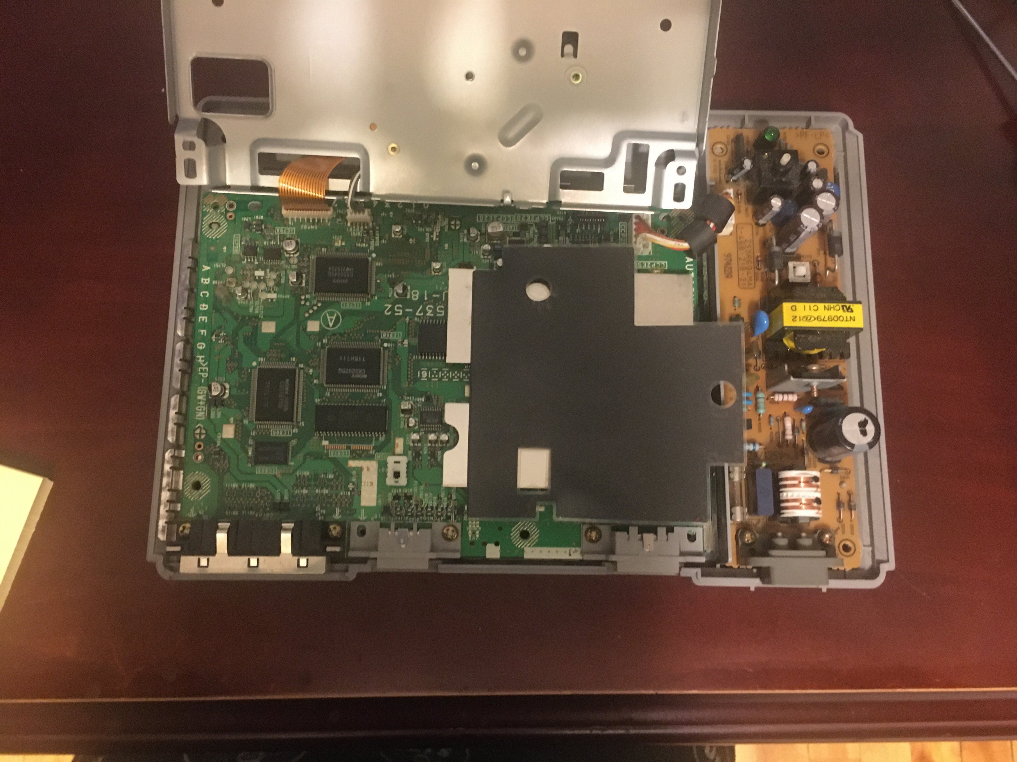

I can't tell which part of that guide I should be looking at, but this is what it looks like after disassembling the console as much as I know how:
