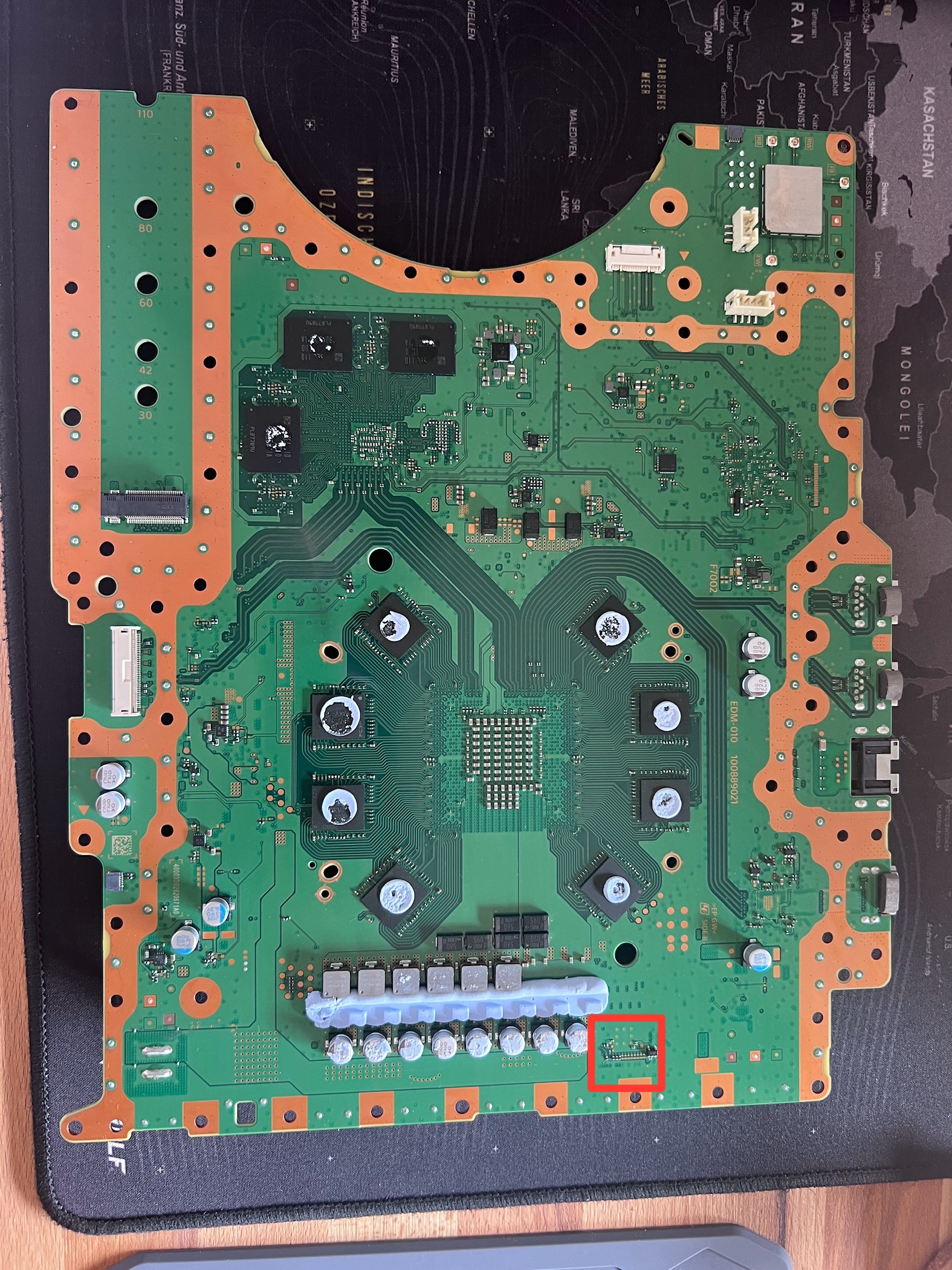

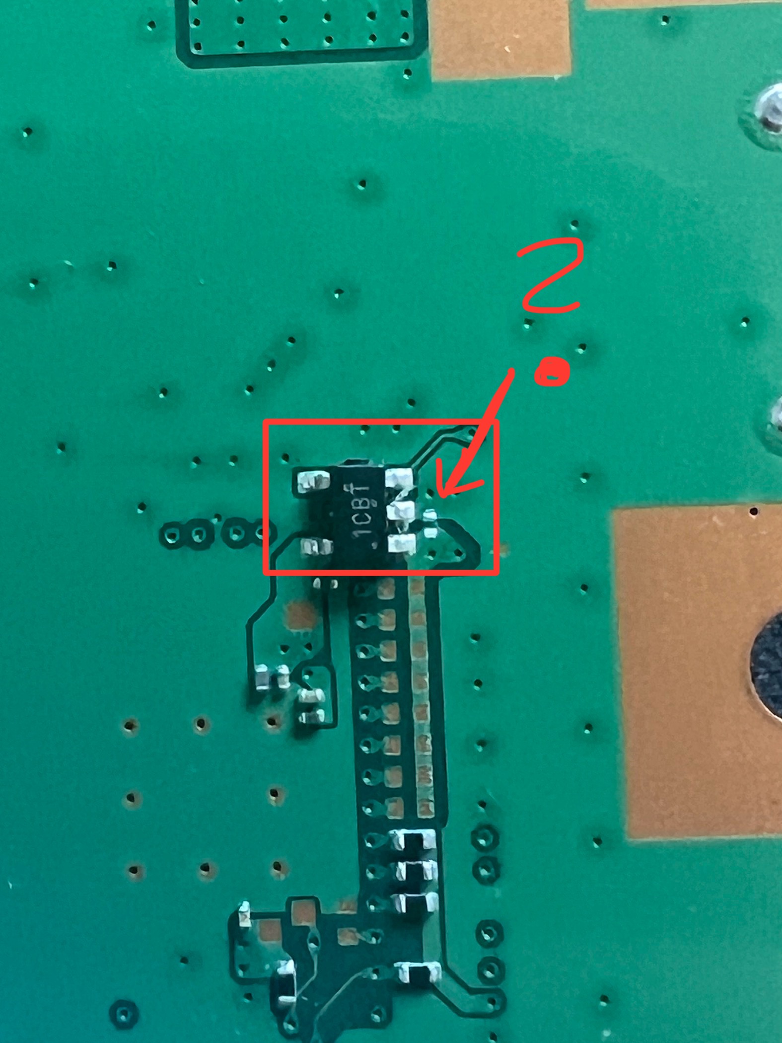

Does anyone know the values of the missing cap at the dcdc on my edm010? (See attached image)

The Datasheet of the 1CBT says, that one is optionalbut when you thinkt that you need it. You can take a 6,3 V, 1uF ceramic Cap.
Input Voltage Range: 1.4 V to 5.5 V
Reactions: deservd_
Thank you very much, i wasnt Sure if i found the right datasheet but ur reply confirms i did
