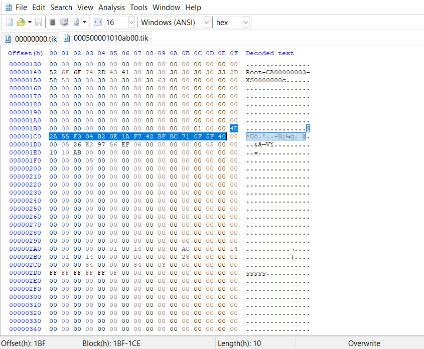

It's a good thing you put my work into question, because that means that I can double-check with a little more knowledge!

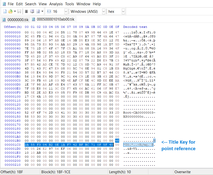

When you use tik2sd to copy your tickets to your SD, you're given a notepad that shows all the titles that have ever been registered to your console. Looking it up online, Arkham City's US Title ID is 000500001010ab00, and its Title Key is 4e2a55f304b20e1af742bfbc710f5f40. When copied from tik2sd, this Title was found inside 0000 > 00000000.tik. For me at least, 2 other Titles are shared in this file: Crunchyroll, and Twilight Princess HD.
While the Title ID is not found inside the tik's hex code, the Title Key is. Each title starts with "00 01 00 04" in its code, and about 3/4ths of the way in that wall of code you will find a string of hex code that matches the Title ID that you are looking for. If you downloaded the title legitimately or with USBHelper, the Title Key will be pretty much isolated from the rest of the code. If downloaded through NUSspli, the code is more compacted, so you have to search a little harder; on the 2nd or 3rd paragraph of code per title.
When I downloaded Arkham City, it was through USBHelper back in the CBHC days, so I found and deleted the title pretty easily.
This, unfortunately, did not fix my problem.
At that point, I decided deleting the whole tik file from my system would fix things. Nobody sane still uses Crunchyroll, let alone on Wii U, and I think I might get Twilight Princess HD physically in the future, so losing that won't hurt me.
Still no changes...

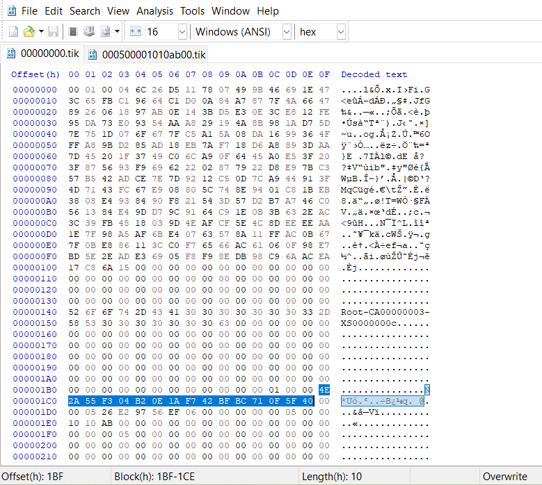

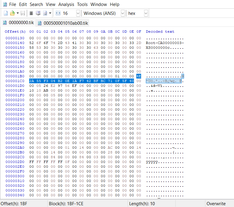

But it did encourage me to check the files on my disc! tik2sd can extract and copy tickets from whatever disc is currently in your drive, and they get their own folder on your SD called "odd" (probably stands for "optic disc drive"). If I have the ticket that's on my disc, I can compare it with the digital ticket!
To my surprise, both the ticket on my disc and the ticket on my NAND are identical!
Whatever could be making my Wii U not like my Arkham City disc, it's not a ticket issue, because based on my observation, they are a perfect match! I'll drop the screenshots so you can see for yourselves in case I could have missed something.

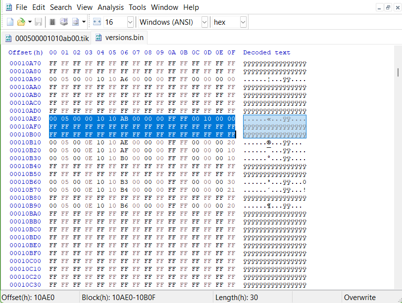

Right now, I can try 4d1xlaan's suggestion, but I don't know how to move forward. I think I found the game I'm looking forward based on the fact the hex code matches Arkham City's Title ID, but I don't know what the rest of it means. What do I change? Do the lines of Fs in the code mean anything?

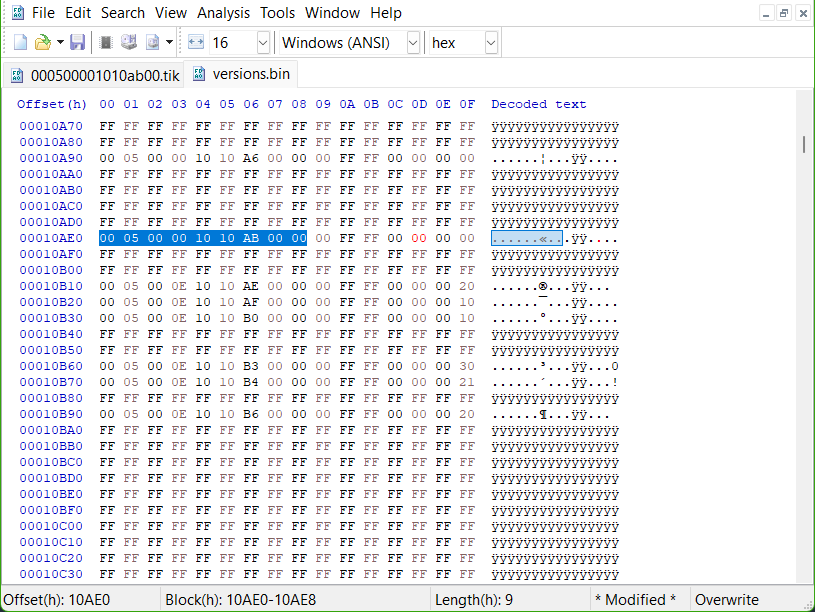

anyway sorry I forgot yesterday, but in your versions.bin at this line, you would change at FF FF 00 10, to FF FF 00 00
and when you go to put the edited file back on nand, don't delete the old one. drag the edited file onto the folder and let it overwrite (some issue with file permissions that you might avoid that way)

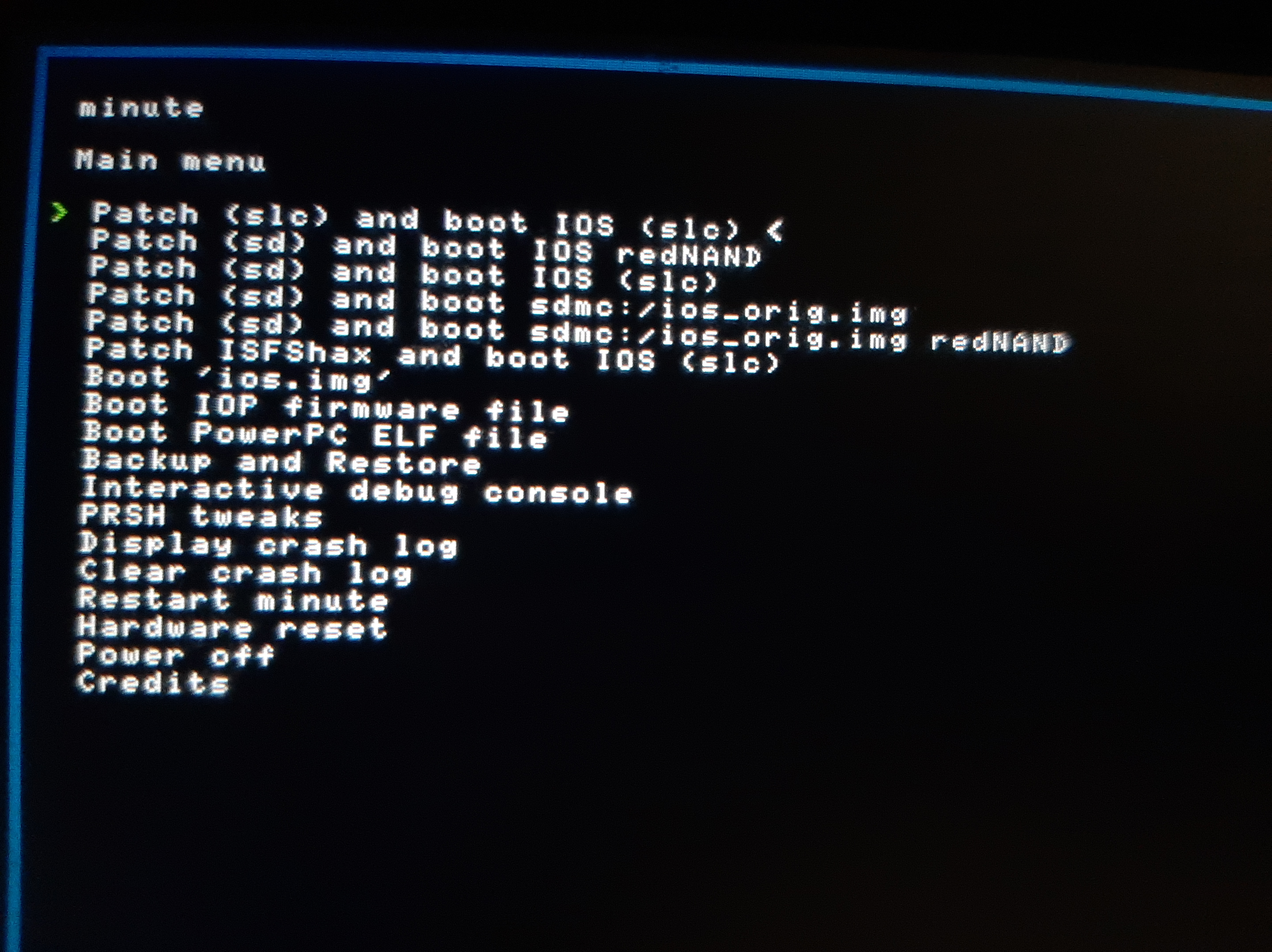

I think I'm stuck. I downloaded everything required to boot ISFShax except the files for the UDPIH exploit, and when I boot up my Wii U, I see a menu with a blue border, but I can't seem to navigate anything. View attachment 20240703_184218.jpg
Exactly how mandatory is it that I install ISFShax before I replace the versions.bin? I know there's the risk of bricking, but how high is that risk if my Wii U is plugged into an ethernet?
I think I'm stuck. I downloaded everything required to boot ISFShax except the files for the UDPIH exploit, and when I boot up my Wii U, I see a menu with a blue border, but I can't seem to navigate anything. View attachment 445295
btw I'm pretty sure your disk ticket confirms my theory, considering that title version in disk ticket is v0, but the version number in version.bin was v16
which to me would indicate that the disk is v0 while the digital is v16
A'ight, I give up on ISFShax. I don't know how to select "fw_img_loader," and when I go to download it, it's yet another payload elf, and I'm just about out of patience. I'll let shit hit the fan.
Once I overwrite the versions.bin on my slc, do I need to reboot my console to apply the changes?
It was as simple as fixing a mistake in the versions.bin code. My console wanted me to download an update that never existed in the first place! It doesn't make sense how an error like this could crop up, but I do have a theory.
