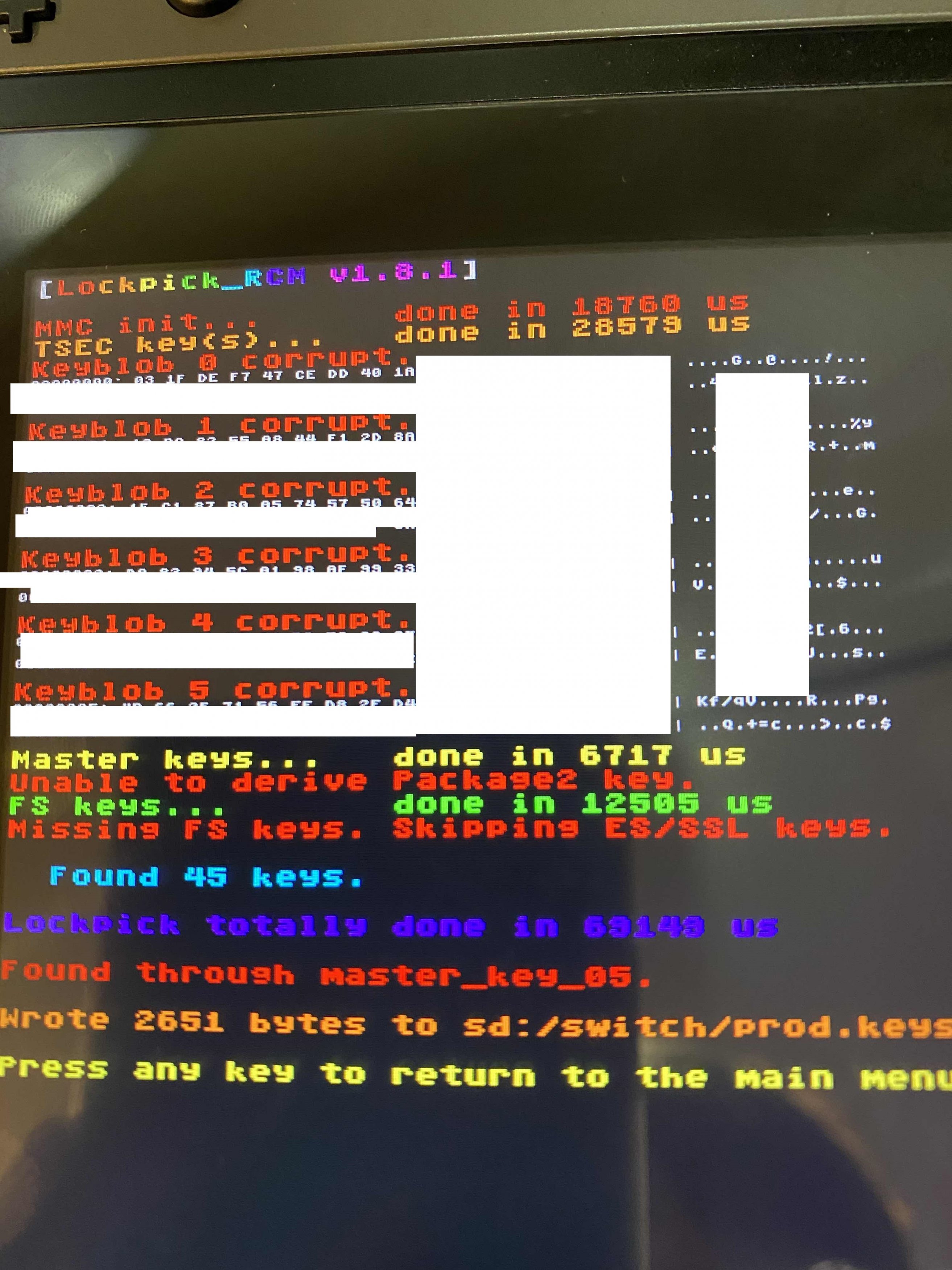

I lost my BOOT0/1 and accidentally flashed ones from my other console. I was able to find my prod.keys, ran linkle, used hxd to insert them at the right addresses, and it still comes back bad in lockpick
Am I missing something? Is it possible to recover at this point?
BOOT1 doesn’t need anything.
From my experience it seems like lockpick complains when non-original keyblobs are installed for whatever reason, looks like it was able to derive the masterkeys which probably means the keyblobs are fine though. Have you tried booting it yet?
