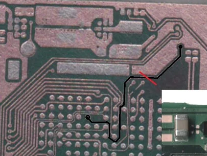

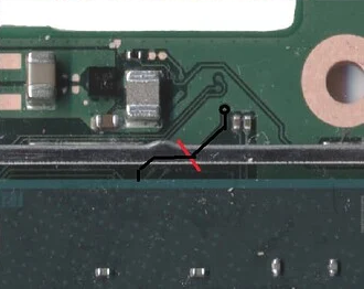

Check whether you have unintentionally scratched the PCB around the metal shield while trying to open it.
The joycon line is very close to the metal shield and when trying to remove the shield, it can be damaged, maybe shorting out something else as well.
The joycon detection line runs under the emmc so that might also be a point to check.
That's very helpful! I had a lot of care but I gonna try, since I did with a needle I doubt it could be but I gonna double check
