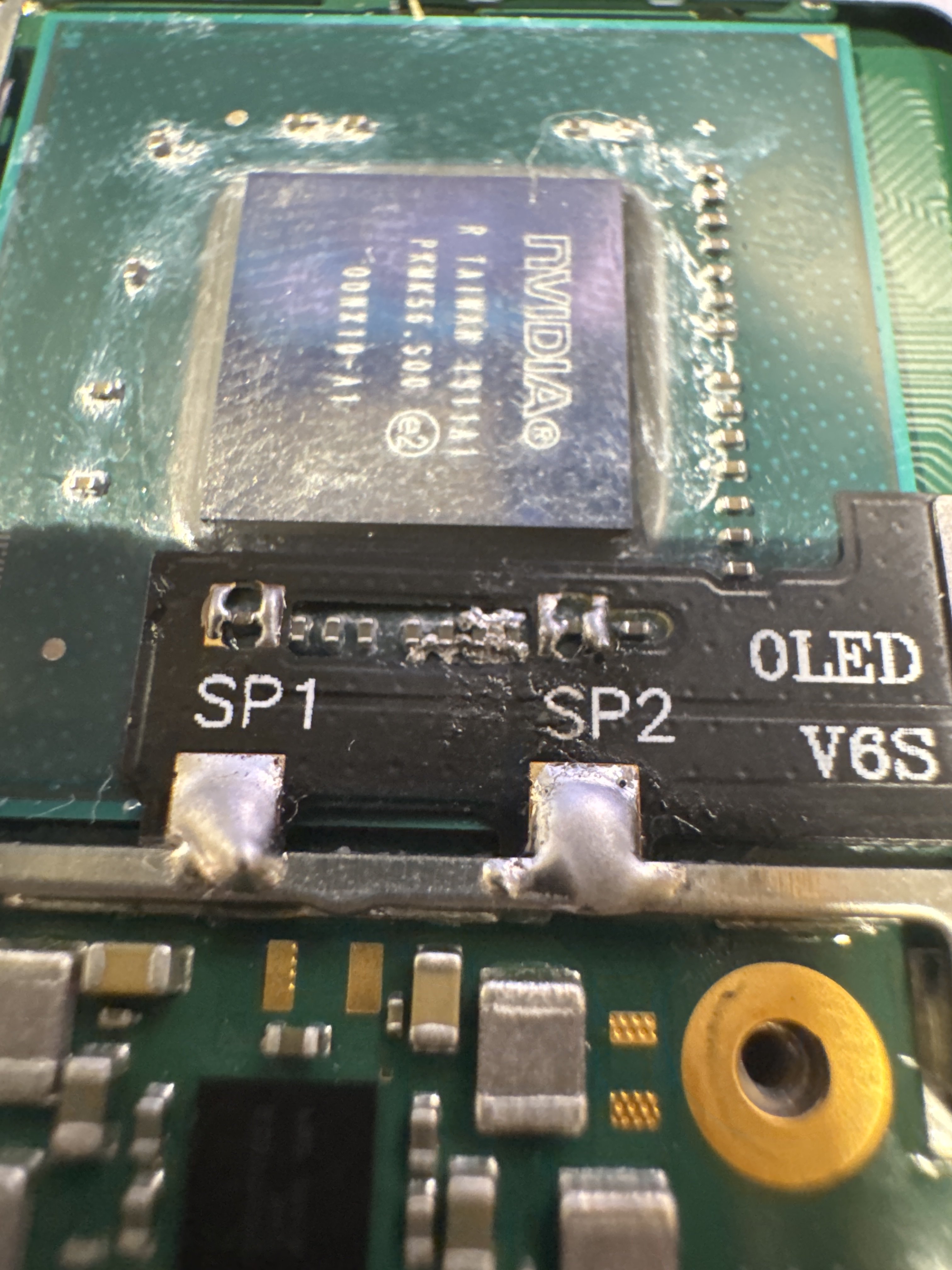

Accidentally caused this white trying to install and now it wont turn on even without the main board connected
damn you need to take that off and re-attech the two drowned caps. Way to much solder were used here and most likely no flux?
No solder wick?
Preheat the board a little and go over the excess solder with the wick and the soldering iron.
Its definately fixable.
After that resolder the tiny capacitors. Best with flux and a hotair station. I doubt you will be able to resolder them by hand with an iron. No offense here, its extremly difficult to solder these tiny caps by hand.
No solder wick?
No solder wick?

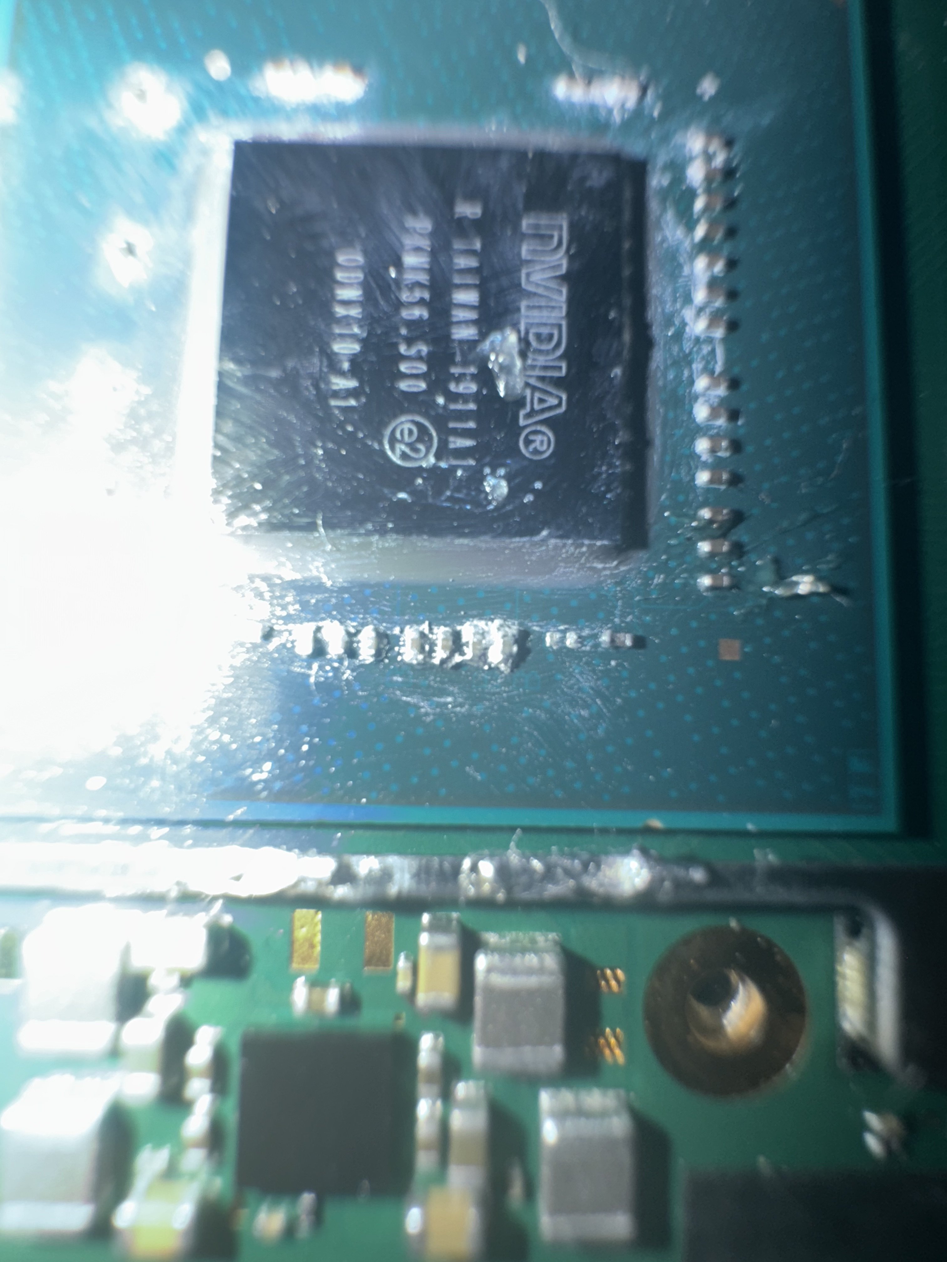

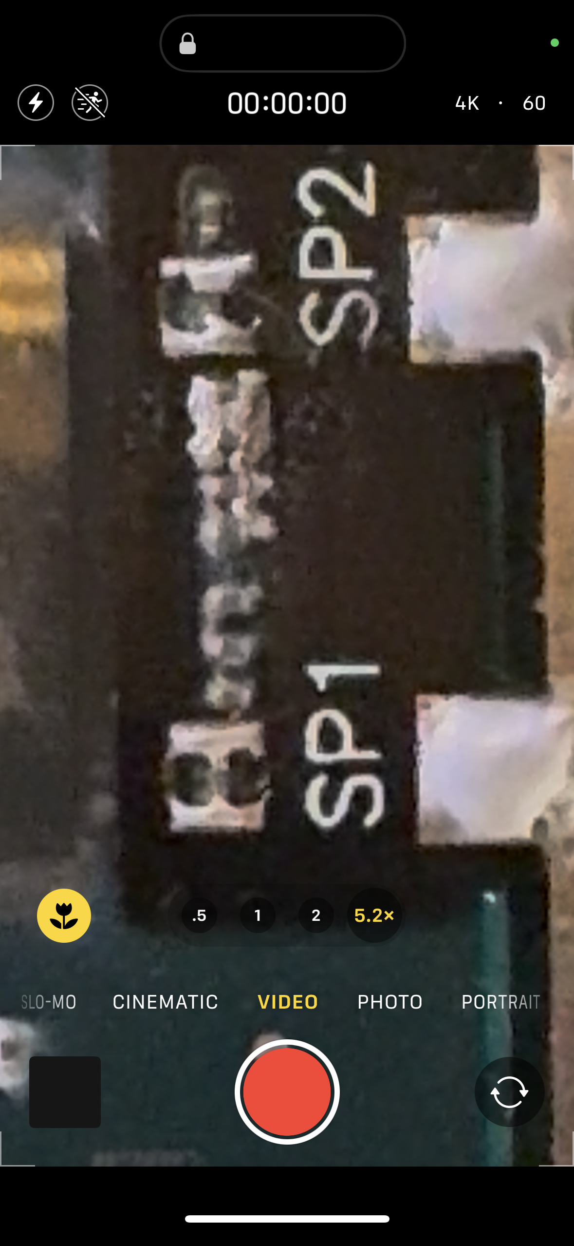

Ive tried for the past hour maybe to remove
the solder with a copper wire and flux but i cant seem to make much progress
And the sp2 is gone

Learn to solder on an old laptop motherboard or something else that isn't your Switch. You can re-create the situation you have and then practice correcting it.
Your current issue is too much solder. You should be able to fix it with some good flux and a clean soldering iron tip.
You need something like this to clean the solder off your soldering iron tip
Make sure you have plenty of flux on the components
Touch the excess solder with the clean tip and then drag the solder away from the components
If that doesn't work you can try the solder braid.
