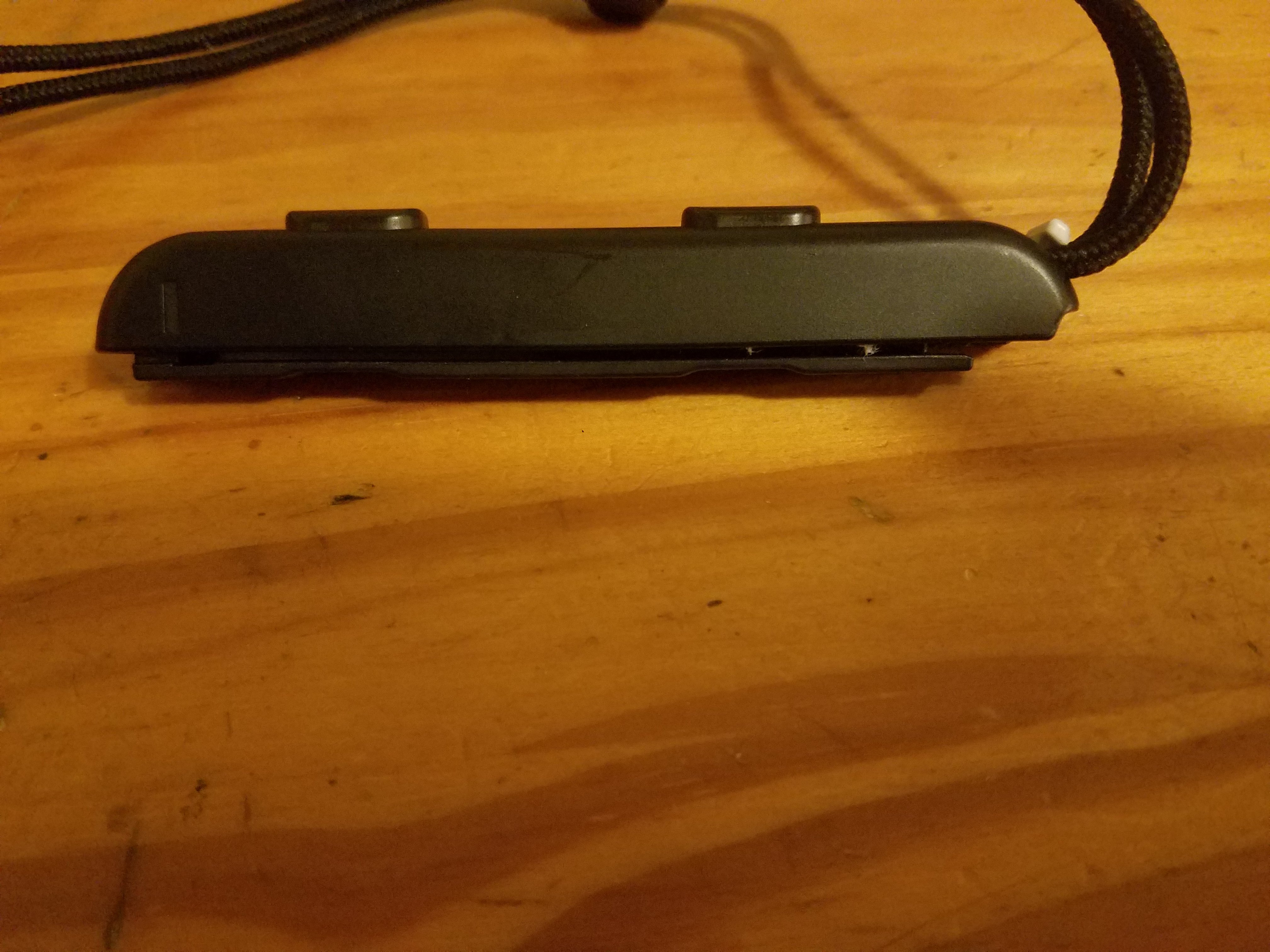

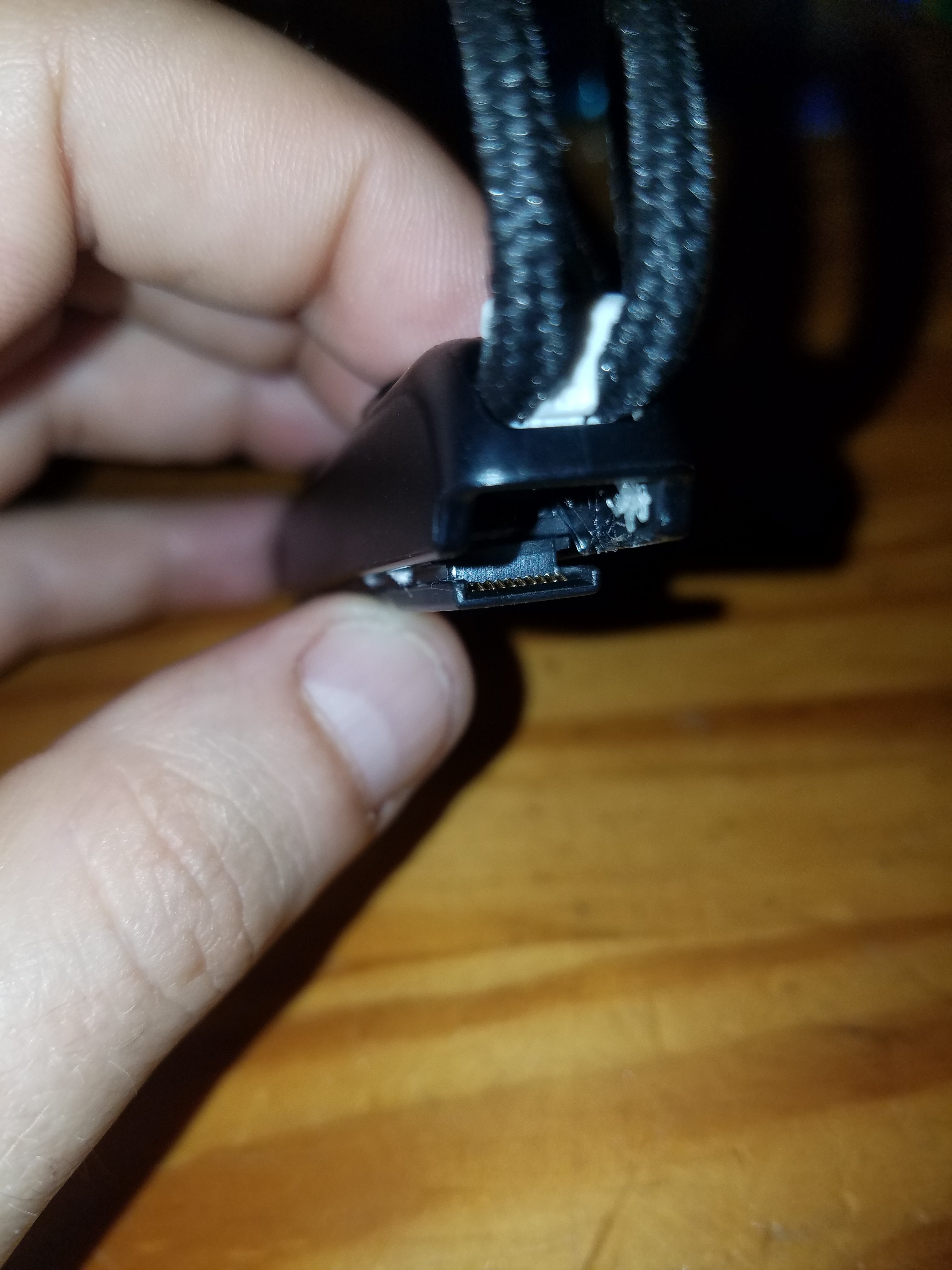

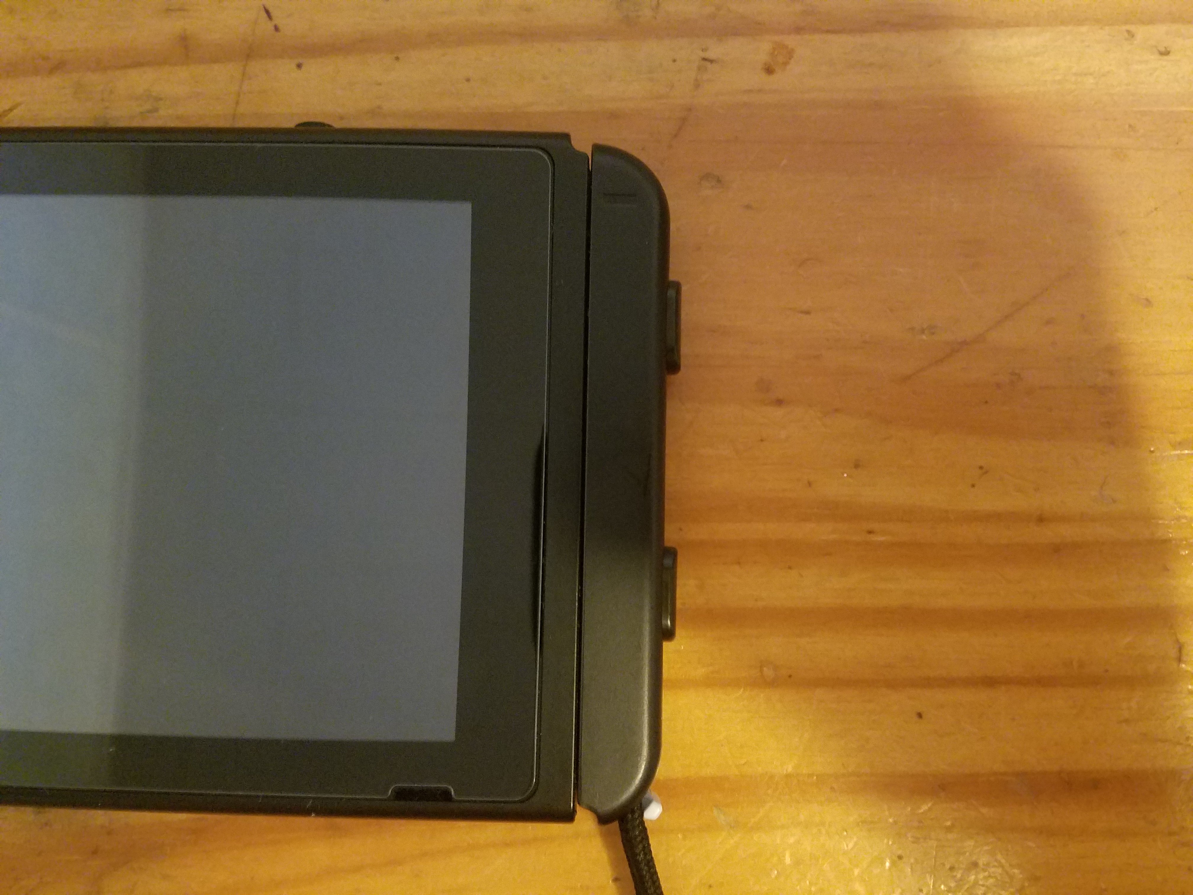

I have purchased a right hand side rail, i will make a jig from this to remove wear and tear.
I used a rail and put it inside a gutted joycon strap, looks and works great
