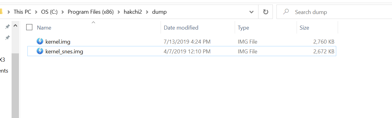

I have the kernels for both nes and snes it would appear, the original ones:
