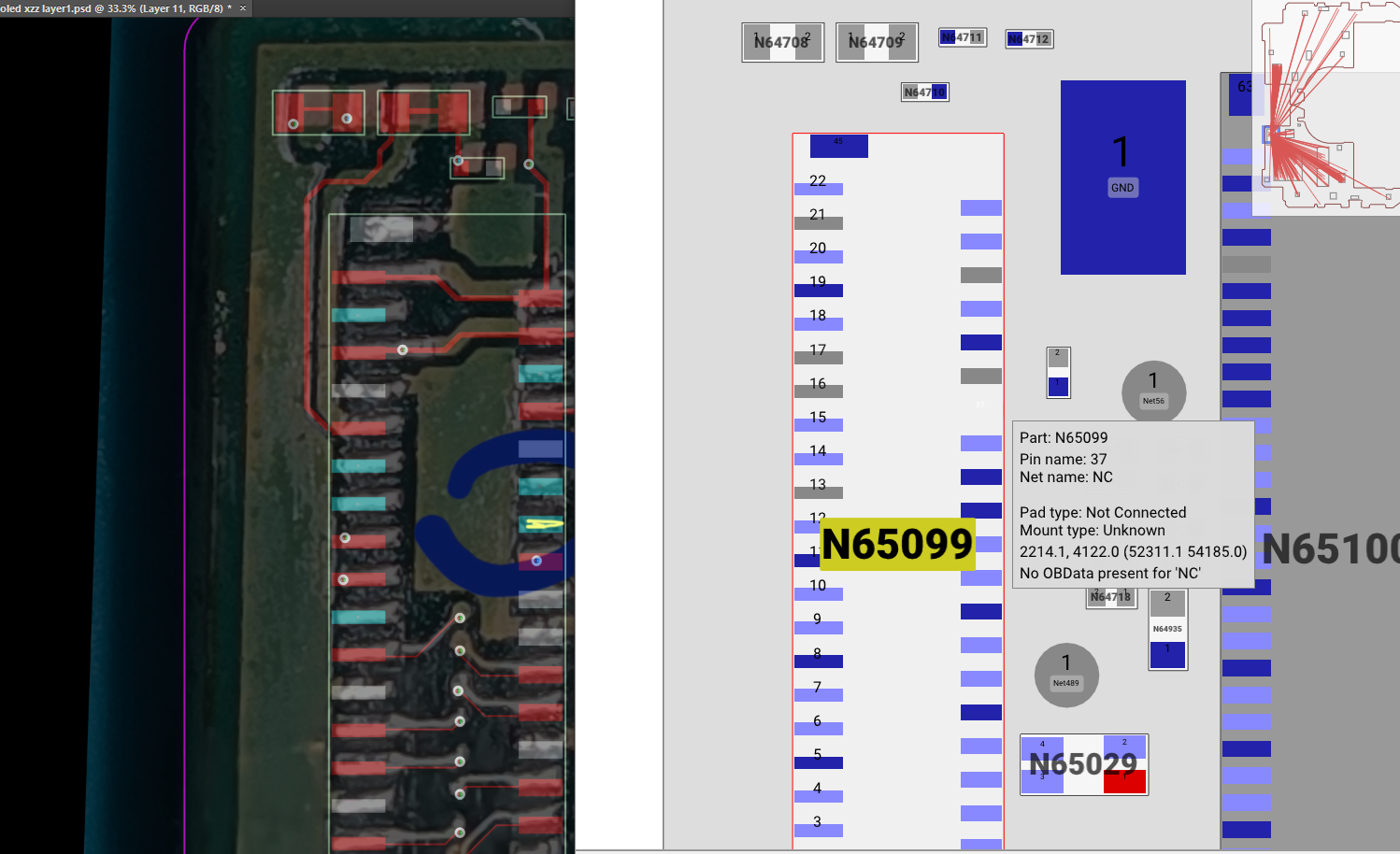

Switch oled soldering point One pin fell off while gluing lead to the soldering point with a lead tip
Is it an essential element?
If there's no chance I'm going to dispose of this machine...
Socket replacement is too difficult
It's easier to install chips....

Might have to use a trace pad if there are any trace left.
I zoomed in on that part, but I can't find any remaining traces. I'm very concerned.
I'm sorry, but what exactly does NC mean? Not connected?
So if I ignore that part and try to fit the socket, will this machine be saved?
Yes Not Connected. It isn't unusual for NC pads to come off as they don't have much holding them to the board.
That's good news.
I have a lot of difficulties with the lack of hot air station usage skills prior to installing this socket, but I will try again by purchasing an additional socket.
Thank you.
