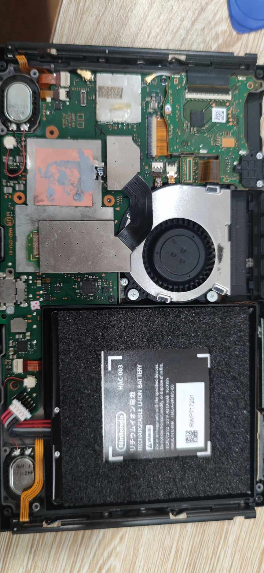

I think my soldering is quite accurate but when I turn it on, the circuit reports an error *=*
I checked on the picofly document and this error is due to the eMMC
*=* No eMMC block 0 read (eMMC init failure?)
I tried removing the eMMC and turning on the device, the circuit still reports an error *=*
After checking for a while, I noticed that the capacitor on the eMMC circuit seems to have fallen off.
Is there a way to re-solder the capacitor or replace the eMMC circuit?

Hello,
Can you try booting without the Picofly to see if the console still works? If it's not working, re-soldering the capacitor should fix it. Someone should have the value of that specific capacitor.
If you have pictures, it will help us assist you better.

Booting without Picofly doesn't work :(. Thanks for your advice.
Thats a 2.2uF 3.3v cap, if your device cant boot normally without modchip, you should check something else before putting new cap on
Yes, my device can't boot normally. Are there any parts I need to check before putting new cap? Do you have any aliexpress link to buy that cap?

I have some pictures here. Could you help me check if anything is wrong?
