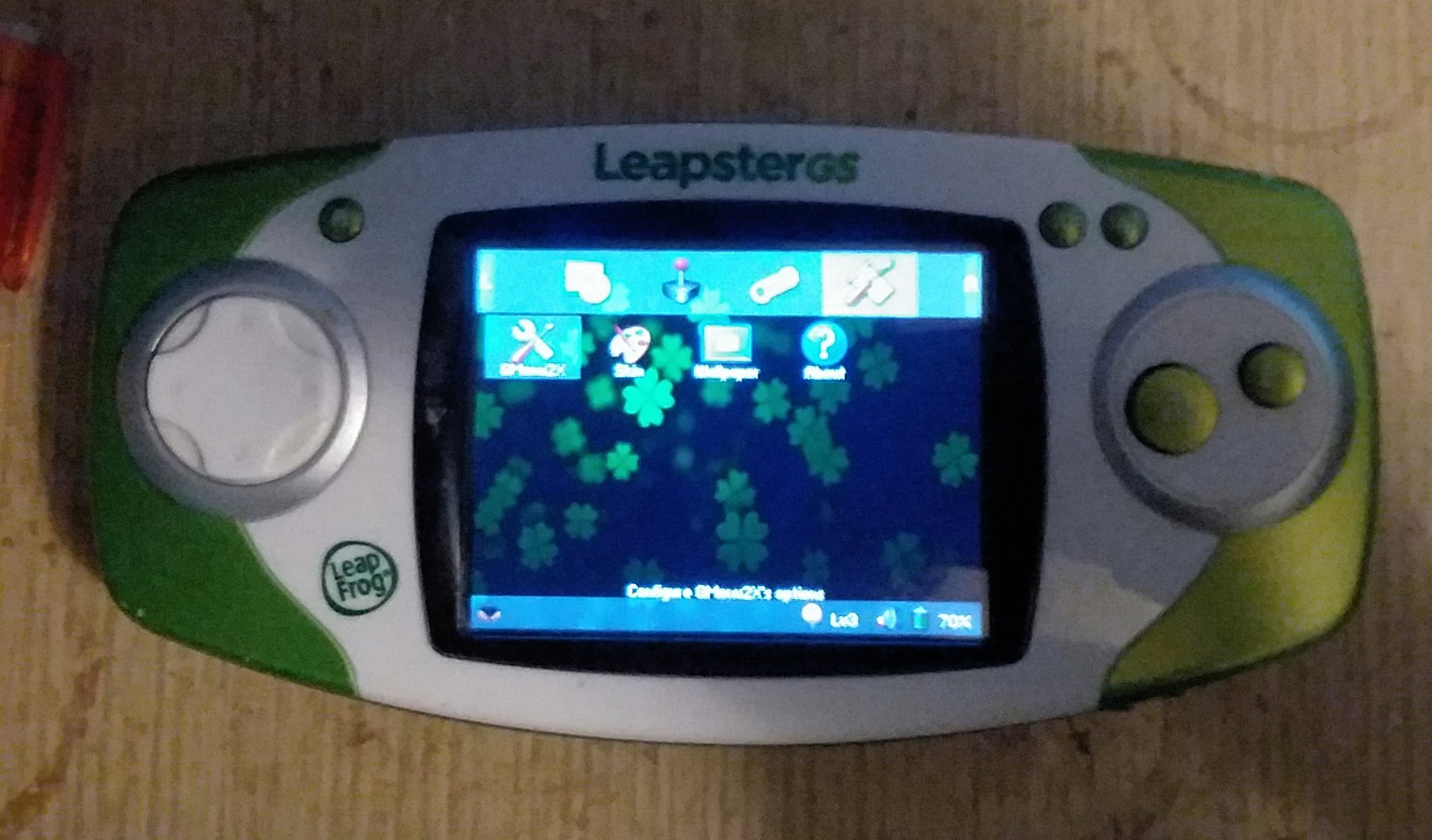

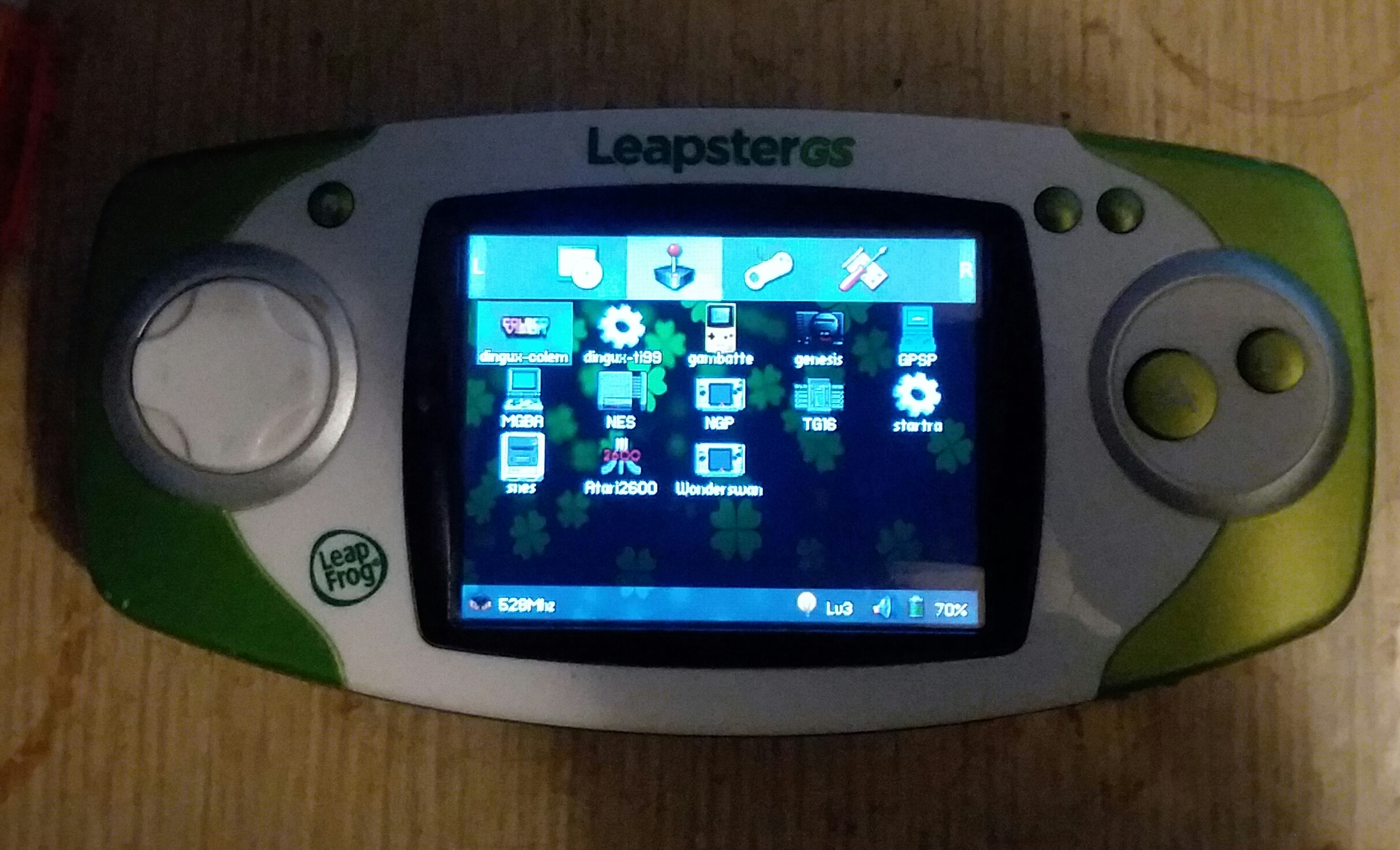

There is a decent amount of room for a lipo battery + usb 5V power supply + lipo charging board in the LeapsterGS in the battery compartments and unused cart slot. Probing with a volt meter, it looks like the batteries (alkaline nominally 1.5V each, NiMH are 1.2) are connected in series to build up 5 to 6 volts across the (-) terminal of the leftmost battery and the (+) of the rightmost battery. (Left/Right w/ respect to cart slot facing you, screen down.) Time to get out the glue gun!
I got gmenu2x to compile. It will run on the leapsterGS, but most of the buttons don't work and the screen does not refresh properly. Anyone know where in retroarch the keys are mapped?
In gmenu2x there is a file input.conf:
up=keyboard,273
down=keyboard,274
left=keyboard,276
right=keyboard,275
modifier=keyboard,32
confirm=keyboard,306
cancel=keyboard,308
manual=keyboard,304
section_prev=keyboard,9
section_next=keyboard,8
pageup=keyboard,9
pagedown=keyboard,8
settings=keyboard,13
menu=keyboard,27
backlight=keyboard,51
power=keyboard,279
What SDL keycodes correspond to the LeapsterGS buttons?
Only "settings", keyboard,13 works. I'm guessing this is probably "Return" from looking at this page:
https://wiki.libsdl.org/SDLKeycodeLookup
The screen corruption was due to dumb typo in SDL_SetVideoMode().
I've managed to figure out how to map the buttons on gmenu2x and port a few other dingux apps/emus:
  • dingux-commander file manager (use at your own risk, recommend you not browse outside of /roms folder)
  • dingux-colem (libretro bluemsx is overkill if all you want is colecovision )
  • dingux-ti99 (not in retroarch, my favorite old micro)
  • Last Mission (dingux clone of old MSX game)
Most of the other emulator icons are just scripts that launch retroach cores.
I've also figured out how to read the battery voltage (from /sys/class/blahblah....) and display a rough indication of the (assumed NiHM) battery state as a percent in lower right corner of gmenu2x. I've also got screen blanking working if the menu is untouched for 1 min. (Not sure I want this, err, feature, but I'll leave it alone for now.) The CPU speed shown in the left corner is wrong and can not be changed; I don't know if you can change CPU speeds on the LeapserGS.
Anyway, this LeapsterGS is just about as good as a Dingoo, at least for the emulators I've tried.
I want to test gmenu2x out for a few more days (and port a few more emulators and games from dingux, since it's easy) before I roll a rootfs image and upload it.

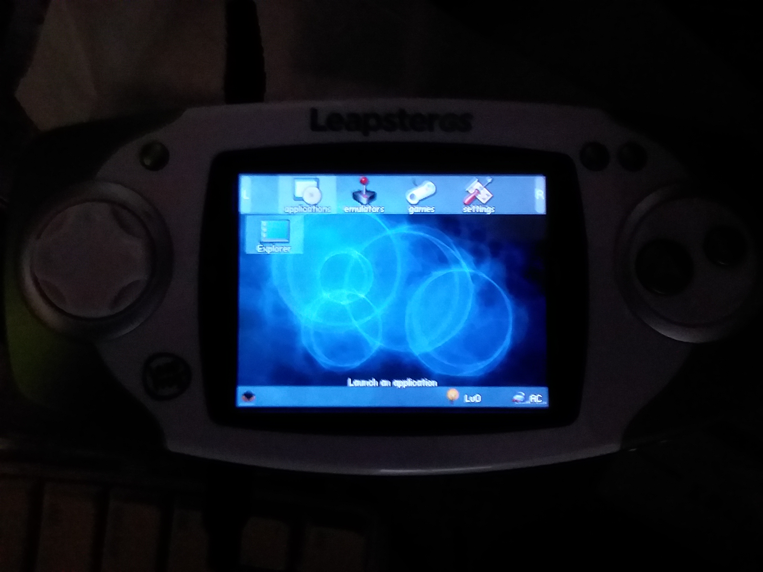

I didn't think anyone cared. I've got the menu working pretty well on my LeapsterGS.
The main reason I wanted the gmenu was to have some kind of idea where the battery charge is at before starting a game. I've adapted a battery meter (10 steps) and (sort-of) 5-level brightness control from some stuff in gmenu2x.cpp intended for a different handheld.
I changed my mind about making a lipo battery pack when I discovered the power pack is just 4 AA NiMH batteries: just grab some new ones and replace the old ones. (Takes a bit of careful prying to get them out.) Then you have a rechargeable handheld just like the retrogame only cheaper, and more rugged and sustainable.
Some installation is required. ;) Read the README.
