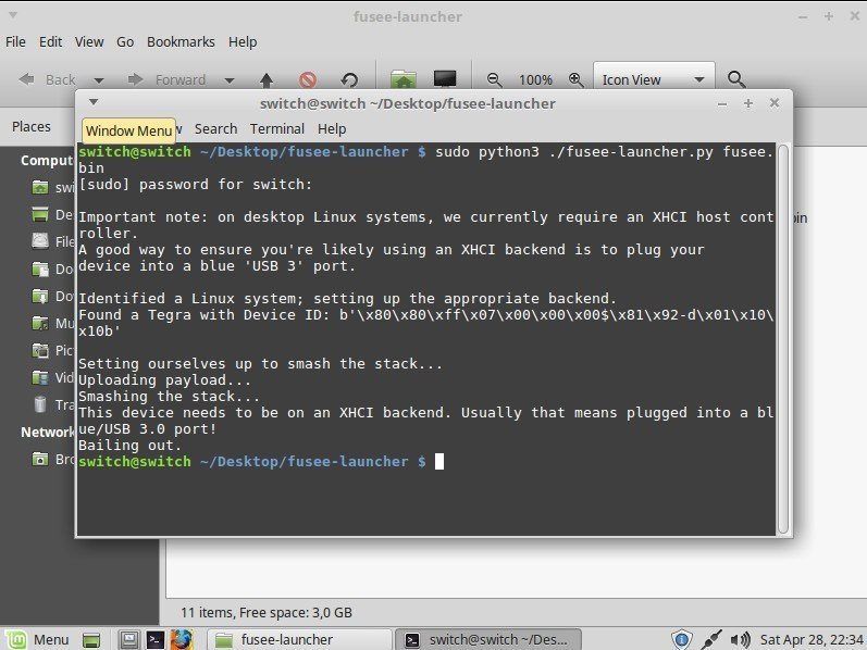

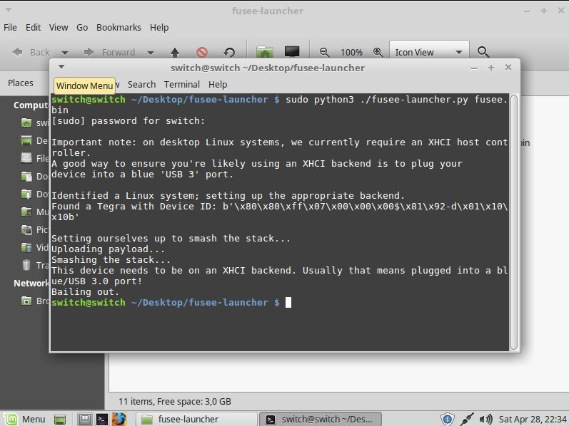

any help guys my pc don't have a usb 3.0 port:(
i'm trying to run fusee gelee for the first time

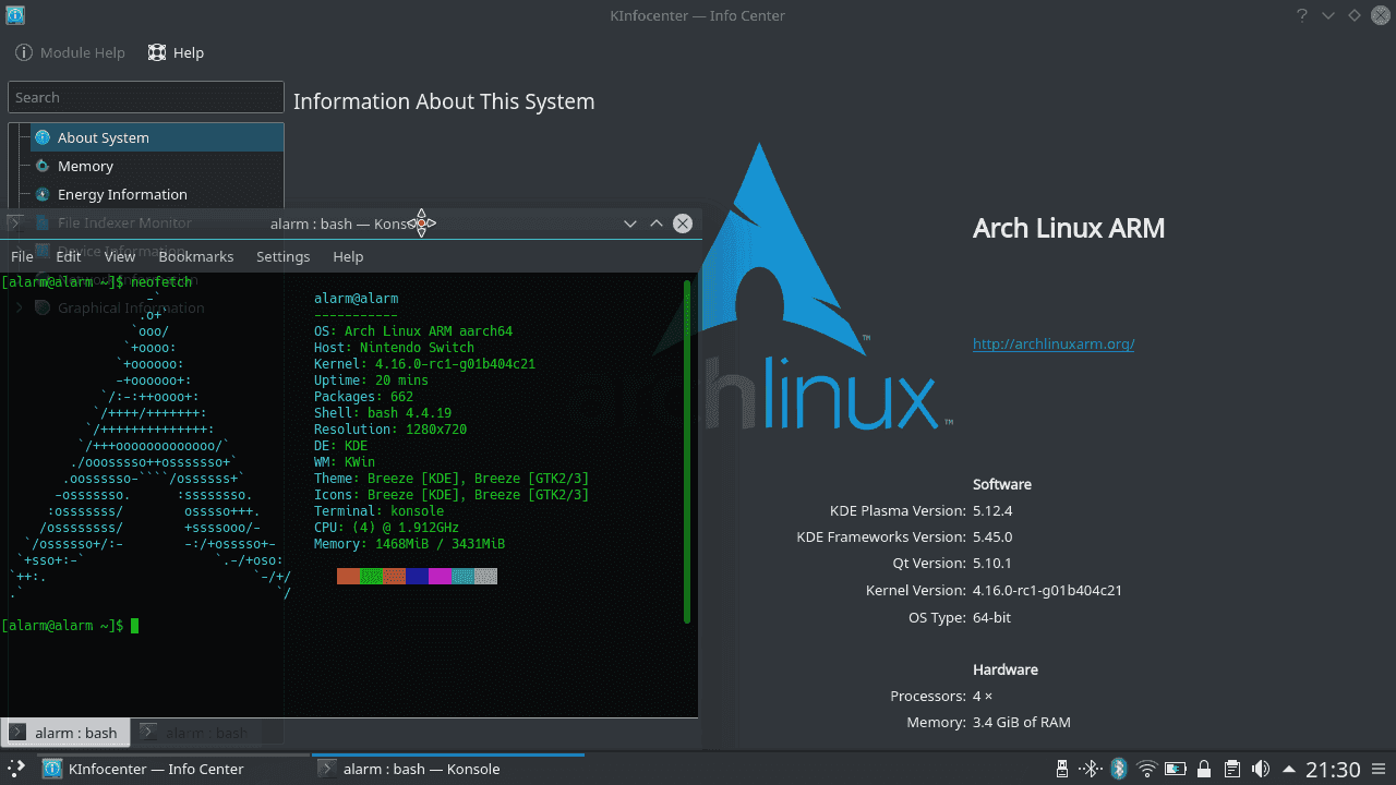

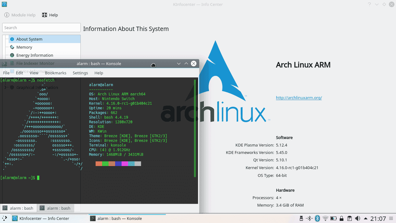

So the KDE rootfs is done, this will most likely be my last rootfs.
My initial goal from the beginning was to make a simple rootfs that would enable people that couldn't do chroot+qemu-aarch64 to use linux as that can be quite a pain.
Anyways in this release i have installed KDE, added @kombos NAND script (in /opt) and added a very simple bash script that switches the gpu clock (switchpower).
To use it simple run sudo switchpower and you will be asked to pick a preset, low (307.2MHz), normal (768MHz) or high (998MHz). (high is not recommended for longer periods of time.)
The default clock is set by a systemctl service called defaultpower.
https://0w0.st/KDE_rootfs3.tar.bz2

Do you have a picture of what it looks like ? For the first post

There's no out folder, it's just ./retroarch :)
Yes. This is an older pic but it looks the same.
