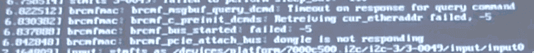

Also, i can see the wifi device failing at startup in your video.

Just a note about wifi, you need to reboot the switch from lxde and re-run the exploit. You should already be in RCM mode so no need to do the power+volume+home button payload.

Okay, WiFi is working thanks to @Gigaa's new kernel!
