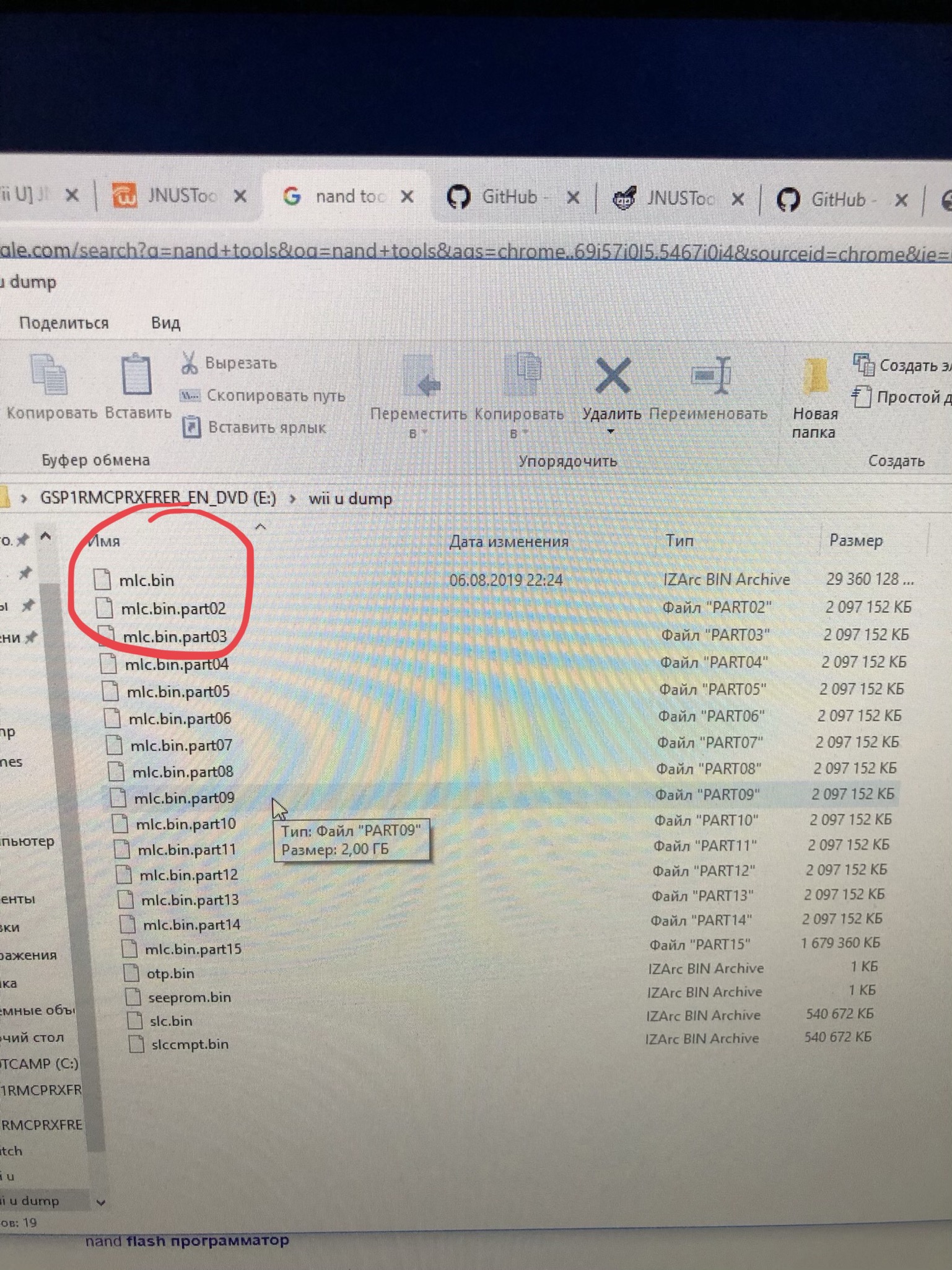

I've have already dump nand. I have 15 files mlc.bin. can I unzip it on computers windows 10 or OS X?
copy /b mlc.bin.part01 + mlc.bin.part02 + mlc.bin.part03 + mlc.bin.part04 + mlc.bin.part05 + mlc.bin.part06 + mlc.bin.part07 + mlc.bin.part08 + mlc.bin.part09 + mlc.bin.part10 + mlc.bin.part11 + mlc.bin.part12 + mlc.bin.part13 + mlc.bin.part14 + mlc.bin.part15 mlc.bin
btw, I'm not sure how to open the complete file. the otp.bin doesn't. I think the NAND tools don't work with it.

I've done this cmd text, then how could i get my profile files?

I don't know if this is true, but I remember reading something about cbhc and the slc. if you don't have an otp.bin but an slc dump, you can use that (as long as it's not a cbhc brick). if it is a cbhc brick, you need the otp.bin to fix it. best to have all backups though.
