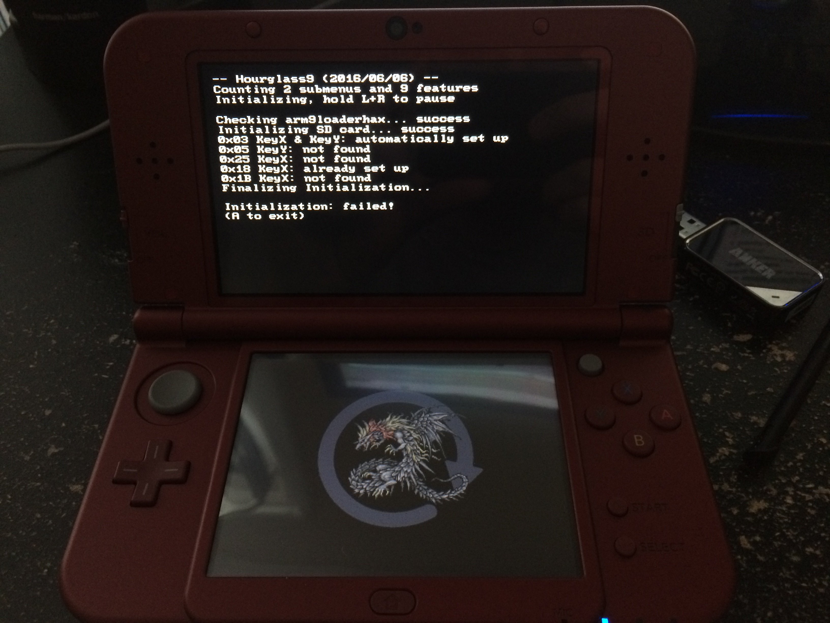

Not sure whats going on im using the most current guide as of 7/10/2016 and im stuck on "Section IV - Copying RedNAND data to SysNAND", ivee never had any problems till this any ideas what might be wrong?
Moving the proper files over and checking them with teracopy does not resolve the issue.

Your missing two keys that need to be in the root of your SD Card
slot0x05Y.bin
slot0x25X.bin

send a photo of the root of your sd card
Yup now it works, ill make an issue seeing as this is the first time I have needed the slotkeys even though in the past I have not need them and the guide currently has no mention of them.
