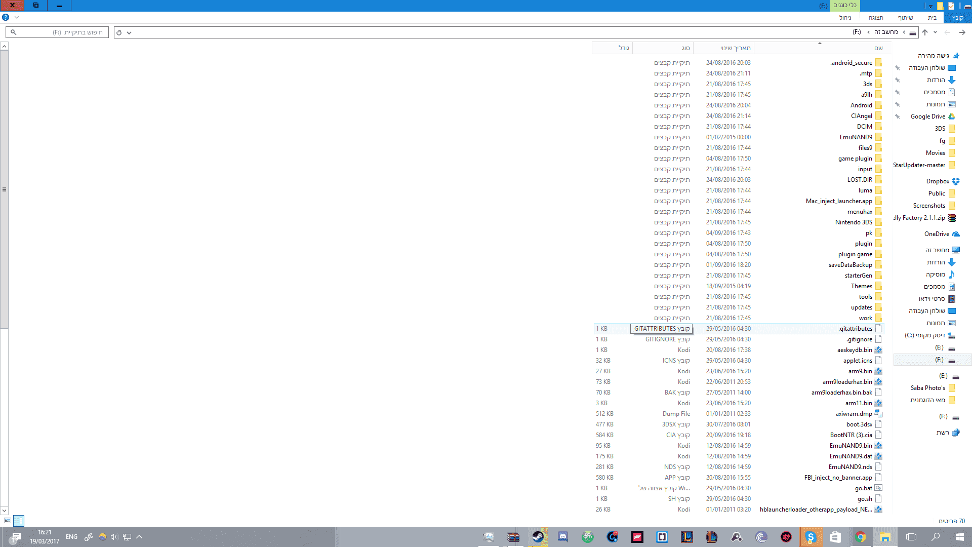

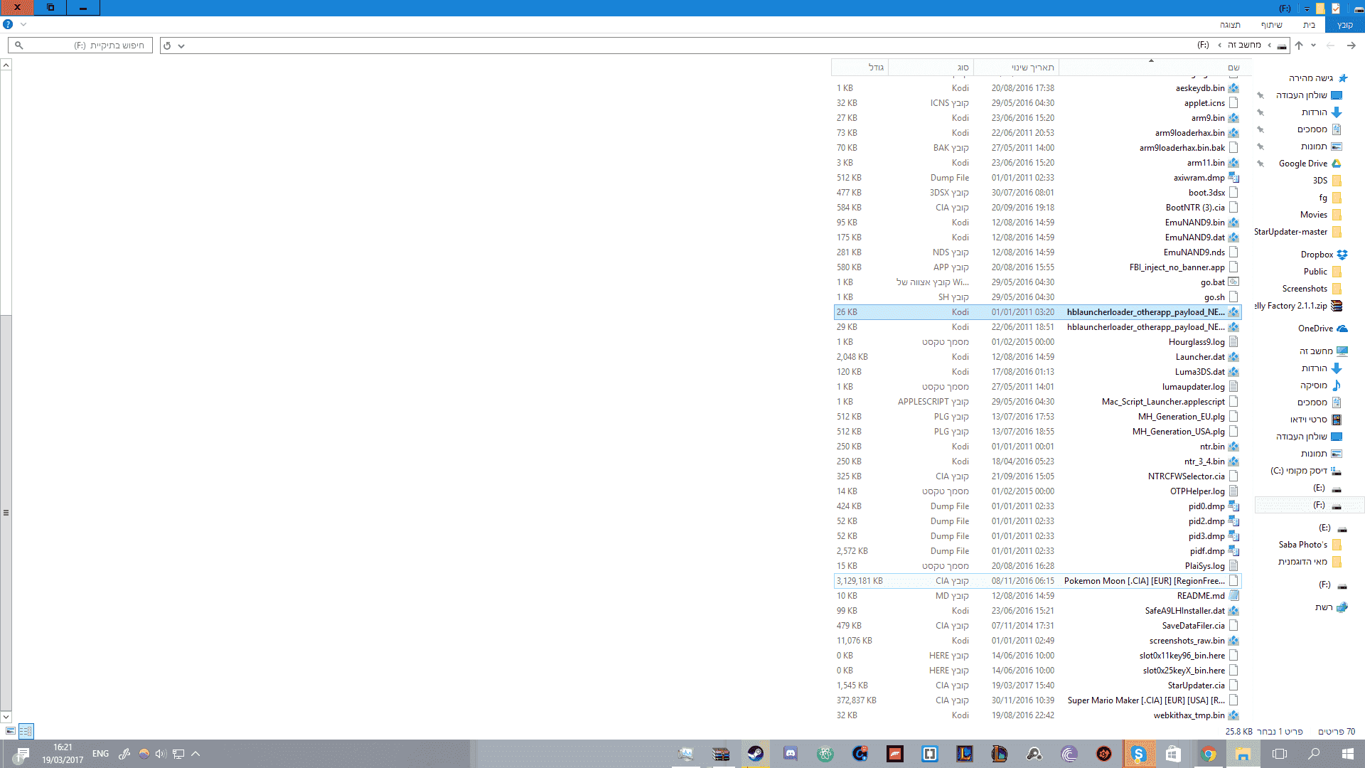

Homebrew Homebrew on the n3ds menu not working

Check it for errors with h2testw.
Sent from my iPhone using Tapatalk
Error writing file 'F:\1.h2w', offset 0x500000.
It is still possible to verify the test data written up to this point.
(The system cannot find the file specified. Code 2)
Warning: Only 34211 of 61479 MByte tested.
Writing speed: 9.64 MByte/s
H2testw v1.4
H2testw v1.4
Yeah, that sounds like a fake SD card.
