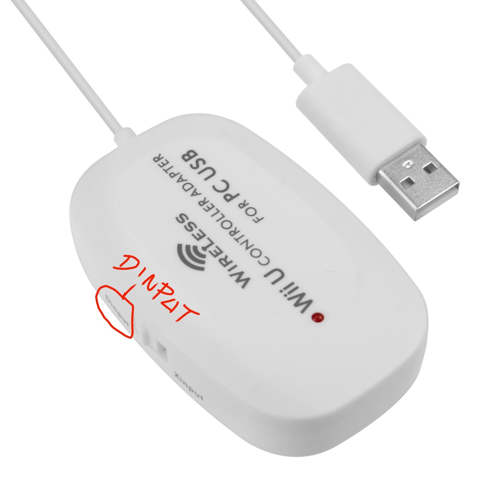

//Mayflash WiiU Pro Controller Adapter - W009
//Select DInput Mode
[vid=0x0079,pid=0x1844]

Is there an HID Test created specifically for the Wii U? I Googled and couldn't find one. Also, I put the .ini file for Mayflash WiiU Pro Controller Adapter - W009 on my SD card, but none of the buttons respond on my Pro Commander, even in DInput mode. I tried having other USB devices unplugged with no luck.
