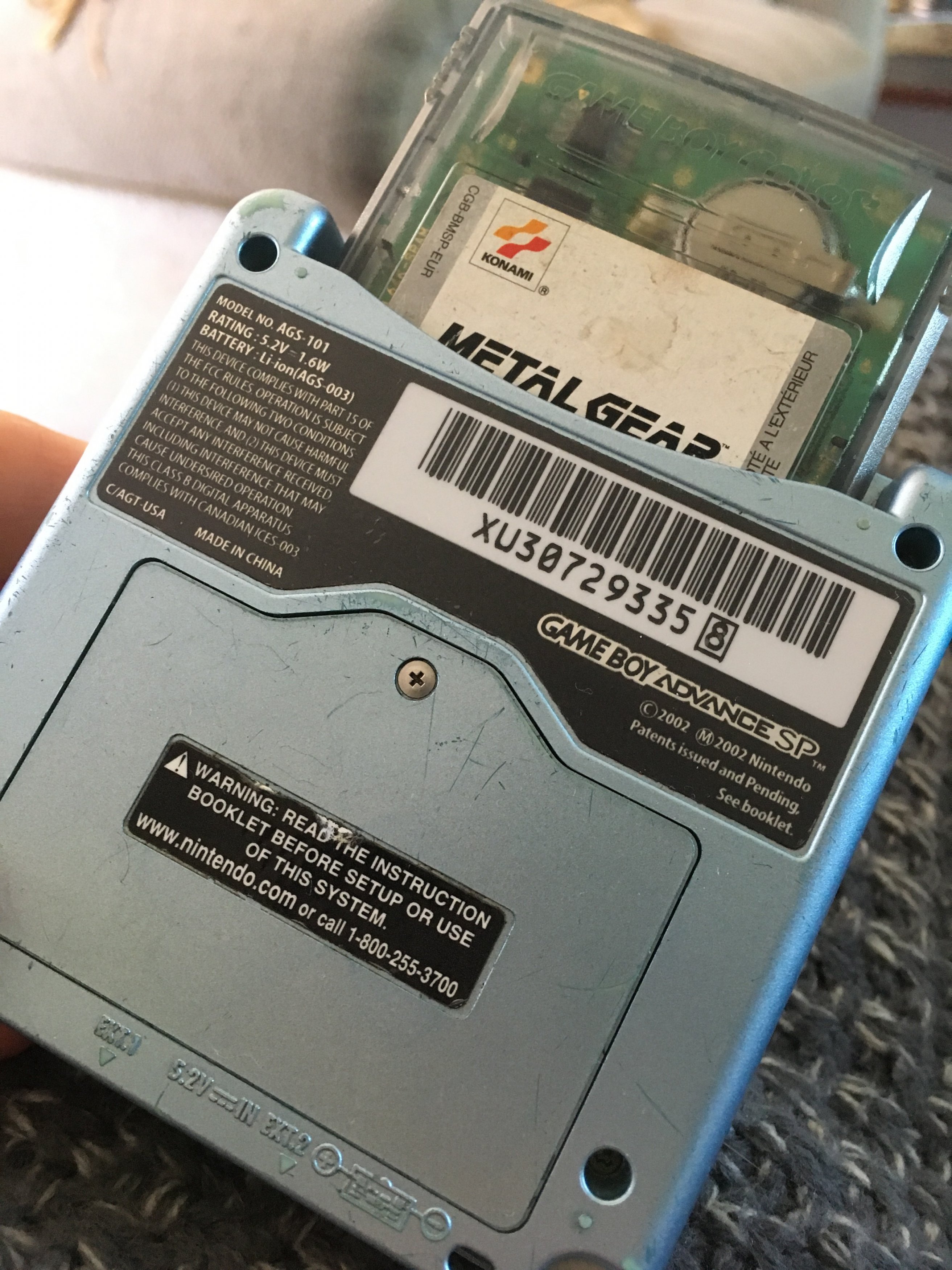

Hey guys,
I’ve got a few GBA SP consoles, looking to connect with people to hopefully help me with a wee problem with my ags-101. Thought I was good at fixing things but this issue has me stumped

It's not really clear what the problem is with your GBA SP, or even the point of that picture...:unsure:
