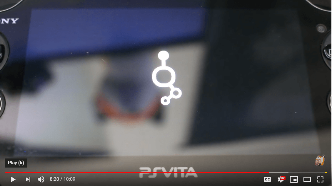

Well enso users have the enso logo when you boot the system up from being completely off, non permenant cfw doesn't if that help.
You would see the logo in the picture if you had enso at boot.
