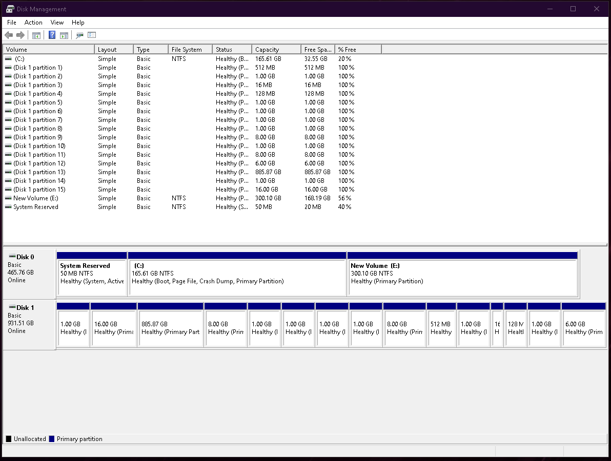

    After i re-initialize there is error.. "cannot acces system storage(su-30627-8). Damn i feel cold, so nervous...
    How about taking out the hdd from ps4. Then fix it with computer, windows.. will that help sir? You know every store are close here in my country because of lock down in my area..

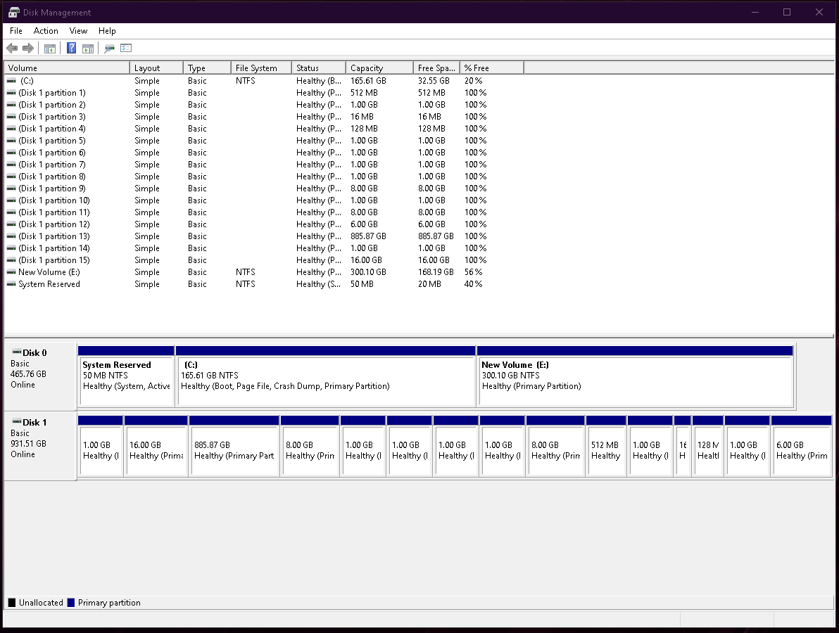

    i just did fix it using windows
    the hardisk is not dead. its corrupt.. what i did is delete all allocated partition that ps4 created.. that why its not booting properly.
    the Disk1 partittion1 upto partition15 that is my ps4 hardisk

    @ponching27 did it work.just curious. if you want to remove everything(all partitions) diskpart( cmd )is better

    Country:
    Yes it work..
