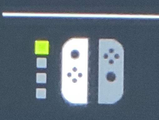

hey guys got a problem with my console/joycons and need a help. Something fcked up with my joycons today, when i start any game for examplei cant pass screen "Press L + R on the controller." - ofc im pressing those buttons but nothing happening.W hen i detach left and right joycons and press L+R then its working but when i connect back joycons to console then that fcking screen shows up again and L+R not working, pls help me ! i'm losing my senses ;///

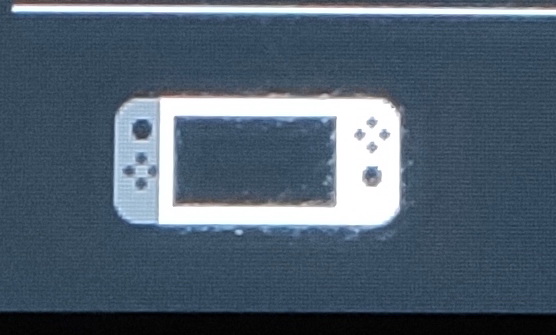

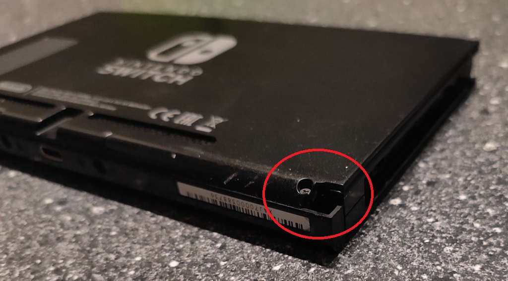

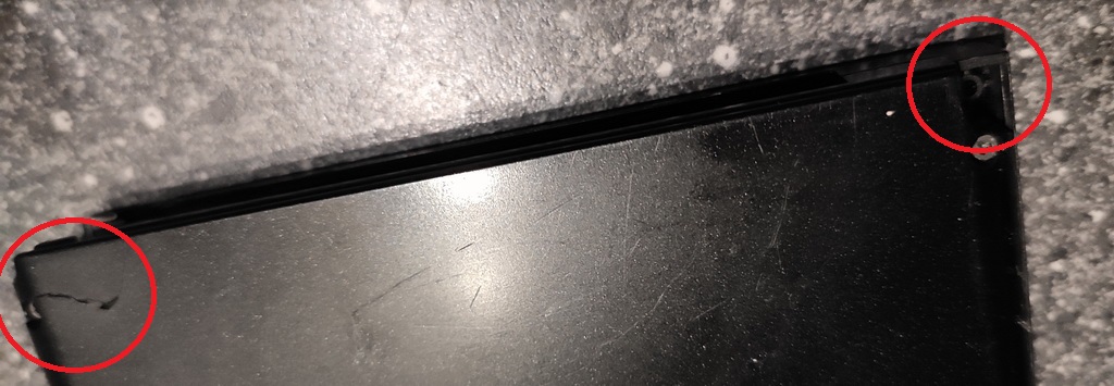

Damn, i just noticed my switch is damaged in 2 places near tablet rail xD but rail looks itself not broken,
so that the reason why left joycon cant be dedected by console at handheld mode. Well got 2 daughters one is 6 year old and second is 2 year old. Any chance to find somewhere left tablet rail replament and how hard it will
be to repair it by myself or mby better give it to some post-warranty repair service ?

Well if the rail is indeed the problem (in the image I can only see that the back cover has pieces broken off), you should be able to replace it fairly easily with the right screwdrivers :)
ifixit sells all kinds of replacement parts for the switch (joy con rail e.g.: https://www.ifixit.com/Store/Game-Console/Nintendo-Switch-Left-Joy-Con-Sensor-Rail/IF378-021?o=2, and they also have the back cover), but ebay can also be a good stop for spare parts.
The required screwdrivers are Phillips 00 and Y00.
