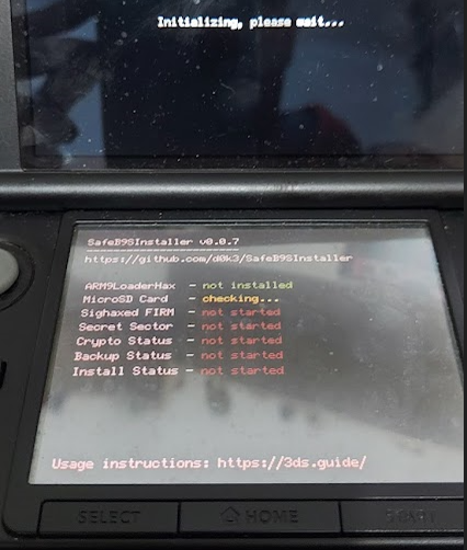

tried ntr boot with a r4 and magnet, and its stuck on the safebsinstaller

Yep, I see it; you're in safeb9sinstaller.
You got in there with a NTRboot cart, right? What does the contents of the cart's SD card look like? (Maybe you could try replacing the FIRM on it with something other than safeb9sinstaller or somethin'..)

Yes, i flashed my r4 sdhc dual core (2016) using my another working 3ds, everything went well.
For the bricked 3ds, i put the safeb9 on the root of sd card and a folder named boot9strap (with the fw inside)
Booted with a magnet on the right side of the console, holding start,select,x + power
Already tried the same with luma on root of sd, its enter on luma menu (only show nand was marked), but after press start its the same again (both screen are on, but nothing happens)
