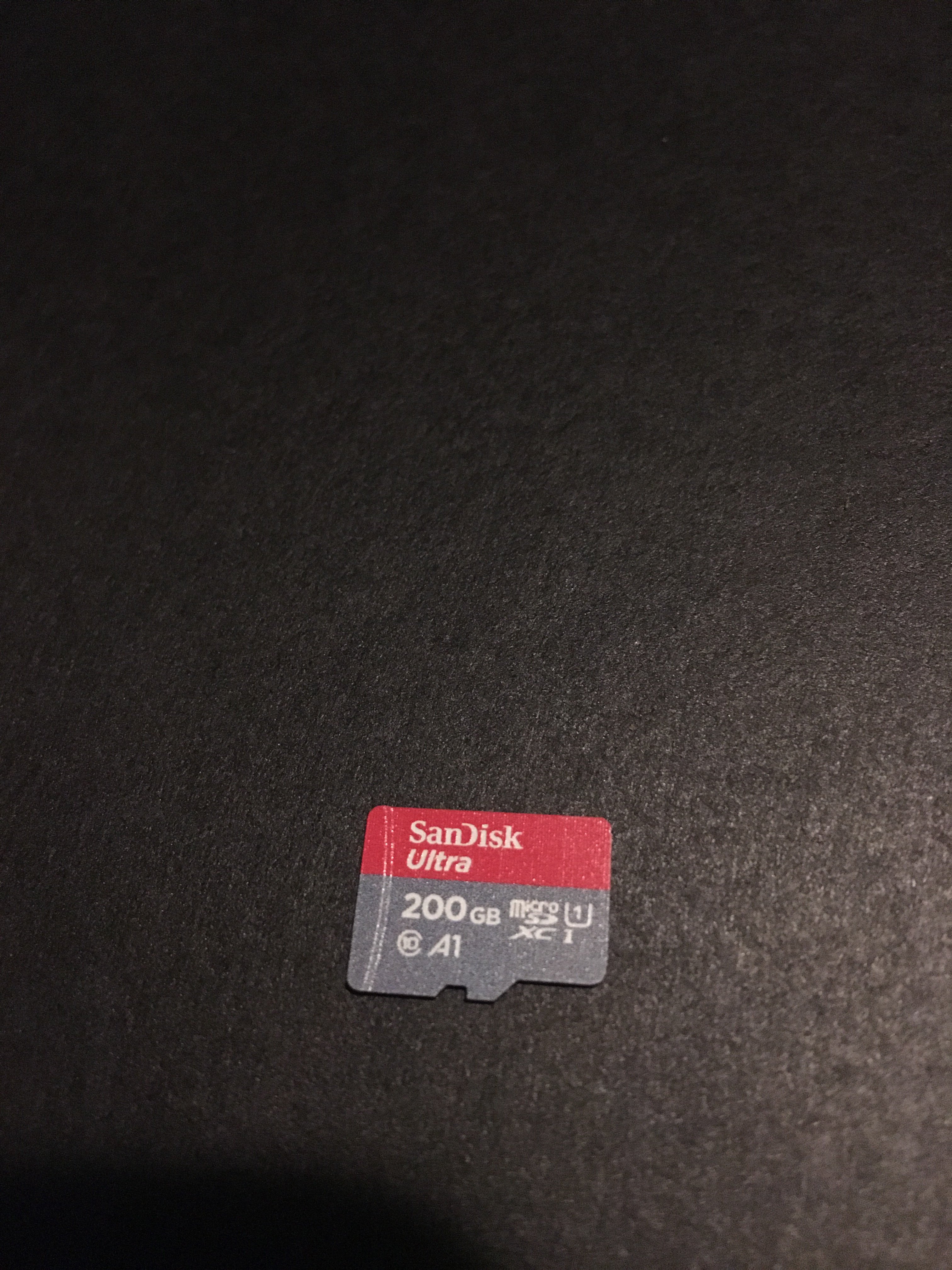

That was it everyone. SD card was dead. Bought a new one and it’s fine. First time I’ve ever had a brand name one die on me.
Pic was the the one that died. Avoid maybe?
Thanks for the suggestions.
