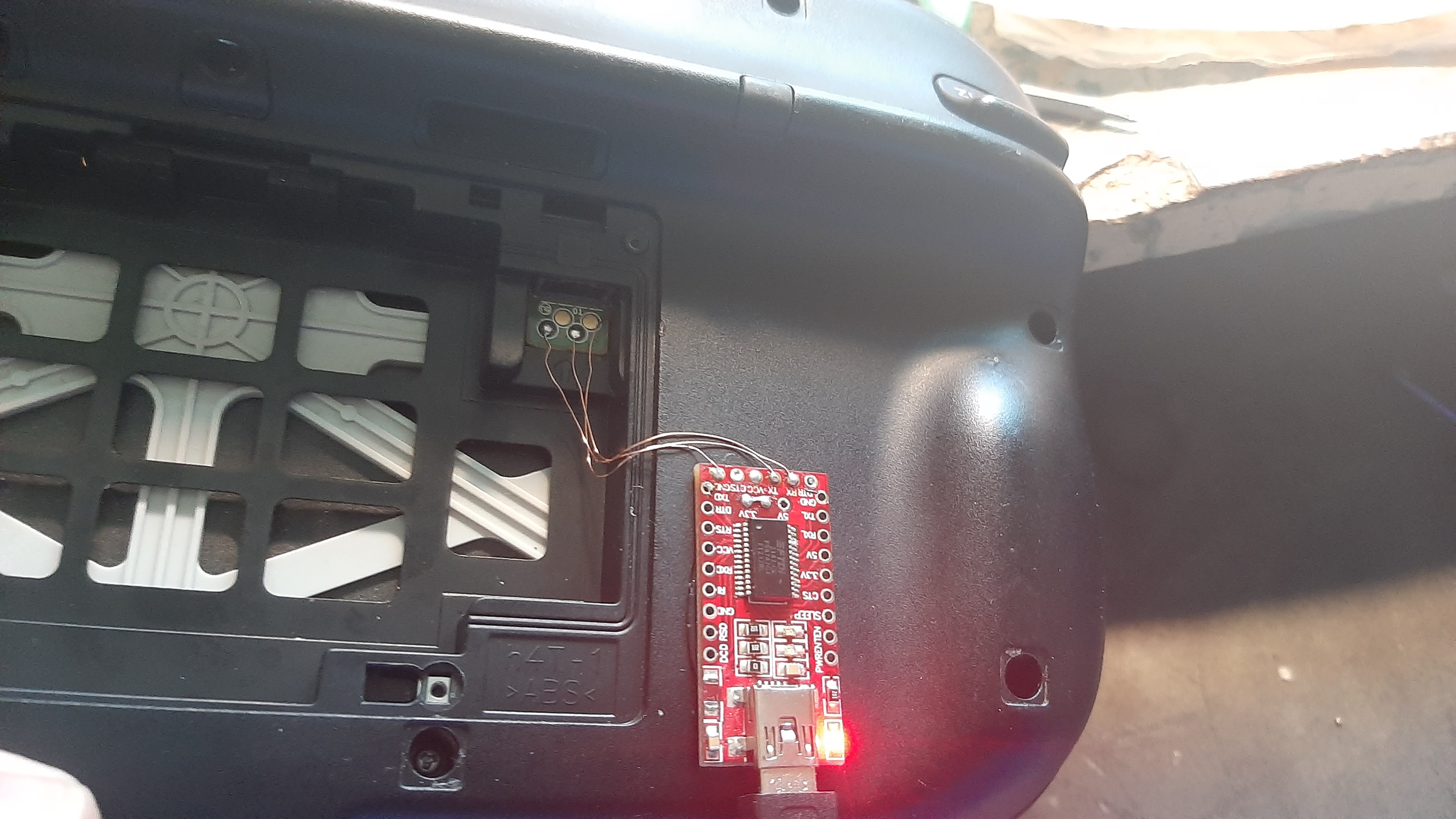

A while ago, Lazr drew my attention to these pads on the motherboard:
They are under the battery connector. They're exposed when you take off the battery cover.
Anyway, while looking at the gamepad's I/O registers, I found out that there are 3 distinct UARTs. UART2 is the one that is used for IR comm, while the service firmware uses UART1 as a debug output (and apparently also accepts input over it).
This got me thinking, and I did some testing and probing, and... turns out those pads are UART1!
So far, the pinout is as follows:
1 = RX
2 = ???
3 = TX
4 = Vcc (2.8V)
So this could serve as a handy debug output. I'd yet have to reverse-engineer the UART hardware properly, but the RX and TX pins can also be controlled directly with the GPIO registers (0xF00050D8 and 0xF00050D4, respectively).

I got the debug console working on one of my Gamepads as well. I had a USB UART converter around from 2022ish, so thought "why not?"
The hardware stuff is super easy. 3 wires.

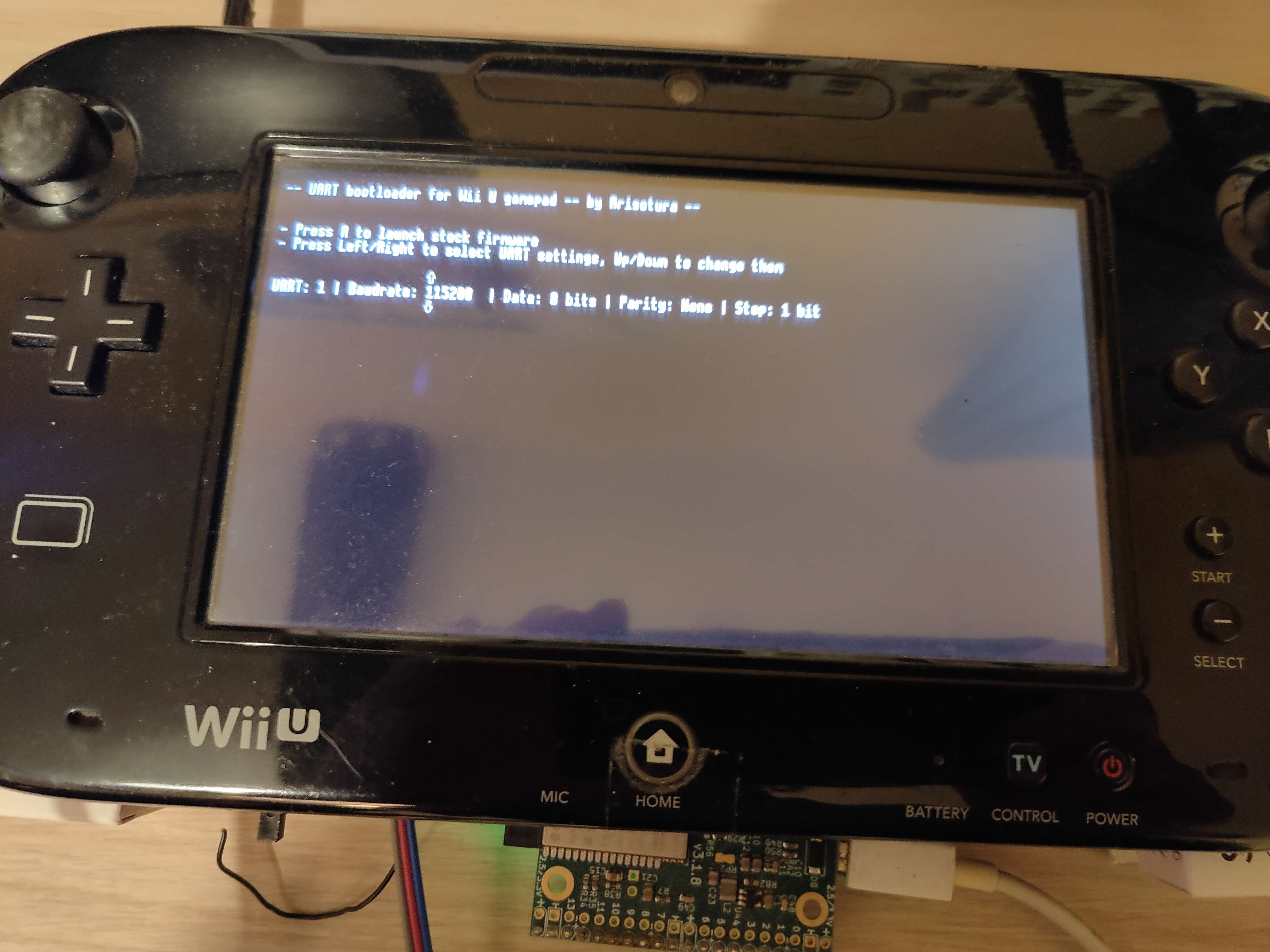

I received my USB UART thingy, so...
Putting together a quick UART bootloader. I intend to provide it for people who want to code for the gamepad and aren't afraid to do a bit of hardmodding.
One would have to manually program this bootloader into their gamepad's Flash memory. As far as UART is concerned, I added a selector. UART1 is the debug serial port we discussed above, so you'd need to solder wires to that. UART2 is the IR port. In theory it should be straightforward to support it, but I can't test it. But if it works, it has the advantage that no soldering is required.
