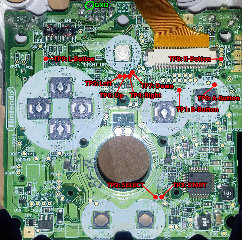

Gameboy Advance SP. Right trigger is not working. Tried IPA and then eventually soldered a new one. It worked for awhile then sporadically works and then stops. Is there a way to check with a multi meter? Could the button be faulty or a MB issue while replacing
I saw a post of someone running a jumper wire from the CPU to Test point to get it working
182564573_10157873726341161_7095260410164805957_n.jpeg 182329635_10157873726281161_1160097090316631281_n.jpeg gbasp_button_pads.jpeg https://gbatemp.net/threads/problem-with-gba-sp-motherboards.538228/

Sorry to bring this old post, but I'm facing a similar issue I guess.
I replaced the trigger for a new one and still is not working :c
Could you tell me what you did? or if you have any advise to solve it?
