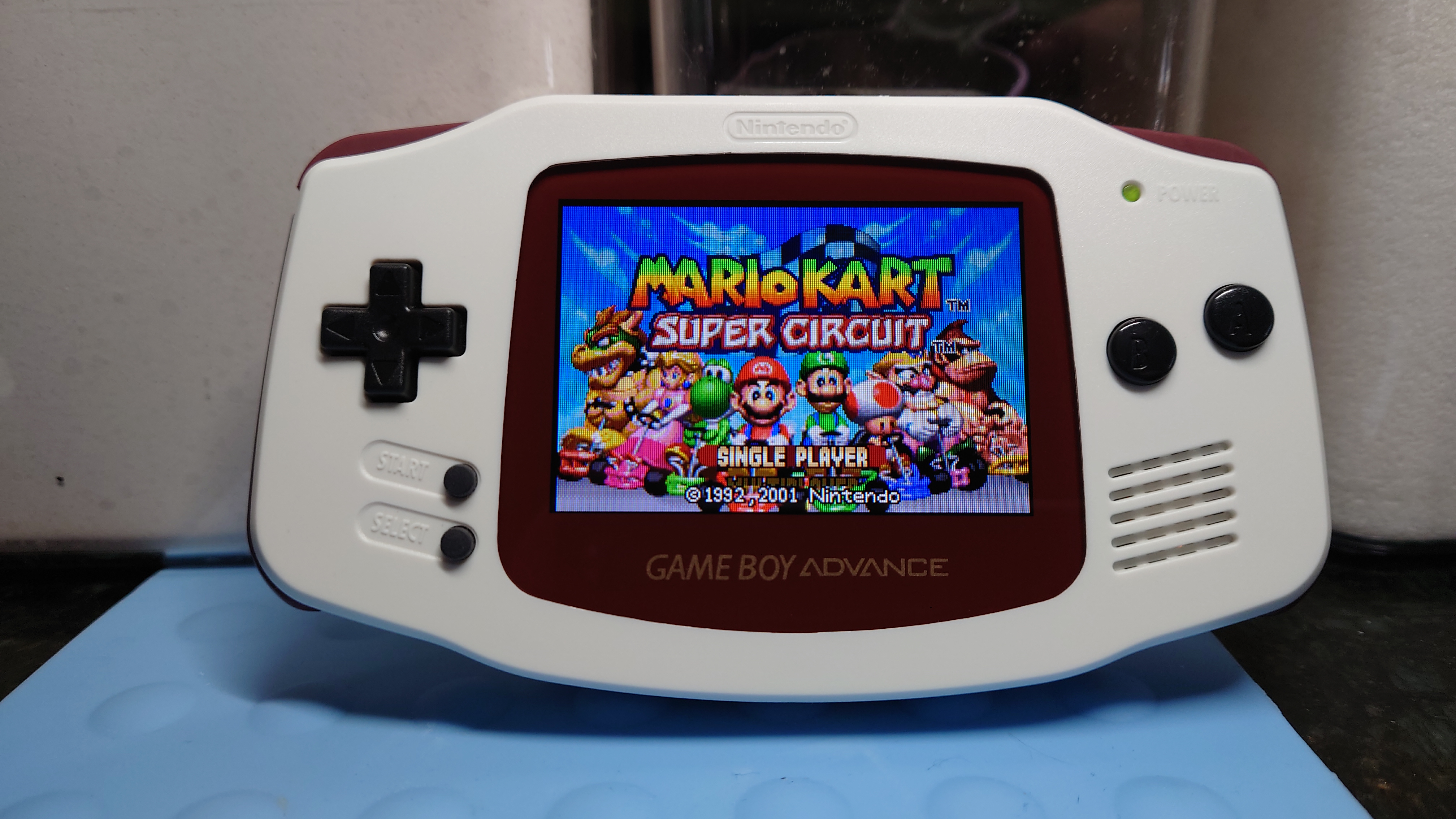

I was obsessed with the idea of a consolized GBA, several years ago. Then I cooled down. I have a Gameboy Player on my 'Cube, and use the GBI iso's to run it. And it looks good. I also have a controller adapter -- can't remember where I got it right now but it's good stuff -- to use an SNES controller on Gamecube (primarily for GBA of course). It's a great setup. And I never use it.
What I DO use though, a lot, is a custom GBA that I made from a GBA refurb and parts from funnyplaying. Laminated ITA screen kit, new shell that fits that kit, and custom color buttons. I would rather look at this screen while playing GBA, than a TV.

Nothing will beat a classic GBA with backlit screen, and yours is gorgeous! That pixel-dense vibe is what i love the most about the console 😃👍🏻
