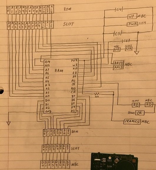

I have decided to take this into my own hands. I sat down with my trusty multimeter and this is what I have come up with so far for the RAM chip.
The C4, C5, and C6 refer to capacitors on the circuit board.
Maybe there will be more to follow.
I am replacing the volatile SRAM chips in my gameboy cartridges with non-volatile FRAM chips. I want to use FRAM so I can do away with the coin cell battery. The only issue is that I need a pull-up resistor attached between the voltage pin and the chip-enable pin of the FRAM chip to accommodate the way FRAM does address latching. I wasn't satisfied with soldering in an axial resistor because the end result looked kind of ugly compared to what a surface mount resistor would look like.
The chip I am using is the FM18W08. Details about using the pull-up resistor are in the datasheet.

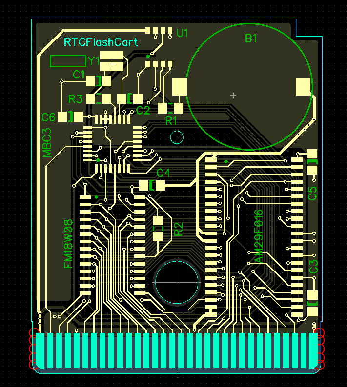

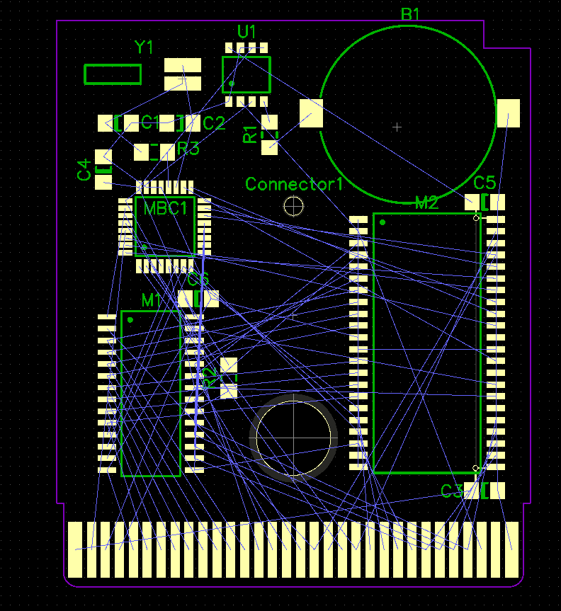

Made a fair bit of progress. Created my schematic in DipTrace and converted it to the following PCB file. All that's left to do is route and manufacture (hopefully). This PCB has been modified to use an AMD flash chip so it can be reprogrammed as any gameboy title that is less than 2 MB in size. Also, the battery contacts have been adjusted to allow a battery holder to be installed. Finally, a resistor has been added so that F-RAM (non-volatile RAM) can be used.

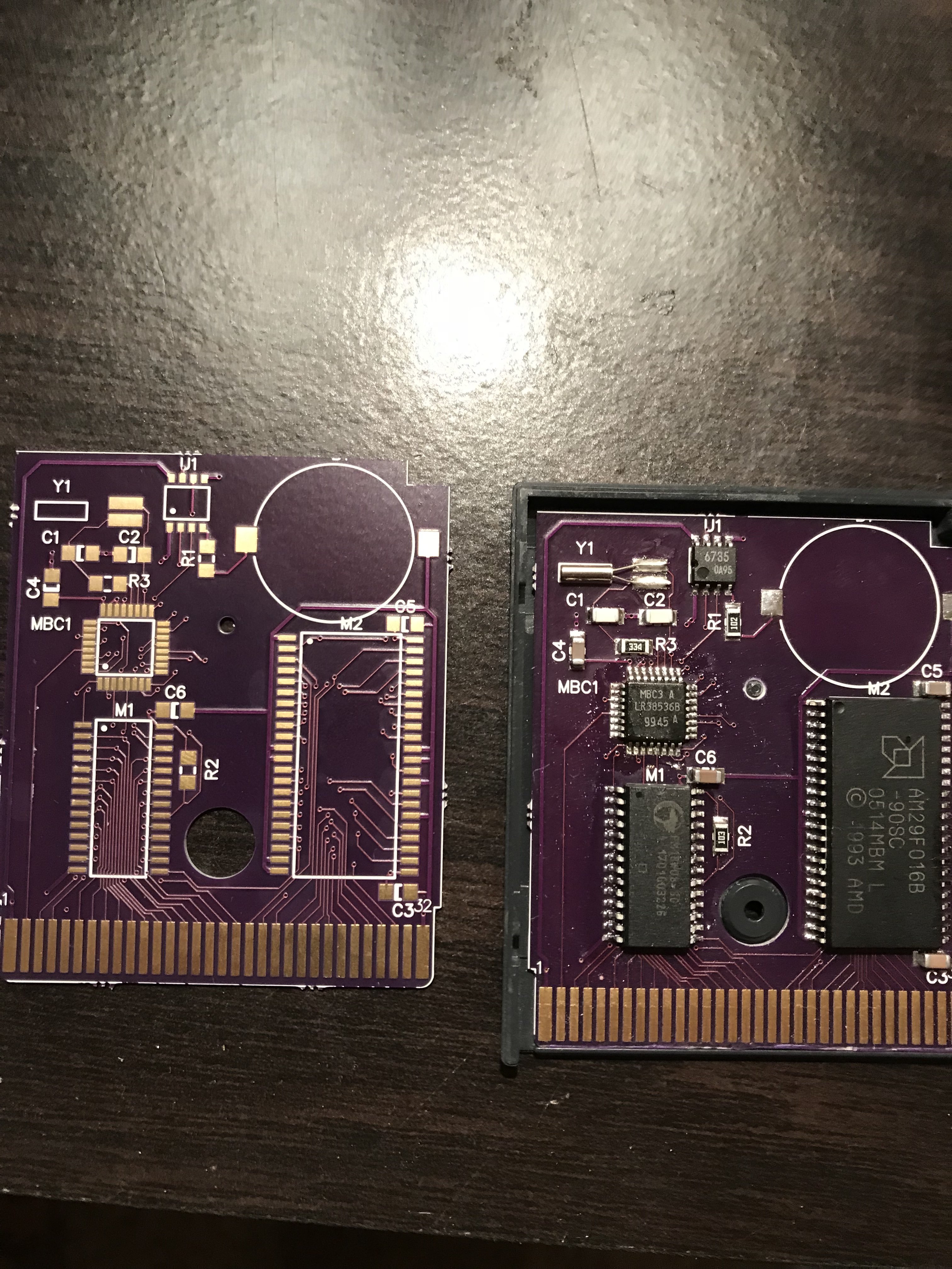

Cartridge is finished. It works! I still have some minor adjustments I want to make to this design before I’m done, but this is a big win today. I will be releasing my board design to the public so anyone can order this board for themselves! Thanks for watching!

looks awesome! it's funny how when i hear about a bootleg, i usually refuse the idea, because i do love stock as possible.
but this "bootleg" which is an upgrade to the original, seems something i am looking for..
is this compatible with the pokemon stadium\n64 transfer pack games? do you accept orders directly?

Unfortunately, I don't have the resources right now to supply these cartridges. Once I move into a house from this apartment (shouldn't be too long), maybe I can sell a few. I will post on here if I do.
I haven't been able to test with Pokemon Stadium yet, but the graphical glitches are fixed, so I would assume the Stadium issue is fixed as well, since they were caused by the same problem.

btw, i noticed you swaped the rom chip?
does this means, we can't use a donor cartridge to use it's mcb+rom in this pcb?

Correct, this is actually a re-programmable chip instead of a ROM chip. It can be programmed to be any game that is 2 MB or less in size. Taking this design and making it use original ROM chips would be an easy step, though. The design would be a good deal simpler.

Don't quote me on it, but it should work just fine. I'm sure he could give you a definite answer. Just tell him it's an AM29F016 Flash chip. If it can write other flash carts, then I imagine mine should be no problem.
EDIT:
I forgot to tell you that you can use an MBC from a donor cartridge, just not the original ROM chip. (In fact, a donor cartridge is the only way to get the MBC without making a custom one).

Once I get all the flaws hammered out, I would really like to make a proper blog so anyone can do this for themselves, or use the board files I plan to post there. My last task is to squeeze a battery holder onto this board somewhere (the battery is still required to power the clock), but after that I hope to publish all the details.
I would recommend a mod to the battery type that is being used on the PCB you have laid out. Instead of a tabbed battery requirement, a battery holder/retention clip to accommodate normal batteries would be better.
source link here
Other clips or holders if the above doesn't work for you.
This would reduce the maintenance cost for the user and a whole lot cheaper and easier to find a normal button cell. Reason being that not everyone that wants a flashcart can solder a new battery.

That is an excellent suggestion, and is actually what I have planned to do. I have ordered 3 different kinds and am deciding which one I like best. I am one of those people that does not enjoy firing up my soldering iron just to replace one simple battery.
