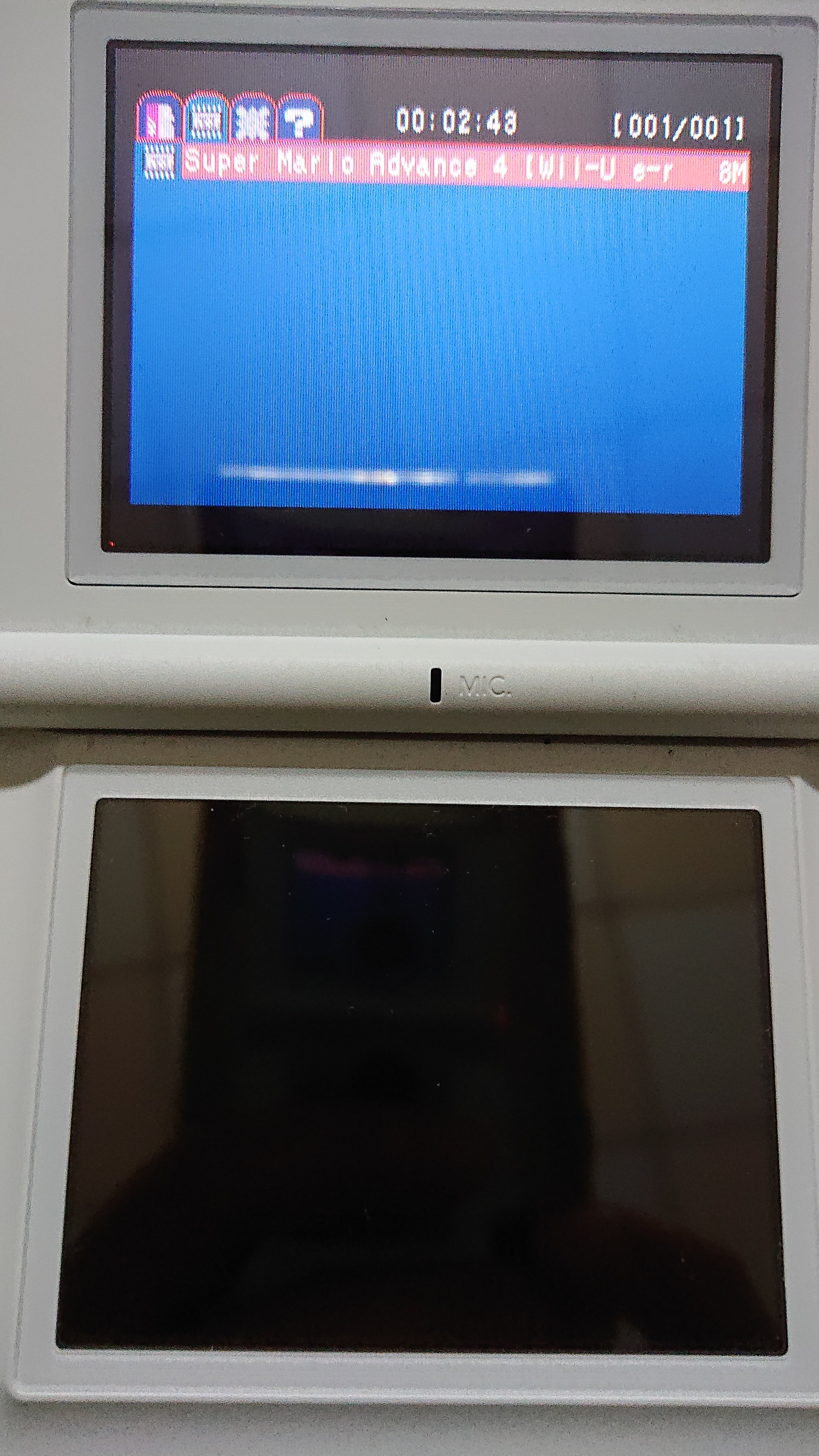

Hello. My ez flash omega play well before. Now it shows as picture and won't boot any game. How can i fix it?

Borked Nintendo logo usually means dirty pins or pins not making proper contact. Clean them, or maybe put a folded bit of paper between the case and PCB to force better contact. Do also check the pins inside the GBA slot to make sure none are bent or too dusty.

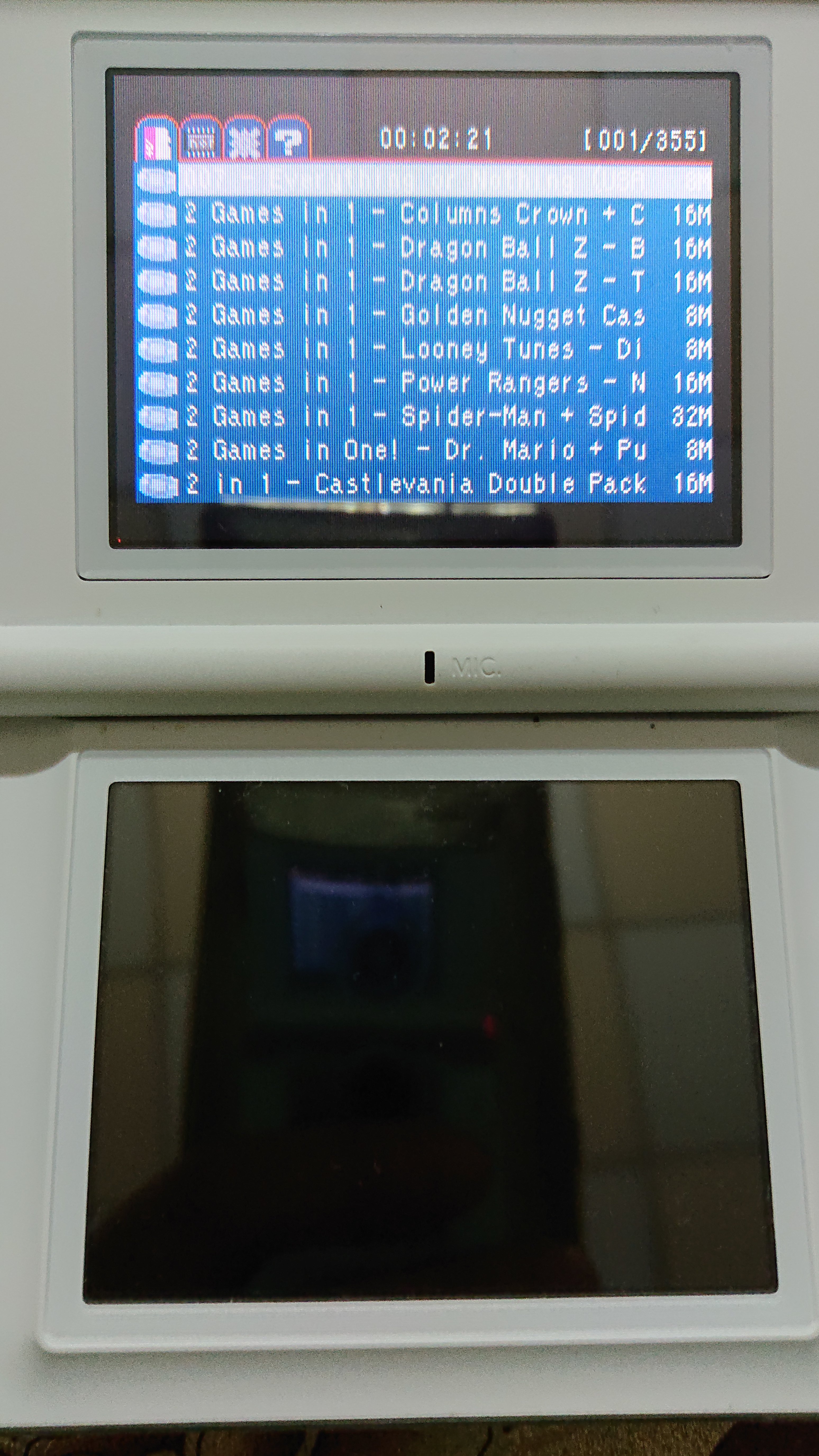

I try boot ez flash omega without sd card, it ok. So i clean sd card slot of ez flash omega, it doesn't lucky, still show bork Nintendo logo. I can boot to main menu, write gba game to norflash and play well.

I have solved my problem. Ez flash omega case and gba slot do not match, do not insert the card too close to the gba slot. sorry for my bad english, i use google translate.
