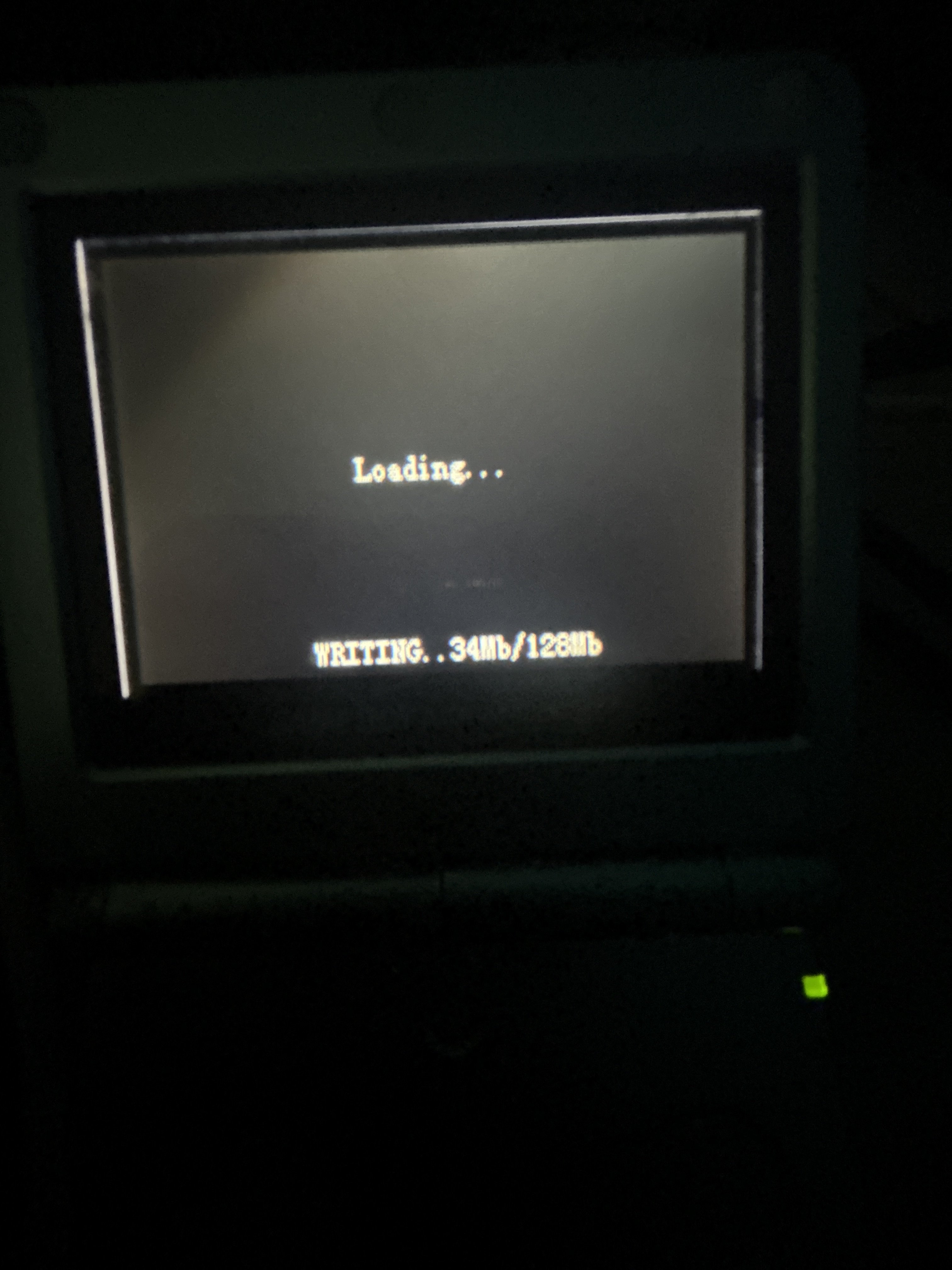

My EZ Flash DE arrived today and I tried using the option to transfer Pokémon to the DS, but whenever I try to write a game to the memory, it always stops halfway through the process. I searched all over the internet and forums, but I think it's a chronic issue. These are my last efforts to try to find a solution
try write a smaller game,16mb or 32mb
then click the game name, choose format option from the pop up menu
I have already tried this and encounter the same issue. I'm able to download a smaller title like advance wars, but I am unable to download a game like Pokémon Emerald.
Did you perform the format action?
Yes I have.
Yes I have.
I have solved the issue. It appears to be an issue with the latest firmware. I've downgraded to version 1.09 and am now able to download files larger than 36 Mb to my NOR Flash. I would suggest looking into this issue.
