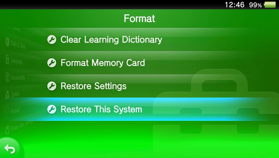

okay I'm going to try that and update you on how it goes. I just wanted to also add that this was the screen that pops up every time I turn on my vita. When I choose to format, it then tells me that I can't format. But again, I'm going to try what you said and I'll let you know how it goes.

Okay so I did the system restore and the error message (C4-10278-8) still shows up when I try to format the memory card. I honestly don't know what else to do. Does this mean I need to get a new memory card?
@BlasterBlaster ,from the error it would seem that the sd card is dead,you should change it with a new one.

@BlasterBlaster ,if the PS Vita turns on and you manage to go into Safe Mode(hold power for 30 seconds),it is not bricked you have just messed up the memories and now you need new ones to restore it since you have a PS Vita Fat (1000).
