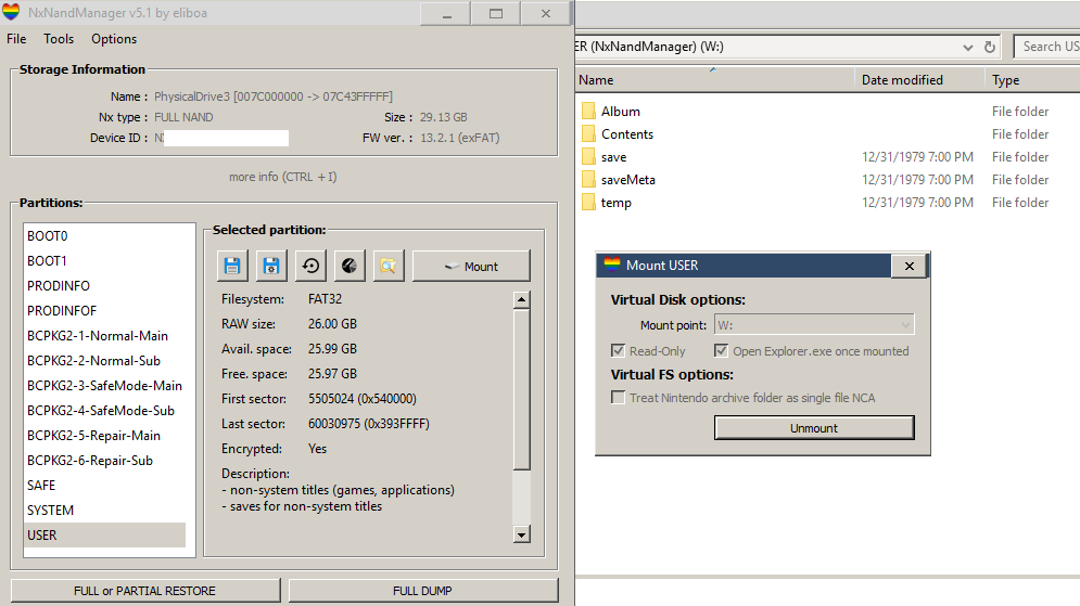

ok so im in the nxnandmanager and i opened the raw partition thats 26 gb.. but the "mount" button is greyed out :) is there something i missed by any chance.
edit.. i went to configure keyset where im assuming i add the dumped keyset.. and it crashes the program lmao
what a day i tell ya
edit #2
switch to 2 dif pc's both running win10 64 all crash after cliking import keys
edit # 3 tryed an earlier version same issue.. configure keyset.. import.. crash immediately :(
