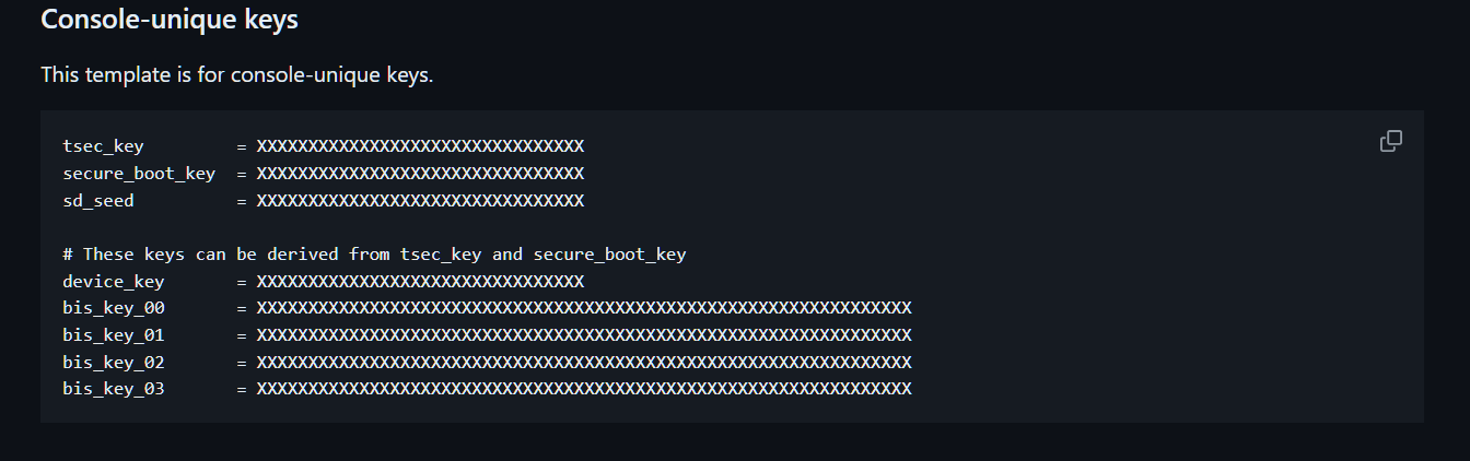

You need these keys the most. They're the unique once.
Withouth the BISKeys, you won't even be able to decrypt your saves. Since you got Hekate working, it possible you might have gotten that data out.
i have the bis_key_00 -03 device_key_x4
the other one i dont have. can i make with these keys a new ofw switch? or have i missing keys for that?

You need more than just BISKeys sadly. You basically need the PRODINFO data, which is on your old eMMC. This data can't be rebuilt as far as I know.
Thank you, than i will hope i can read the old emmc with another adapter. :D
