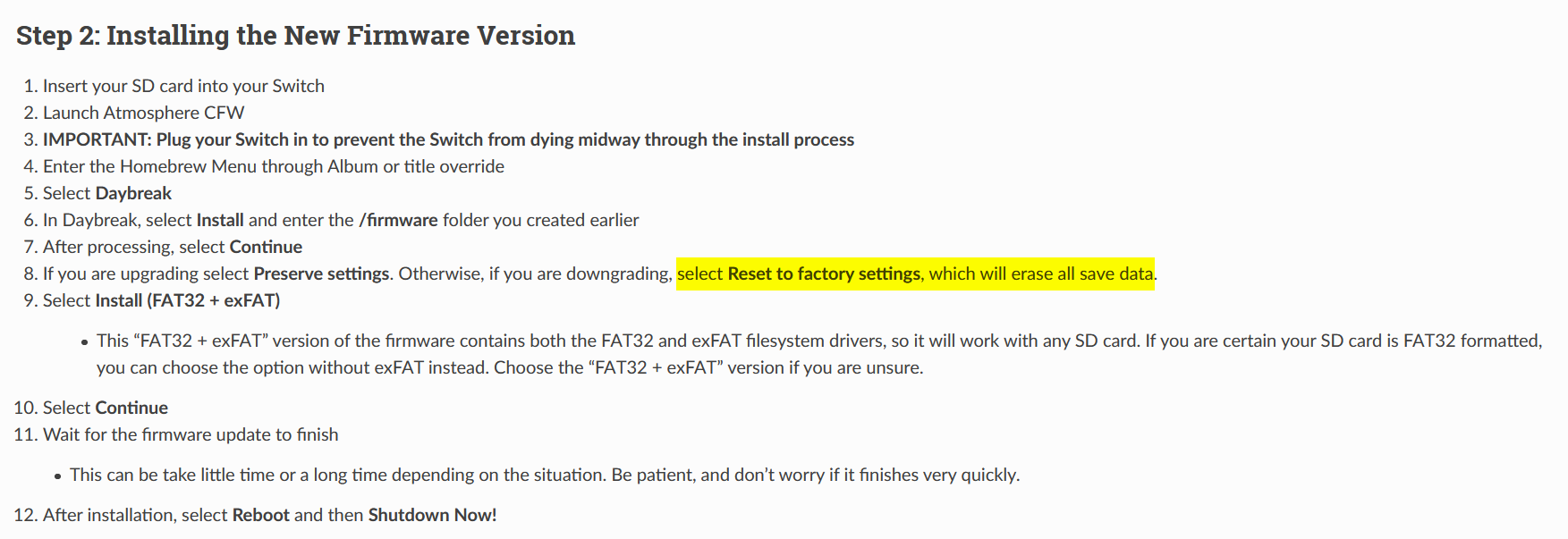

Upon reading the guide to downgrade to 11.0, I noticed the highlighted step in the process:
My questions are:
Is this guide meant to downgrade the CFW? if so...
Do I have to reset to factory settings? if so...
Does this affect my save data in smash or fighter pass characters?

The factory reset when downgraded is needed, because some system settings will break between version, since nintendo never intendet you to downgrade.
