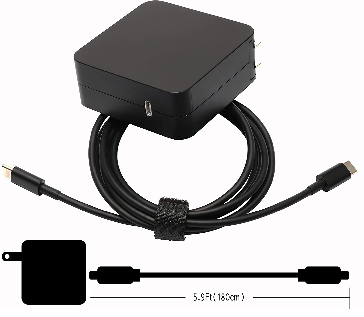

For me, I do use a 65Watts USB-C Power Adapter, cost 15 USD on amazon, I can use for my phone, laptop and the switch and works fine, using a USB tester shows me the Switch dawning 15 V 2.5 Amp.
About the Wii U power bank, CAN NOT BE used to charge the switch, unless you make an adapter which simulate a USB PD protocol because if you feed 15 volts at the first connection attemp the USB Chip inside Switch will be fryed . is mandatory to first connect 5 volts and negotiate the voltage and current, then the circuitry redirects the input to the correct voltage handle.
you really do not need a original power bank but you need a PD protocol compatible one. any greater to 40 Watt will do the trick, they are cheaper now. This is mine:

Because the wii u power supply ain't usb-c pd standard, you slapping a usb-c port ain't going to solve your problem. You can charge it fine with a usb-c pd charger when not docked.
Thankyou, a straight answer with an explanation!
